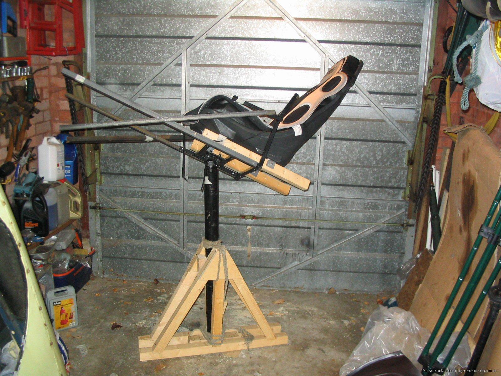

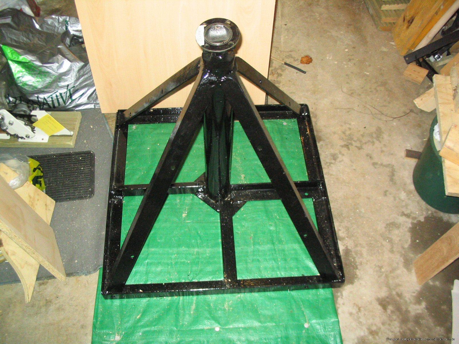

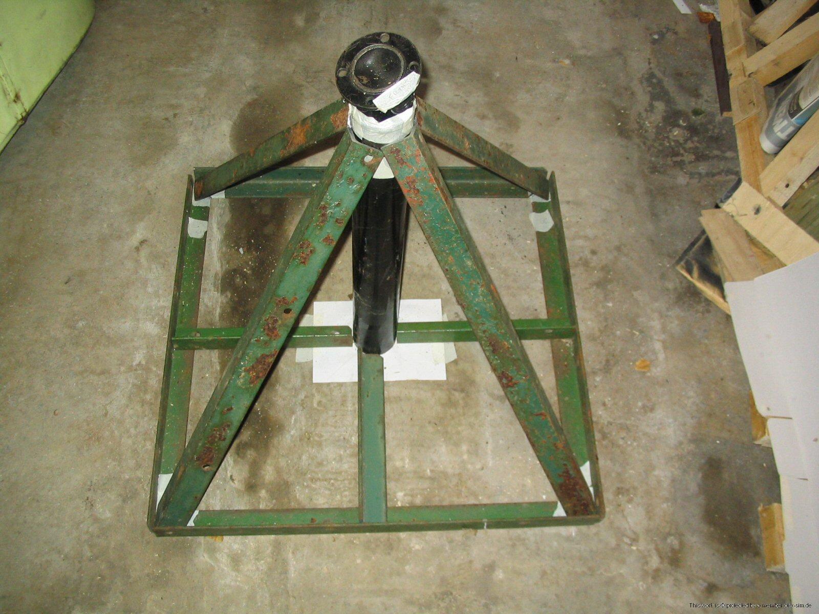

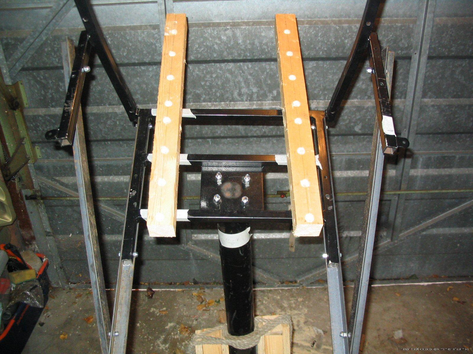

I welded a car propshaft to a pyramid made from lengths of angle iron. The frame from an old office chair was bolted to the propshaft universal joint. Everything else was bolted to the office chair frame.

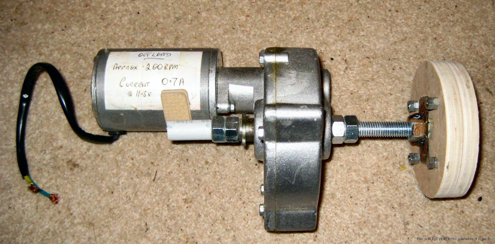

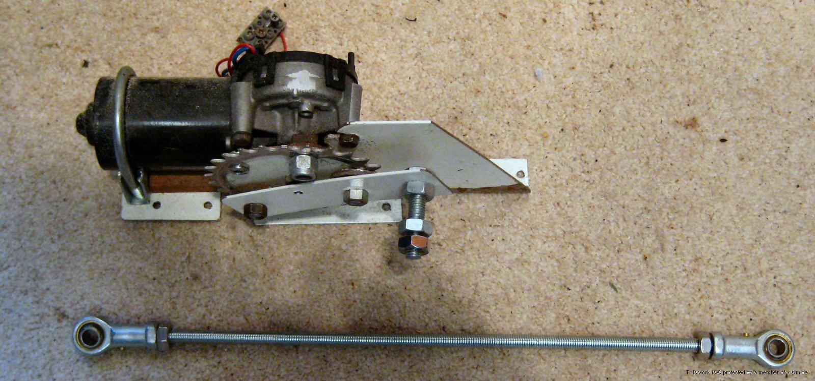

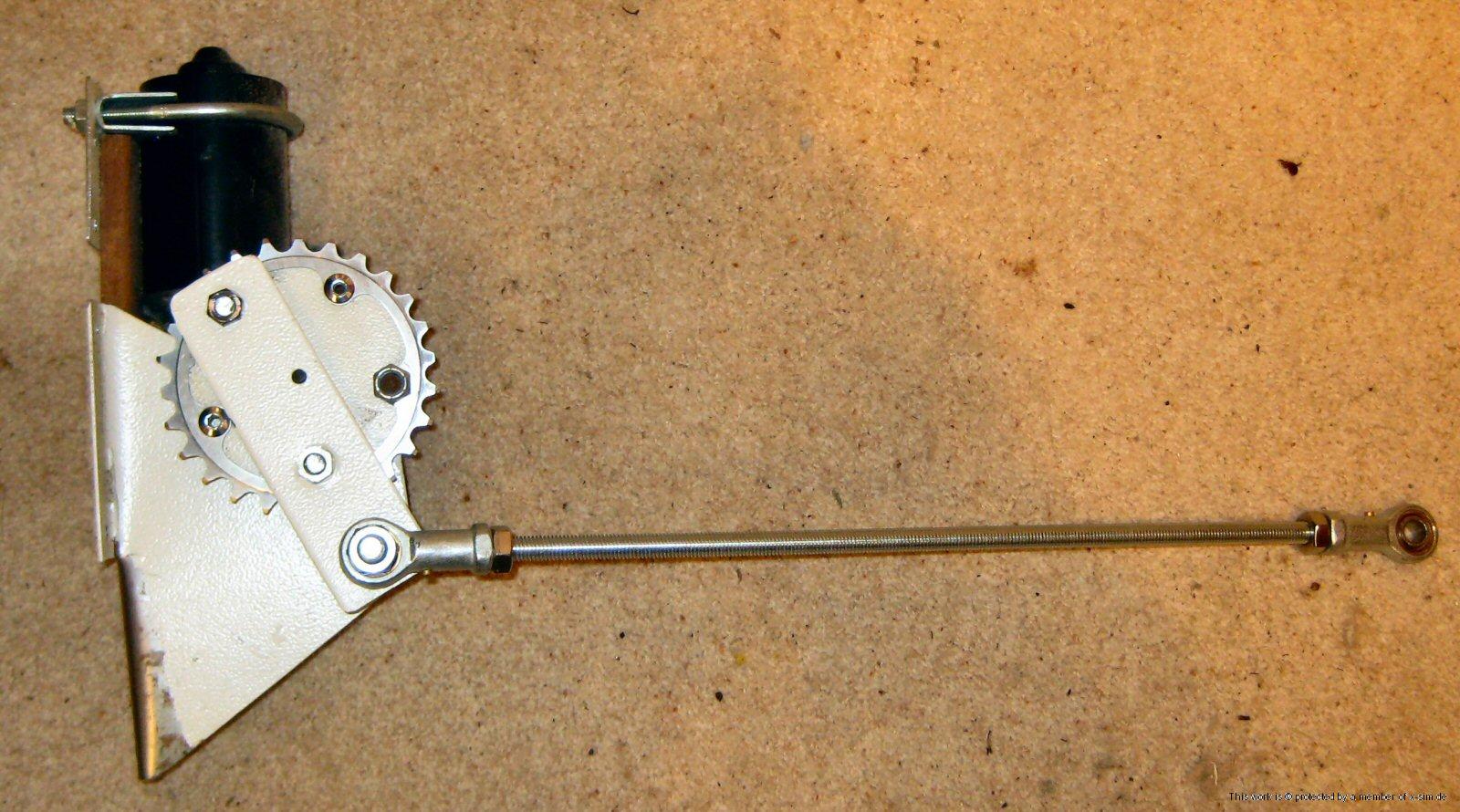

I did attach two windscreen wiper motors via lengths of threaded stud and knuckle joints to test the response. The frame (although balanced when occupied) was too heavy and required a lot of bungee ropes to provide a zeroing force which of course made things harder for the motors.

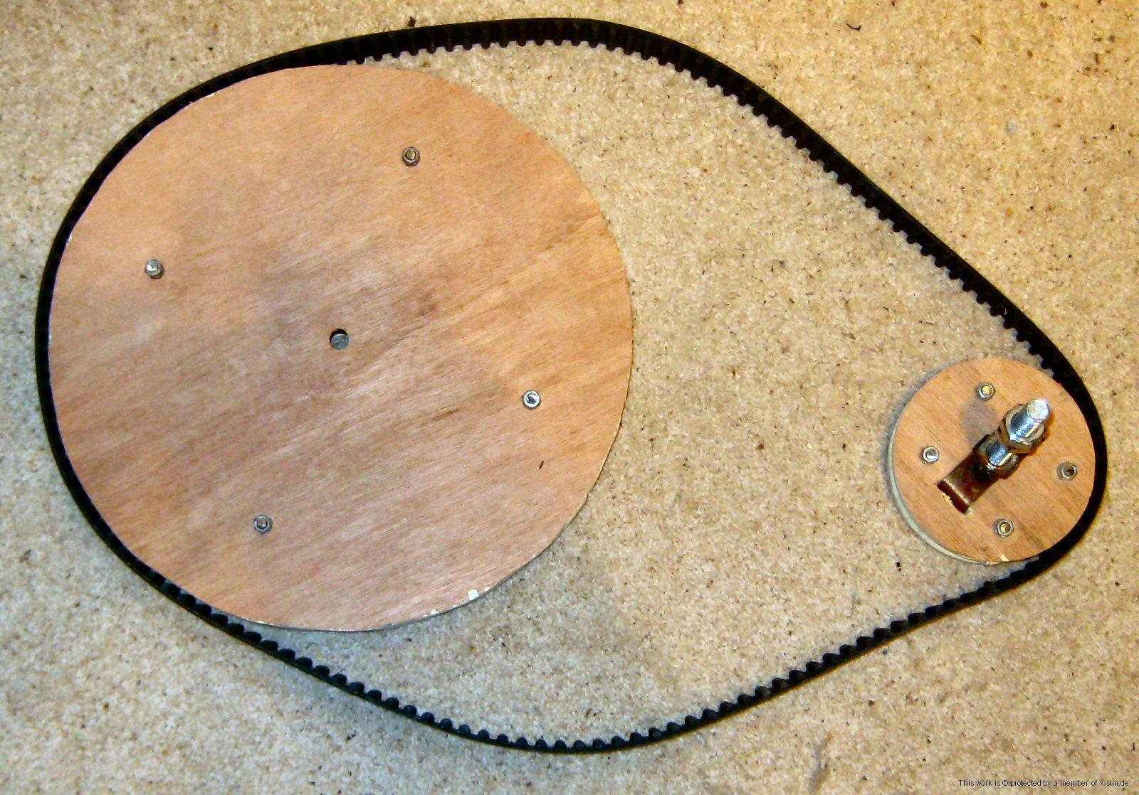

I toyed with the idea of using golf trolley motors and pulleys attached by automotive cambelts but started to lose enthusiasm when it finally dawned on me that I had no idea how to link the motors to Microsoft FSX.

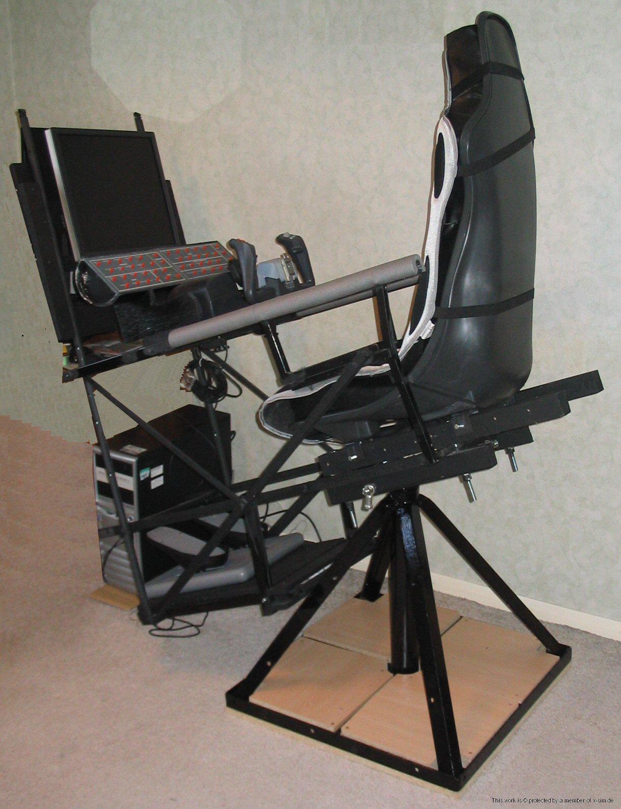

I’m now aiming to build something lilke Bergison’s G-Seat for which I assume wiper motors will be adequate although I may still try the golf trolley motors for the seat base panels.
