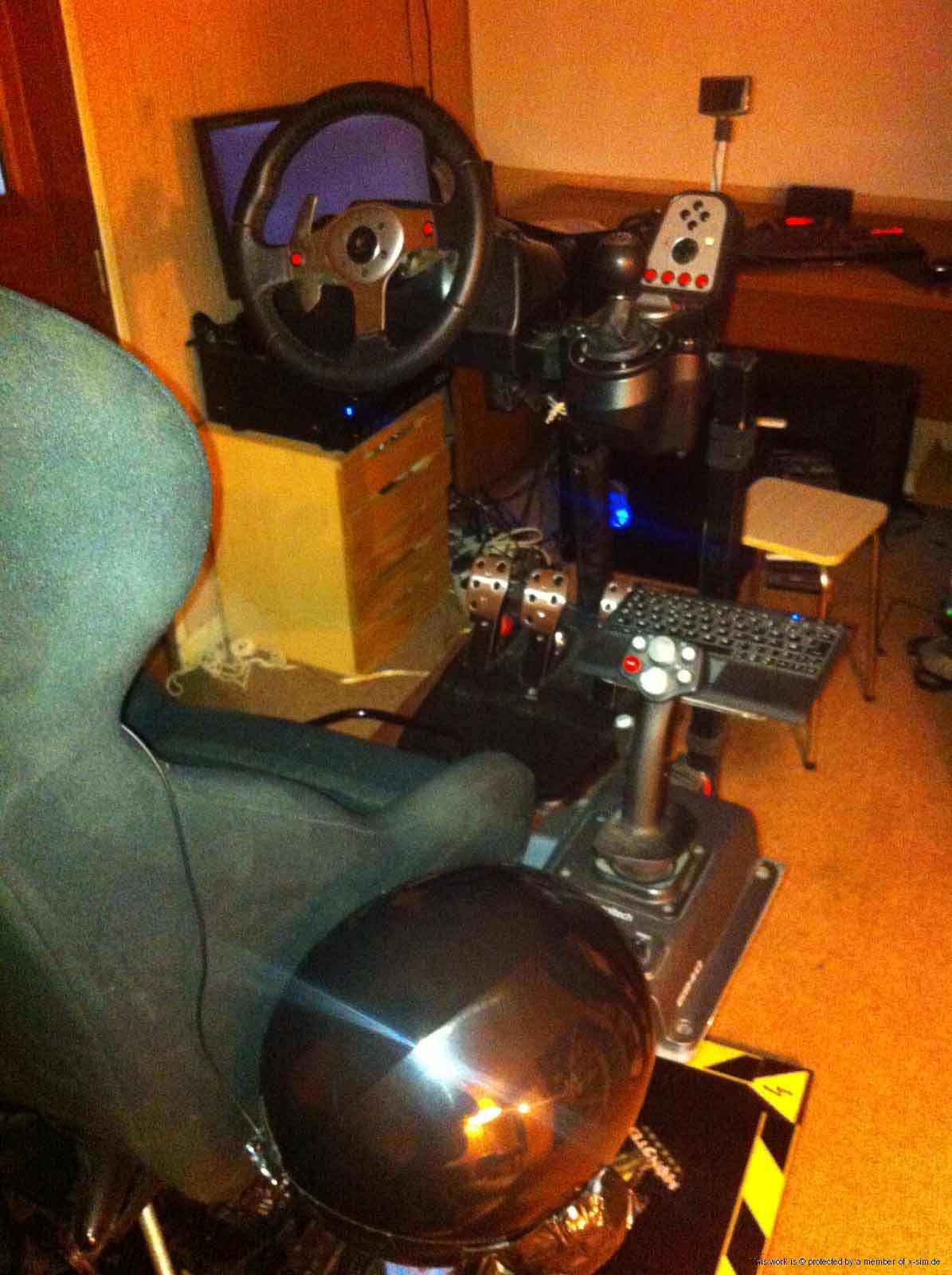

    So, I’ve bought this simulator 2 years ago from PASCOUL from Racing.fr.
    (sorry for my english, I’m just French…)
    You can see a french demonstration here :
    http://www.youtube.com/watch?v=oijmgYkW ... ure=relmfu
    - 2 motors 550w 2x220V each with 2 reductors 23/1
    - 2 OMRON variable frequency drive
    - A Velleman VM110 USB card
    I did some changes ont it:
    - Logitech G25 Wheel with load-cell on brake pedal, home made pedal extensions, and harder springs,
    - Lateral carriers for Logitech G940 flight system
    - Using PPJoy and GlovePie to change G25 pedals to rudder pedals for plane simulators
    - Track IR system in a skateboard helmet for head tracking
    And now, it looks like this :
    My next (dreamed) jobs are :
    - Build of a central long loystick (with Leo Bodnar electronic card) with a force feedback system plugged on x-sim.
    - Try to build a 360° screen,
    - Adding gauges,
    - Make and hexapod.
    I guess I will work on that till the end of my life!
