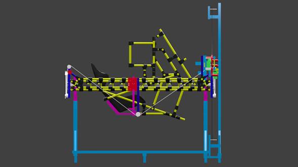

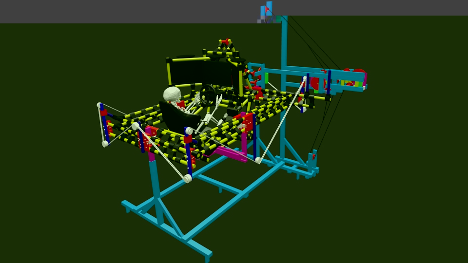

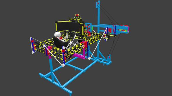

Bruno, DC motors guy I bought the F006 BOSCH WMO 310 in kalatec here in Joinville http://www.kalatec.com.br/Motor_Bosch/F006_WM0_310.pdf , this company is very serious and the service is very good, the engines are very good despite being 24V and 18.6a contradicting your opinion, I still can not tell them much because not formed opinions yet, but preliminary tests, I confess that I was surprised by their strength in a test that I did, I used a DC source 25V18a, AMC 1.5 and h bridge of Thanos. A second test, using a DC source 25V18a, a digital ammeter and 50th correte maximum motor bike with a crown attached, I noticed it running out of power consumed 0.7A, tried to stop the engine, and the most we could, using only their hands , he was consumed 2.5, still well below the rated current of the fifth, he consumes, despite all the strength that I did not get to it. With nominal current, it gives a torque 10N / m, but it goes to the 18th 45N / m, a danger, hehehehe. Like I said, I have only an opinion on the engines after esles are in the system, but I hope that the data are useful already raised.
Zeca, is very welcome to our group, I hope we can exchange a lot of information and we have so much fun. I'm also doing my aluminum joints but I'm using those claws collectives are strong and lightweight.
here are some photos of the project and that has become reality:
Perspectiva
Traseira
Lateral
Projeto se tornando realidade
We are preparing another working group to develop the wonderful AMC 1.6 of Thanos, see if I put some links here ASAP.
Regards to all
Speed ​​in soul and blood simulator!
Everton

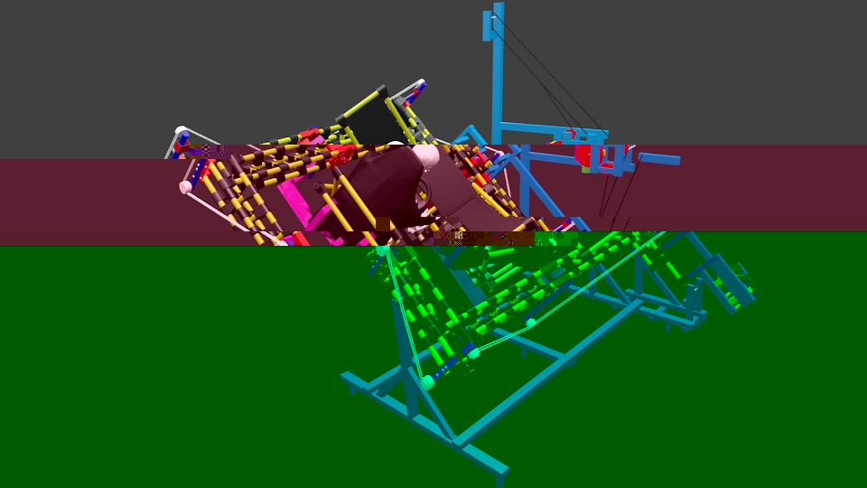

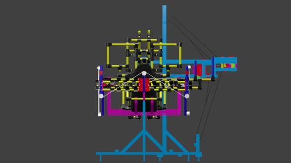

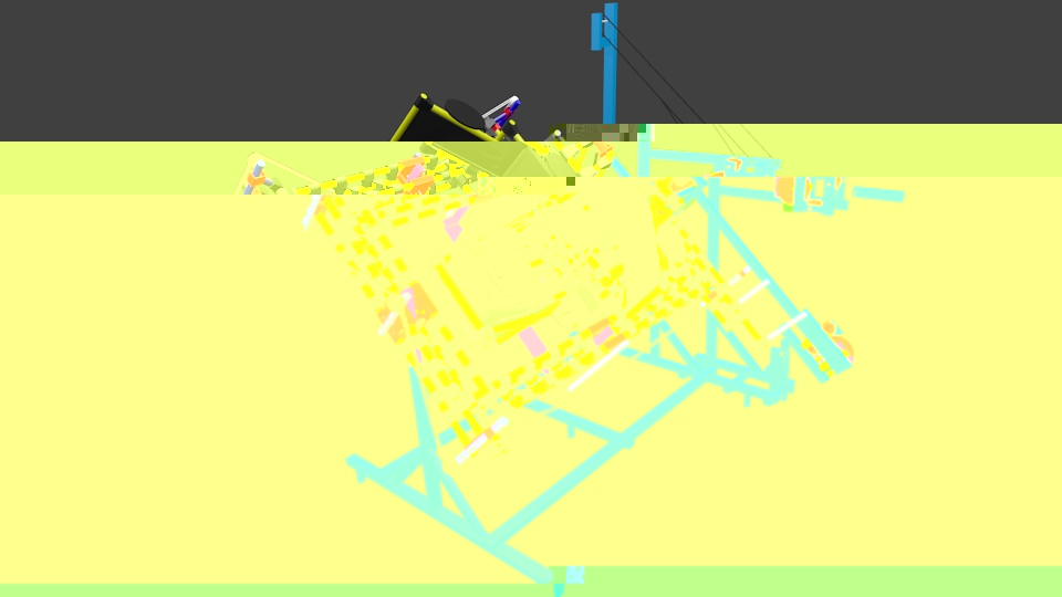

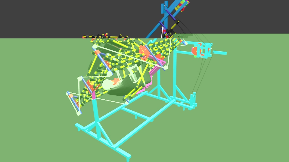

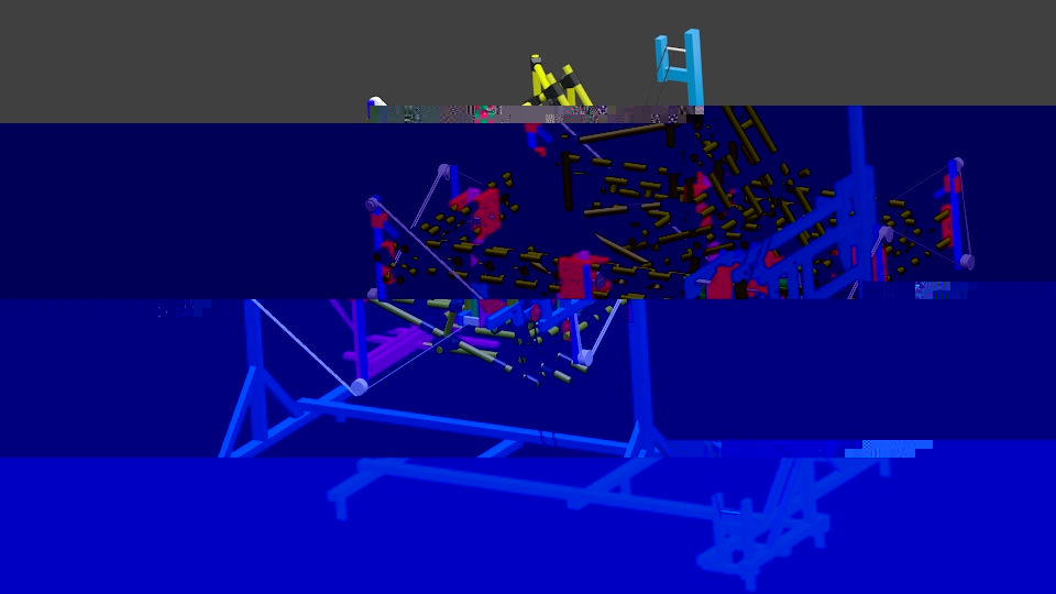

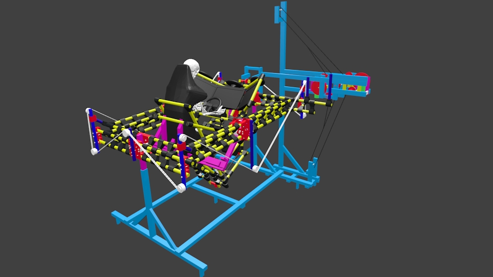

Acho que eu entendi mesmo errado, perdão cara, mas o que eu quis dizer com "contrariando sua opinião" foi em relação à corrente dos motores de limpador de para-brisa, pois eu tinha entendido que vc o estava advertindo sobre os grandes picos de correntes que ocorrem com estes motores de limpador de para-brisa (o F006 WMO 310 parece que também vai pelo mesmo caminho hehe), esta observação é muito correta, e mesmo eu, também sabendo disso, ainda me arrisquei com estes motores "contrariando sua op...RECOMENDAÇÃO", hehe agora ficou melhor, mas no fim nem era isso :-D.

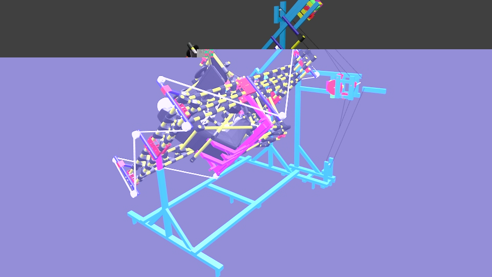

Quanto a estrutura, realmente eu fiz um modelo com um conceito que tentasse melhorar algumas coisas do modelo joyrider, entre elas estão; a confecção em alumínio para evitar rangidos e reforçar a estrutura, lugar para 3 monitores, e amplitude de movimento de -45º a +45º nos eixos X e Y. O resultado tá ficando bom, mas uma das minhas metas, não foi atingida nem de perto, que era na facilidade da construção, o negocio ficou muito difícil de se construir, e eu contava com este projeto, como mais uma das muitas opções que os entusiastas dos simuladores poderiam construir.
Veja aqui as amplitudes:
0ºY 0ºX
45ºY 0ºX
-45º Y 0ºX
0ºY -45ºX
0ºY 45ºX
45º Y 45ºX
-45º Y -45ºX
Abração :D
