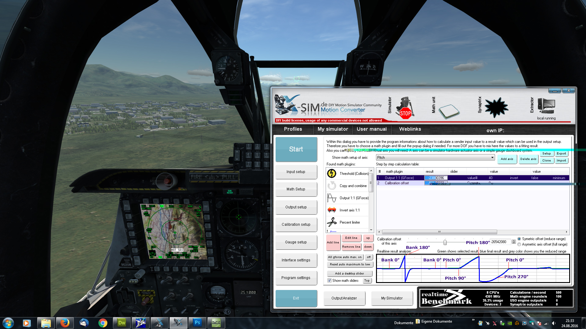

I have still a big problem with the DCS Roll also called Bank Vektors.
I have to adjust the DCS Bank Export Value (Effekt 25) or alternative ac.Bank.
Reason: This DCS vector is a combined body frame vektor, but i need a fixed world frame vektor in order to get a prober 360° Bankangle in my MotionPit.
Elseway the bank vektor is turning upsidedown, when pitch reaches 90°.
Therefor i need to convert the bank angle. This is best done in the export.lua from DCS World.
First i read out the Eulerwinkel (XYZ) like this:
ac = LoGetSelfData(lACid)
bank = ac.Bank
pitch = ac.Pank
Yaw = ac.Heading
So we have our three body frame vektors.
No comes the tricky part. I testet a few formulas like this:
roll = (math.cos(ac.Pitch)) * ac.Bank
roll = math.cos(ac.Pitch) * ac.Bank
or
roll = ac.Bank * math.abs(math.cos(ac.Pitch))
But still the Bank angle flips at somehow at Pitch up 90°. I also tried without radiant converting vaktor with math.deg() .
And also tried with the original vektors (LoGetADIPitchBankYaw())
No Effekt, see also screenshots with vector vaults.
Has someone a clue?

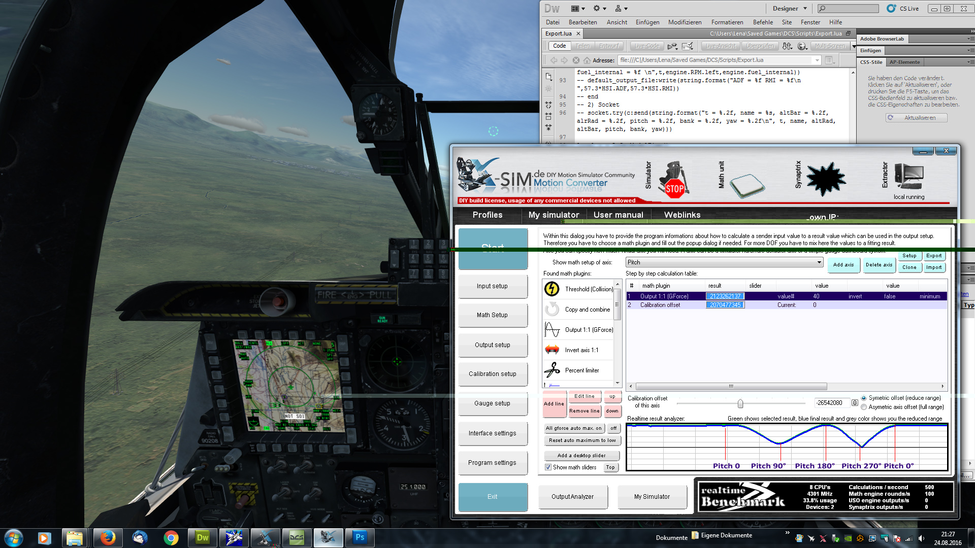

Update: i noted that the DCS vectors are not in equal formats. Some values are deg, some rad, some pos/neg, some abs.
In this case, ac.Bank and ac.Pitch are ...somewhat like radiant... :roll:
ac.Bank values goes from -3,14... to + 3,14 (1/2of full rad)
ac.Pitch goes from -1,57 to +1,57 (1/4 of full rad)
Therefor the Formula: bank * cos(pitch)
can´t work.
I need full radians from 0 to 6,28...
math.abs dosn´t solve this problem, because it only discard the minus-sign.
So how do i get a product of neg and pos values in lua???
PS: current (wrong) formula:
roll = math.abs(ac.Bank) * math.abs(math.cos(ac.Pitch * 2))
