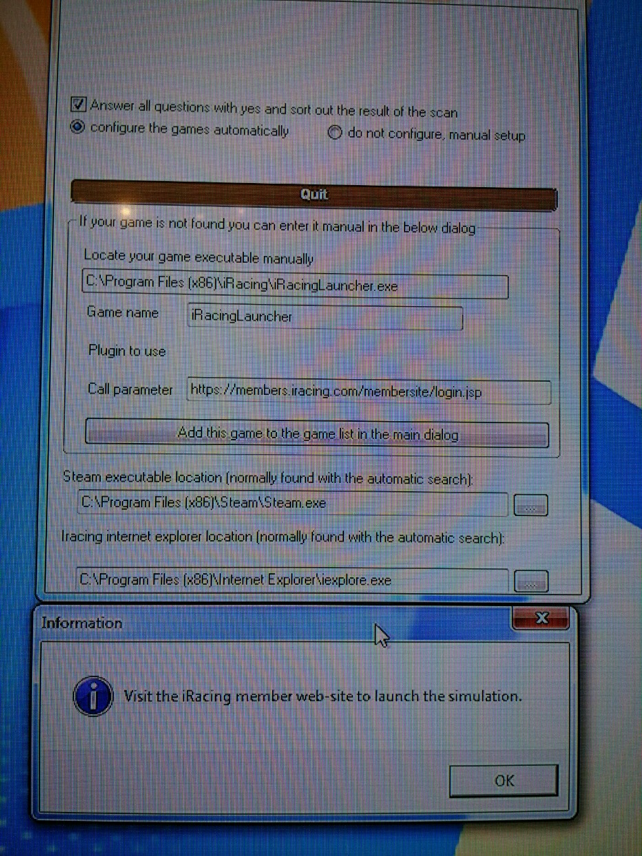

After last update 2017 season 2, x-sim can not find the program launch, with this updated 32-bit and DirectX 9 versions of the iRacing software are officially removed, now it supports DirectX11 and 64bit only, I have no idea how to change xsim to give the launch command .

Program is the final executable and parameter is launcher:mylauncher.exe

manually reloaded the game now seems to work although after paly game I get written informatio
iRacing memeber visit the web-site ..

the game now works with new executable but I get error as photos before take me directly to the log in page does not work automatically search
enter these values, press play game and then open your browser from iRacing
do not press ok on the play game window extractor should remain no gray blue
we await update
thank you

Postby sirnoname » Sun 12. Mar 2017, 13:57
No Update needed.
You can write, try and share a autosetup file for this?
old is:
Code: Select all
// X-Sim 3 game configuration script
title: iRacing startup exchange
games: iRacing
startup_file: iexplore
game_executable: iRacingSim.exe
game_parameter: http://members.iracing.com/membersite
new maybe (you must decide which browser etc. ...):
Code: Select all
games: iRacing
startup_file: iRacingLauncher.exe
game_executable: iRacing.exe
game_parameter: launcher:c:\programs\firefox\firefox.exe
The manual is there: http://www.x-sim.de/documents/Howto-gam ... cripts.txt
-> game_executable is the process running if iracing is started, I do not think the iRacingLauncher is the main program.
The play game button stay grey as long this executable is found in process list in the task manager.
-> launcher: maybe a link.

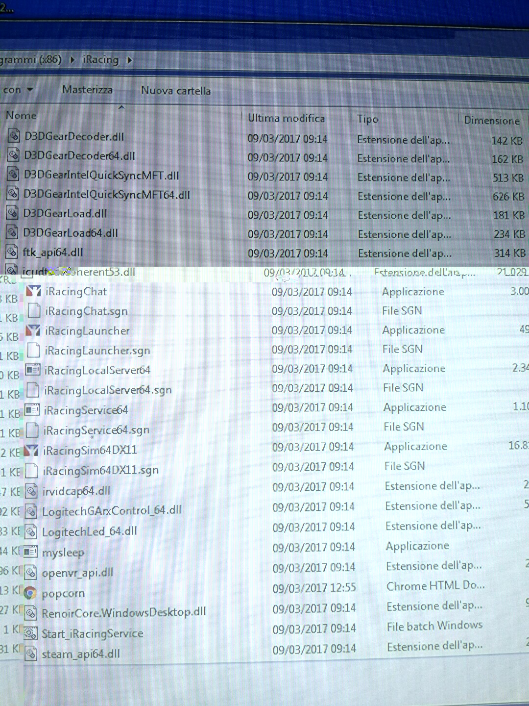

Re: Iracing not work after the update 2017 season 2
Postby tintao » Mon 13. Mar 2017, 01:39
Sigue sin funcionar.... he probado unas cuantas cosas y nada... os dejo lo ultimo que he probado
games: iRacing
game_executable: iRacingsim64dx11.exe
game_parameter: launcher:C:\Program Files (x86)\Internet Explorer\iexplore
