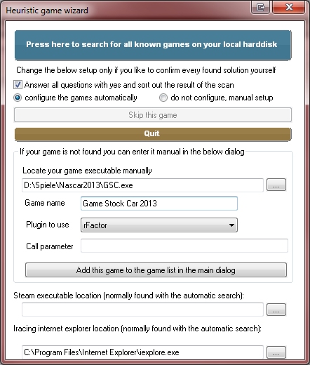

Open the wizard and insert the game parameters:
Insure the rFactor plugin is selected.
Now copy the rFactor plugin from:
C:\Program Files\X-Sim\Plugin\wizard_scripts
with name: xsimplugin.dll
to your GSC plugin folder.
Now select on the right side the Game Stock Car game and answer two times with yes. This will auto choose the rfactor plugin in the motion driver.

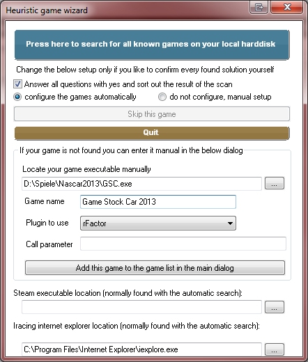

Now press the middle button "create a new profile from the right ..." and you get a profile in the middle for your game (maybe without converter setup).
Then you open the motion driver and insert this (you can write into the empty boxes):
Explanation:
The autosearch taskname name is shown on the window top of the game, with game running in window mode instead of fullscreen, or in the task bar or in the application tab of the task manager. The other parameter is the running game executable name that is seen as process in the task manager (CTRL+ALT+DELETE). The names may change with a new release of this game, but now you know how to change this name.
