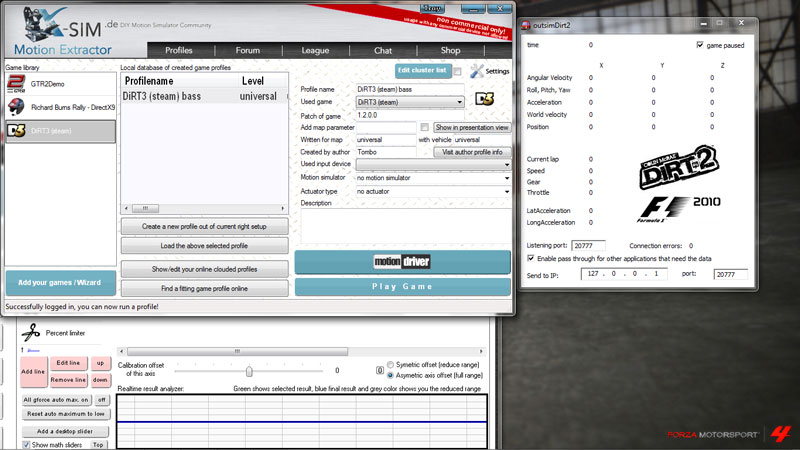

ok after downloading 11gb of dirt again and let xsim do everything still no data... In outsim game paused is always marked. And listenport is 20778. I don't know what i'm doing wrong.

Also tried to change to 20777. Registry clean was made at new xsim installation.
I think i am missing something. I settet up the Converter like in the Bassshaker Thread with Freq an Vol Axis. Loaded this profile in the executer. There i take the codemasters Plugin and run the game. Did i make something wrong?

Your pass trough is enabled for some unknown reason. This is not default.
It sends on the same port.
After a change you must restart.
It is not possible to exchange plugins. You have to take the one that comes with X-Sim.

thanks for your help again. Is just marked the box out restarted and it worked. I thought i have to enable this because it was enabled at default. Outsim shows the values but i think they are not sendet to the converter because there the values will not change.

it is a brand new install of x-sim and it was enabled by default just showed in the picture above with the wrong port :shock:
