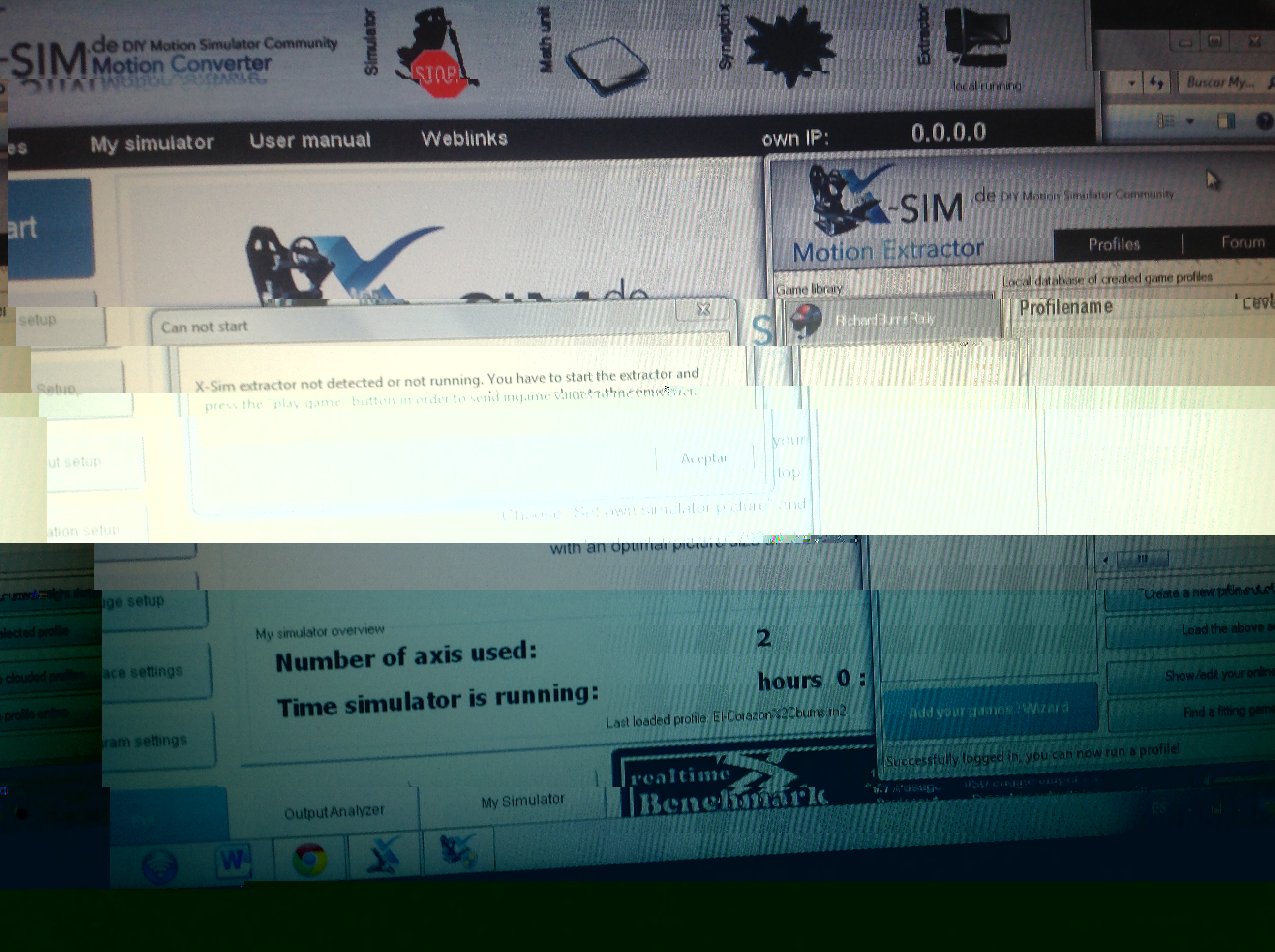

HELLO Good morning. My name is Daniel, and im from Catalonia 35 years old. Im creating a simple 2of racingseat but i have a little problems with the software, and i try to found help here.
Before of making this post, i used a search botton to find my solution but i can't found it :|
I open the extractor and converter. I select the plugin of the game and load a profile in extractor.I push the botton play game and the game starts. After that in a converter i don't have any Ip adress and can't comunicate with the xtractor when in push START boton. Im using only one pc.... local running but not detected.... i can't view the changin values in a input setup when the game is running in a windowed mode.
My windows 7 is 64 bits
no antivirus on my pc installled
m.essentials is disabled
and my firewall is turned off.
Can anyone help with this problem? Iwill use a velleman and sabertooth cards, but now i would test without cards. is it's possible really?
Thanks in advance, and sorry for my primitive Inglish jejee
Regards,
Dani
Pd. I added a foto of my problem.

Postby sirnoname » Tue 27. Aug 2013, 13:24
0.0.0.0 should be fixed with current version but it is only a help display and you can ignore it.
If you use the extractor and converter on same PC you do not need IP address and network. (one of the big plus of version 3)
New installations are not needed, no regclean.
Loading unknown profiles maybe a problem, make your own step by step.
In your case I would say: you did not start the game with the play game button.
There is no RBR in the taskbar, there is no grey play button.
Same as the message told you.
Have a look to the manual:
http://www.x-sim.de/software.php?lang=e ... n_training
