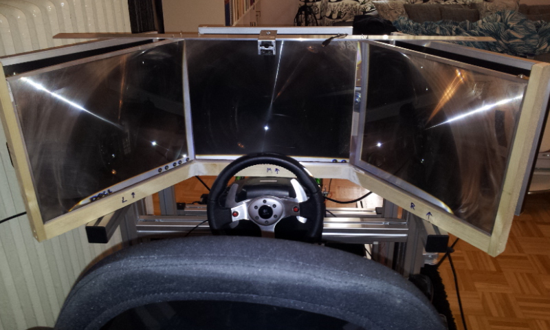

Postby yokoyoko » Thu 1. Nov 2012, 15:08
Hi Turn,
I don't know how to thank you in a reasonable way!!! This is one of the greatest mods of my rig so far.
I copied your setup - ordered 3 dirt cheap 19inch monitors on ebay - and the mentioned lenses in china. They sent them very quick to Germany! Just the shipping price is :twisted: ... But I found no alternative in europe (the prices in China are really crazy cheap!)
The whole setup is und 200€ with cables, aluminium to mount, lenses and monitors... and what you get for this is really great!
I was sceptical if a seatmover is good for such a kind of setup because the Sim moves you around the "focus" of the lenses AND the lenses need to be mounted very stable if you got motion ;-) But after testing all doubts are away - this rocks so hard!
Here a pic:
Don't get confused by the pic - if you sit on the seat everything (images) fits perfectly. --> This is the hardest part of the job :-)
I know - this looks veeeery prototype like. A friend is doing a frame for me that will fit exactly for the lenses and locks up with the monitors. This will be overdrawn with black suede - so it will look like ONE big screen.
Thanks and reagrds
yoko
