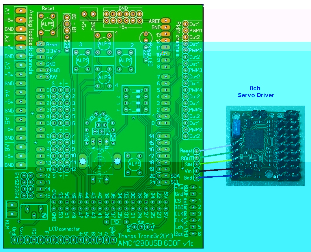

Hi Thanos, this is my start, but when all plug in and power on I have this little moves of servos.
Do I miss something? the servo numbers on the lcd panel are moving, too

Postby tronicgr » Mon 1. Jul 2013, 17:17
Hi Italo,
I was going to email you about it but I'll write it here instead. You need external potentiometer attached on each servo, like you do for real life platform motors, to implement the position feedback. The servos now output speed and direction but positioning is not complete without feedback loop from the sensors.
As I said this allows to build the real size platform under scale.
If you wish to have the mini platform without extra position sensors attached and use their internal position sensors, I can add that function the next days but the result motion won't be so realistic as servos tend to move to the commanded position in full speed and stop abruptly.
Regards,
