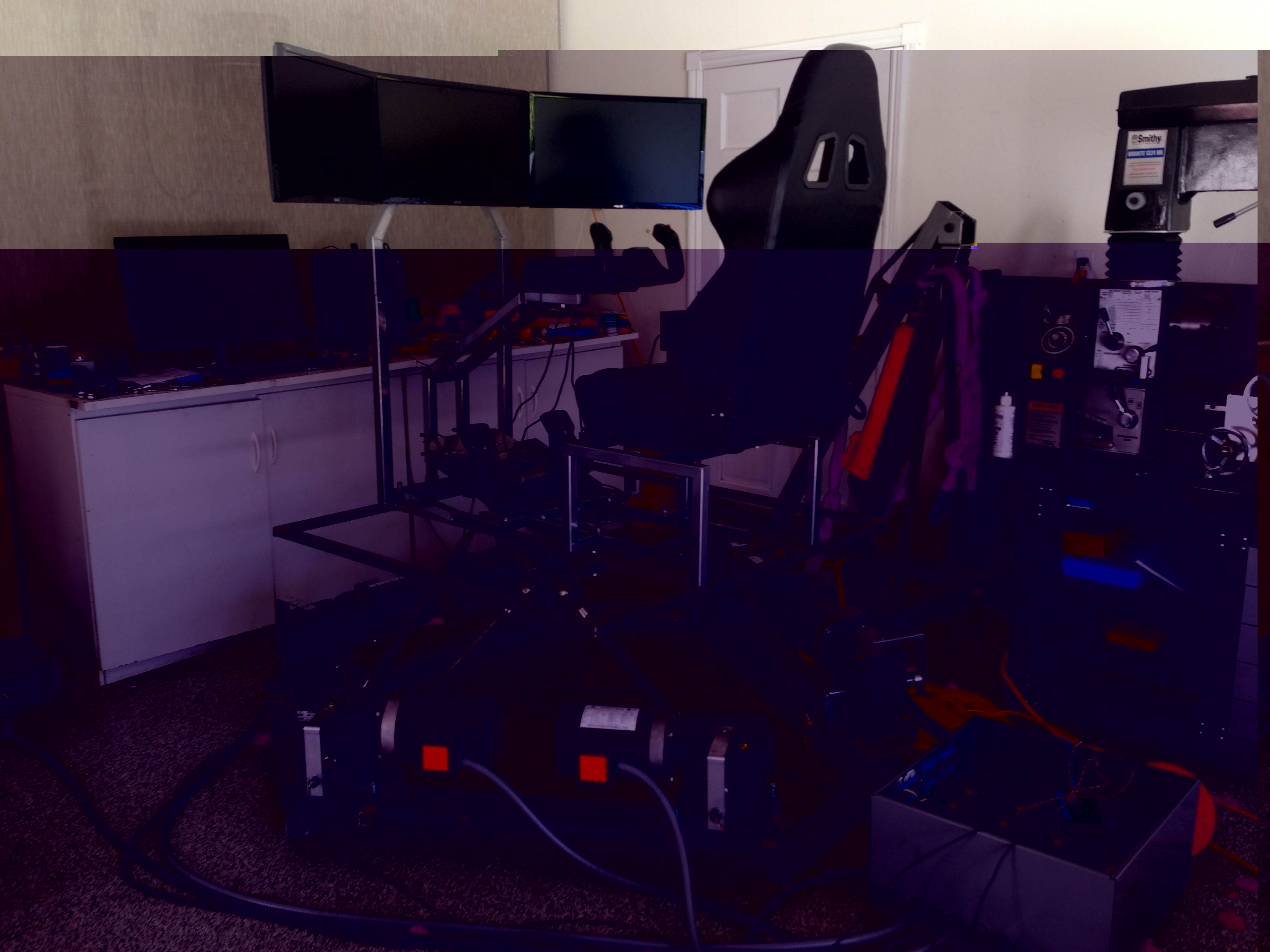

Its perfectly safe. On the 6DOF on the next photo, all six ac motors are connected to the metal frame with no voltage leakages. And as extra safety measure the frame was grounded.
http://motionsim.blogspot.com/2013/04/some-photos-of-6dof-platform.html
