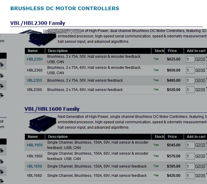

Postby tronicgr » Sun 28. Apr 2013, 20:01
BobBuilt wrote:No one attempt a brushless setup yet , that i publically know off.
Looking at the cost of the brushless drivers I think its more cost effective to head to VFD inverters and AC motors...
But I know a person that is attempting to use Moog linear servo motors with my 6DOF electronics which are essentially brushless.
Re: OSMC - Open Source Motor Controller 400a/50v
Postby tronicgr » Mon 29. Apr 2013, 06:09
The size of the 6DOF platforms is the correct one as well the size of the AC motors (1HP each). The idea behind it is not to have only the driver/pilot on it but also controls and full cockpit, screens and why not the motion computer mounted on it as well. And why not 2 persons on it? I had really hard time trying to balance my joyrider back in 2007 for just the passenger a few controls and a tiny LCD screen using those windows wiper motors...
Threre are brushless drivers now with price as low as $20 but they are just speed controllers. They are not reversible! They do control speed but not position.
