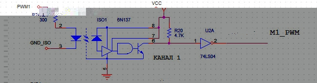

First - I strongly recomend you to use "signal normalisation" after optocouplers. Like this:
Second - To increase speed of optocoupler you should decrease resistor in the collector of optocoupler transistor. Try to decrease it to 330..470 Ohm.

Postby eldeejay » Tue 5. Mar 2013, 14:52
prilad wrote:Hi.
Reagards,
Ale
Hi Prilad,
you mean the resistance pull-up R20=4,7K change to 470ohm?
buy the optocoupler SFH6705 yesterday and I'm hoping to distribute the transport agency for testing.
http://www.vishay.com/docs/83683/sfh6700.pdf

Postby prilad » Tue 5. Mar 2013, 16:33
eldeejay wrote:Hi Prilad,
Hi, Eldeejay.
I carefully studied your pictures :D and saw that you use 4n25 optocoupler. I think you have Thanos isolator schematics.
On the oscilloscope we can see that the output transistor simply can't be fully opened (this is not "hysteresis"). This means that the current through the input LED is too small. In 4n25 datasheet they recommend to set forward current = 10 mA. In Thanos board input resistors (1.5 K) can provide current only (3.75 V / 1,5 K) = 2.5mA.
From other side - In datasheet we can see, that for max switching speed you should use only 100 Ohm resistor (instead 1.5 K) in the collector of output transistor.
So I recomend to use resistors 330 Ohm for input size and 200..300 Ohm for output size. For the begining. And if you have oscilloscope, you can choose the most suitable resistors to ensure the best performance
