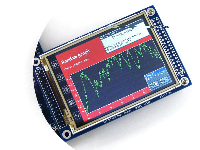

I was looking around for modern microcontroller solutions and couldn't help noticing all these new cheap Cortex M3 development boards arising.
They are totally different from AVR family but I could give it a try for an ultra fast motion controller with 4 or more axis. In the next link this one even has 3.2 inch touch LCD screen among other connectivity addons:
Open107V ARM Cortex-M3 USB STM32F107VCT6 MCU Development Board Kit
And a cheap programmer/debugging interface for it:
J-Link V8 ARM USB-JTAG Adapter Emulator - Black
So if anyone is open for donation for one of these please let me * It could really change everything we thought about motion simulator electronics.

I too have arduino Mega2560 at home, but I never found it useful. The fixed speed crystal at 16Mhz makes it unusable for accurate serial communications. Serial communications need a certain speed division for the cpu cycles to synchronize for uart polling. Also the lack of any on-board buttons or peripherals makes it necessary to use shield for interfacing to the outside world. Maybe create a arduino shield then? I Will think of this possibility and how and if can be done. Also it might be difficult to find a proper loader on PC side that works with the Arduino bootloader correctly. It might need external programmer as well.
I'd might suggest instead this board that is chip compatible with atmega644 and you can "change" the crystal to uart compatible ones:
http://www.ebay.com/itm/STK16-Premium-MCU-AVR-mega16-ATmega16A-ATmega16-32-8535-IC-Development-Board-/260911401983?pt=LH_DefaultDomain_0&hash=item3cbf880bff
or this that is more slim:
http://www.ebay.com/itm/ATmega16A-PU-ATmega16-mega16-AVR-Development-Board-Starter-Kit-Full-I-O-Expander-/250949051253?pt=LH_DefaultDomain_0&hash=item3a6dbaa375
But then you have to hardwire all peripherals your self.
Back to topic:
The difference between AVR and ARM Cortex is that Cortex its a microcontroller with different architecture and fully 32-bit, Single-cycle multiplication and hardware division. Also its very suitable for motor control as it has lots of hardware features for this reason:
-80 I/Os, all mappable on 16 external interrupt vectors and almost all 5 V-tolerant
-Up to 10 timers with pinout remap capability
-Up to four 16-bit timers, each with up to 4 IC/OC/PWM or pulse counter and quadrature (incremental) encoder input
-1 × 16-bit motor control PWM timer with dead-time generation and emergency stop
-2 × watchdog timers (Independent and Window)
-SysTick timer: a 24-bit downcounter
-2 × 16-bit basic timers to drive the DAC
-2 × CAN interfaces (2.0B Active) with 512 bytes of dedicated SRAM
-USB 2.0 full-speed device/host/OTG controller with on-chip PHY that supports HNP/SRP/ID with 1.25 Kbytes of dedicated SRAM
-10/100 Ethernet MAC with dedicated DMA and SRAM (4 Kbytes)
Also it has the processing power to handle complicate graphics on its touch LCD screen for GUI or just display RPM/SPEED/GEAR/TEMP gauges along while its driving the motors.
Lots of new sensors that arising these days are working at 3.3v and I'm talking about accelerometers/gyroscopes and magnetic compasses that could replace potentiometers for motor position feedback.
Not to mention that most Android cellphones run on similar ARM microcontrollers...
It's just a technology that was never before easily accessible in cheap development board like this. Its more an opportunity to step forward into something better, a new standard.
