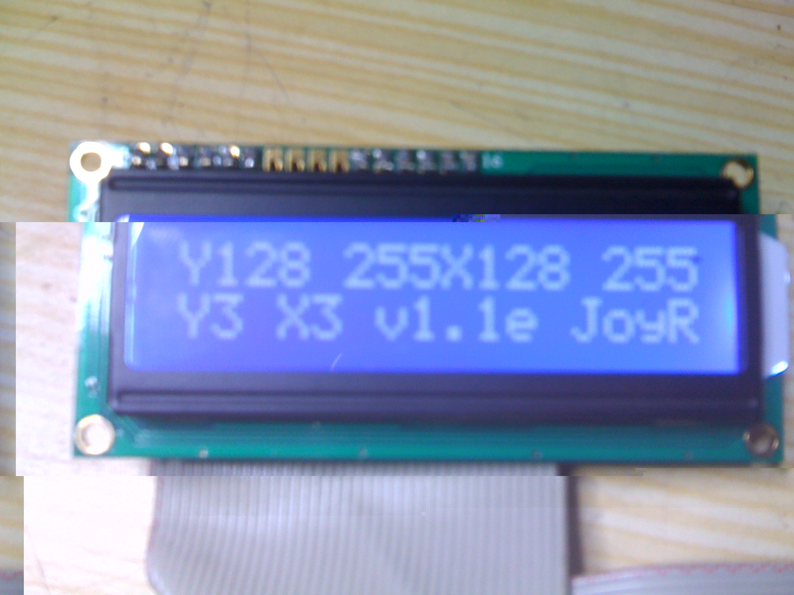

Something extrange has happened today with my AMC 1.6. The values of pot X and Y do not change when I turn pot and remains statics all the time. I reflashed the board but nothing happens. I'm using 1.1e and
Any ideas?
I attach the LCD info screen:

This looks strange. When you press reset, do you get all the intro messages on the LCD? What happens if you turn off the DIP1 switch?
Also the 255 number you get for all potentiometers indicates you have to set the correct ADC range. You must turn the blue multiturn potentiometer all the way clockwise.

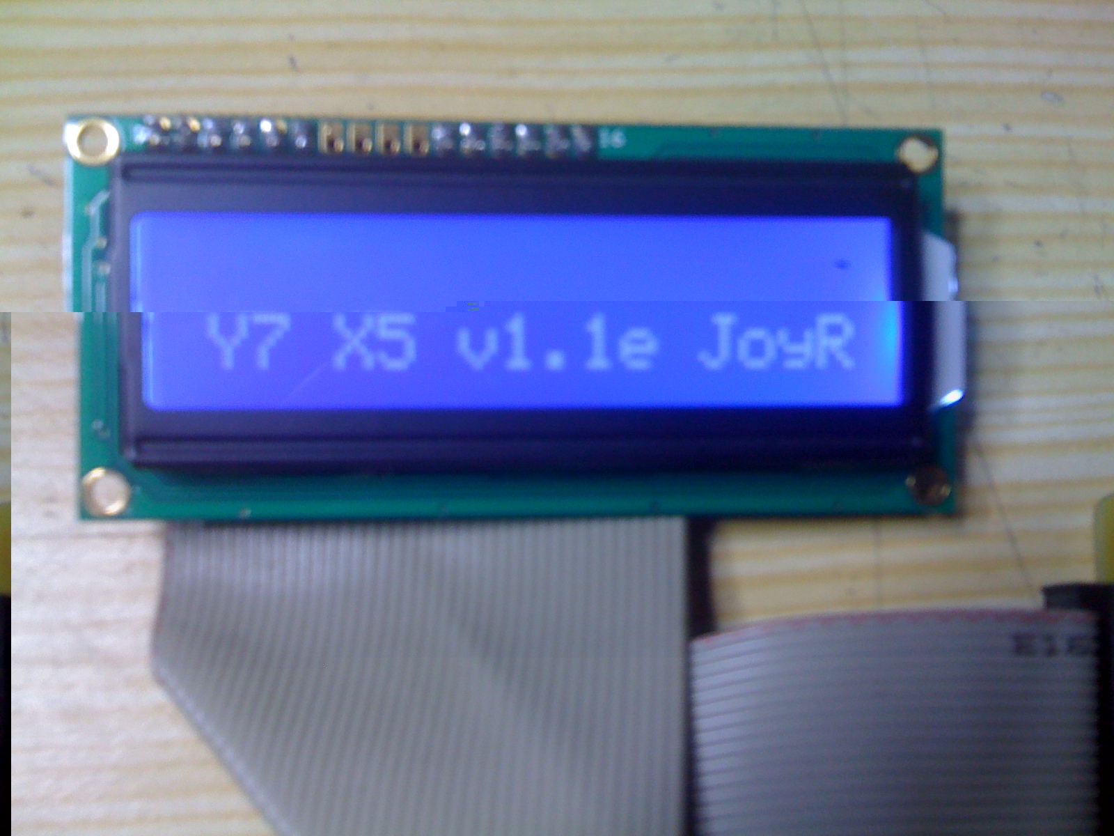

When I press reset I see all intro messages, and I turn off the DIP1 switch the first line message disapears:
I also tried to adjust the ADC range but nothing happens. Also the stored KP settings have been restored to 7 and 5.
