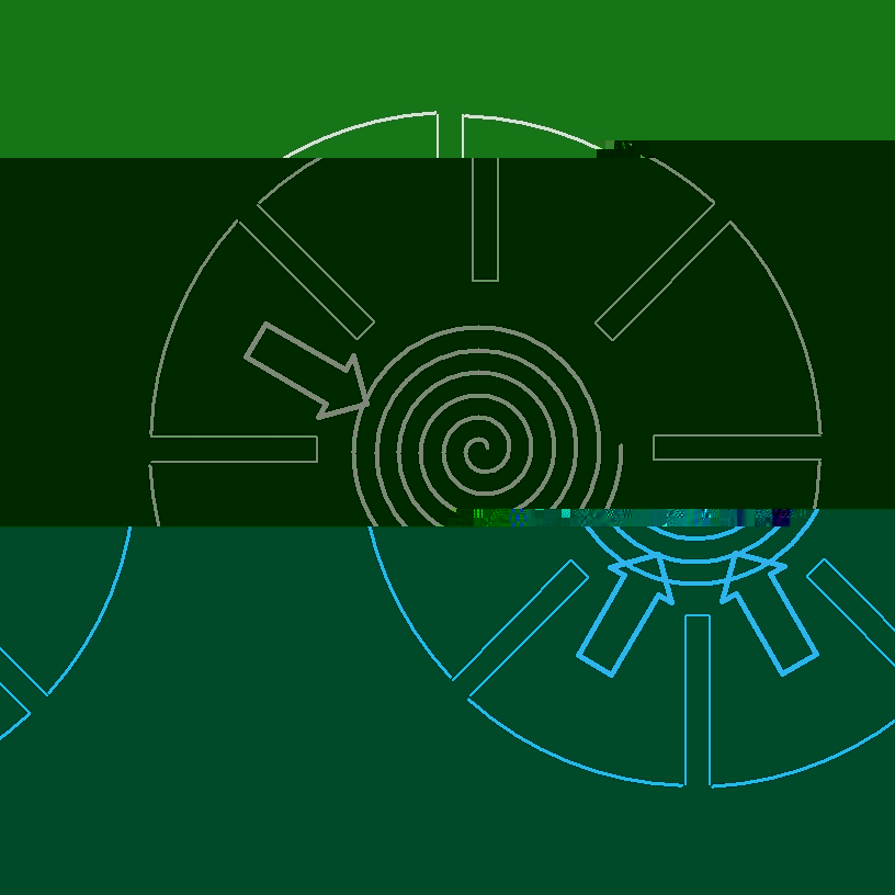

That's what I wanted to ask - are you sure that linear cuts in the copper plate is need to do? I think it will be work fine and without they. (IMHO) ;)

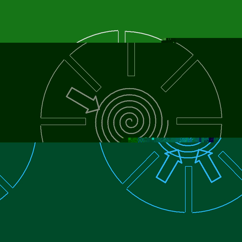

the cut's in the copper disk are made to direct the heat toward the center of the disk ... is the center of heat drain ... so it will be sucked by the fan ... no heat leakage between MOSFET's ...
