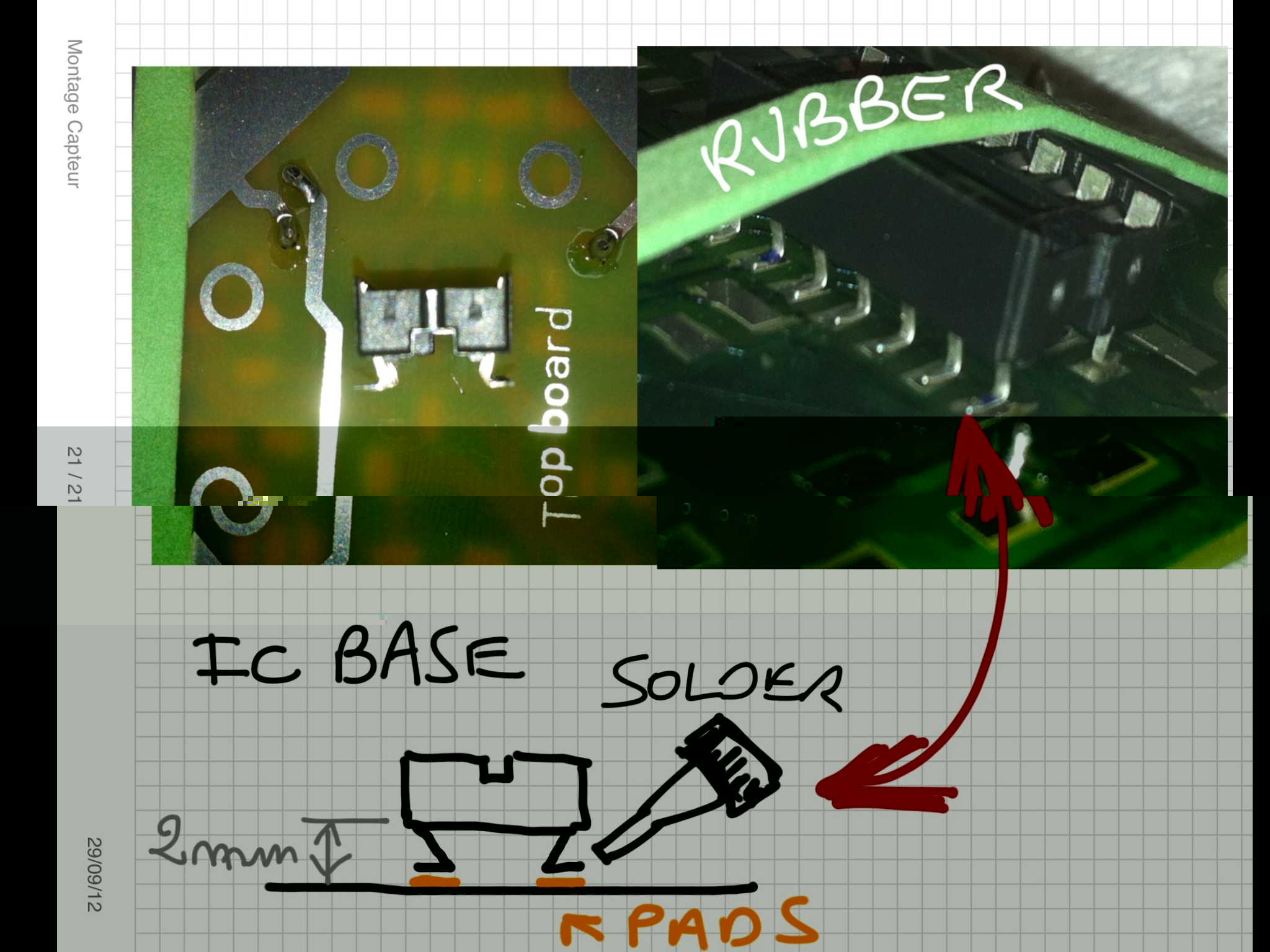

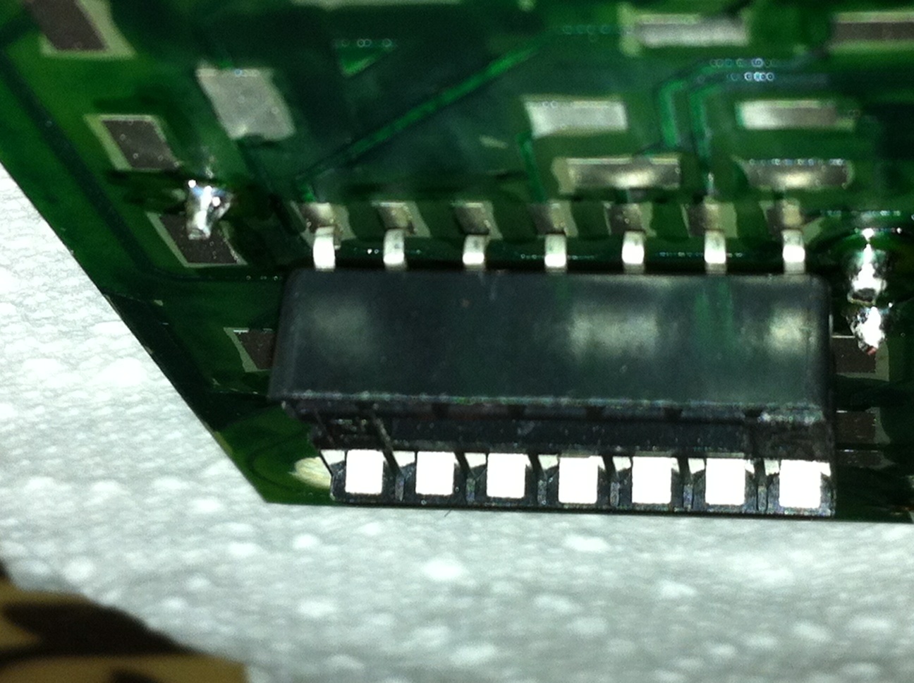

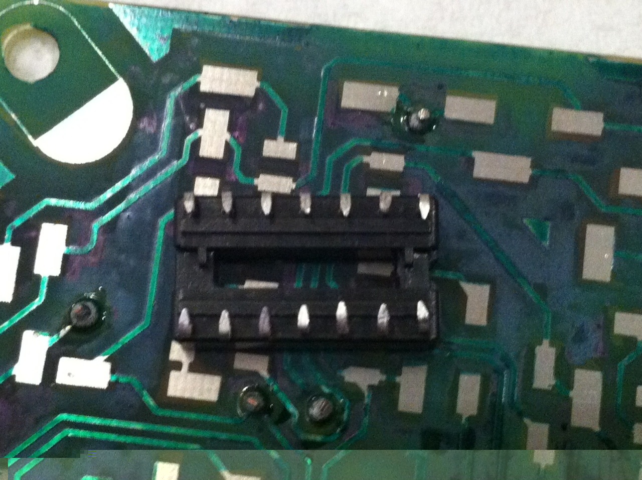

Hi Speedy ,
Just a question about mounting the 3 components ir2110 and the 74hc08 .Did you mount them directly to the pcb ?
In the part list you wrote a dip socket for mounting them but it's very hot my friend to solder this sockect :oops:
The space between the pads is very small !
I ask you this because the socket is larger than the pads ,and It isn't possible to get the dip legs flat for soldering on the pcb(the ic base + legs each side flattened are larger than the space between pads)
Best Regards
Pictures to illustrate what I speak about.

Postby vicpopo » Sat 29. Sep 2012, 22:07
Hi Speedy,
I think I found the solution :D !
You can watch the picture below.I didn't solder yet but I think that I have enough space to solder.
Solution

Postby speedy » Sun 30. Sep 2012, 02:01
good job vicpopo ...

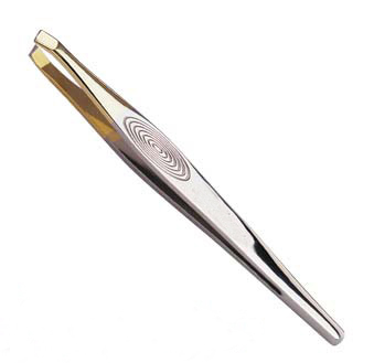

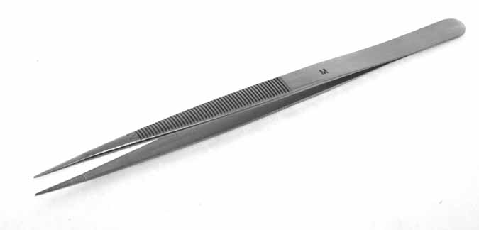

Use a professional tweezers like this for all soldering actions
or a female syle like this :lol:
- you should pend the legs as the last post ...Bend the legs the outside way so the legs can rest on the bad without the spring action. ... don't worry ... once all legs are soldered like you did it will become solid .
-Or ... You may also shorten the legs 1mm using nail clippers to have a space on the pads to put solder .
-This German brand of soldering grease in magical ... use it with micro grams . :lol:
-If you don't use a solder grease ... Then put some tin on one corner pad and the corresponding base leg ...
-hold the IC base with tweezers or with bare hands from the opposite side aligning the base on its position correctly ... [carefully if you have a thick thumbs like mine] ... or it will give you wawa . :cry:
-solder that first IC base leg ... next, do the soldering for the opposite IC base leg, the base is now fixed and wont move ... continue soldering all legs .
-preparing the pads surface with some tin and using some solder grease will help a lot ... that's the magic fun part of it .
the last photo suggested is very good recommended way for iron angle of solder touch ... You are going to do it !!! I feel that .

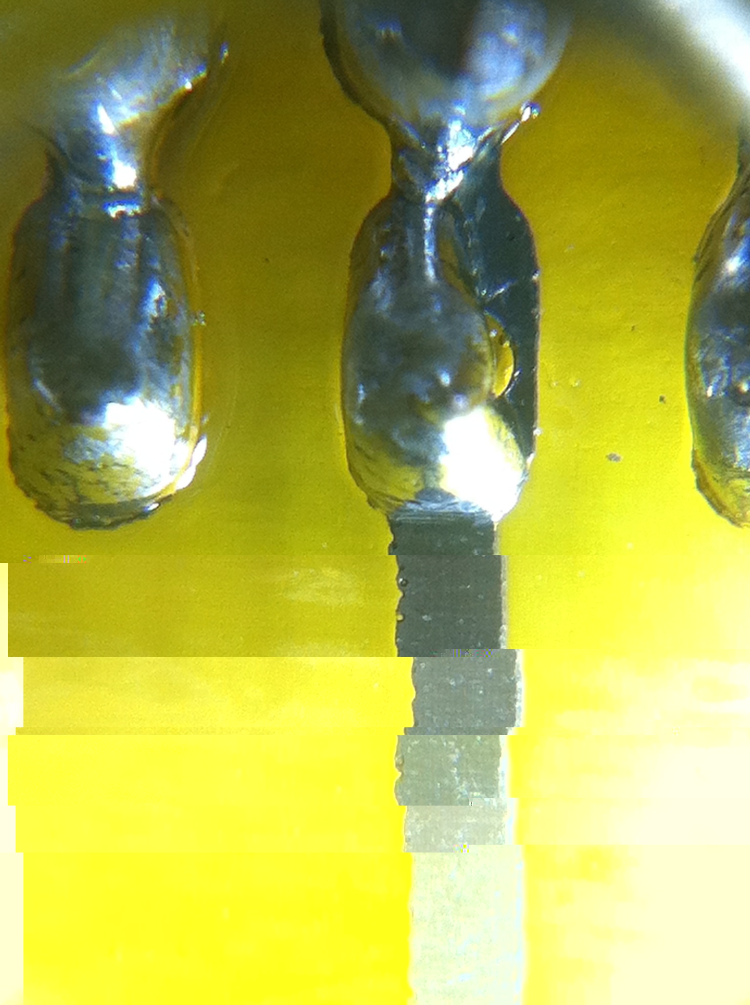

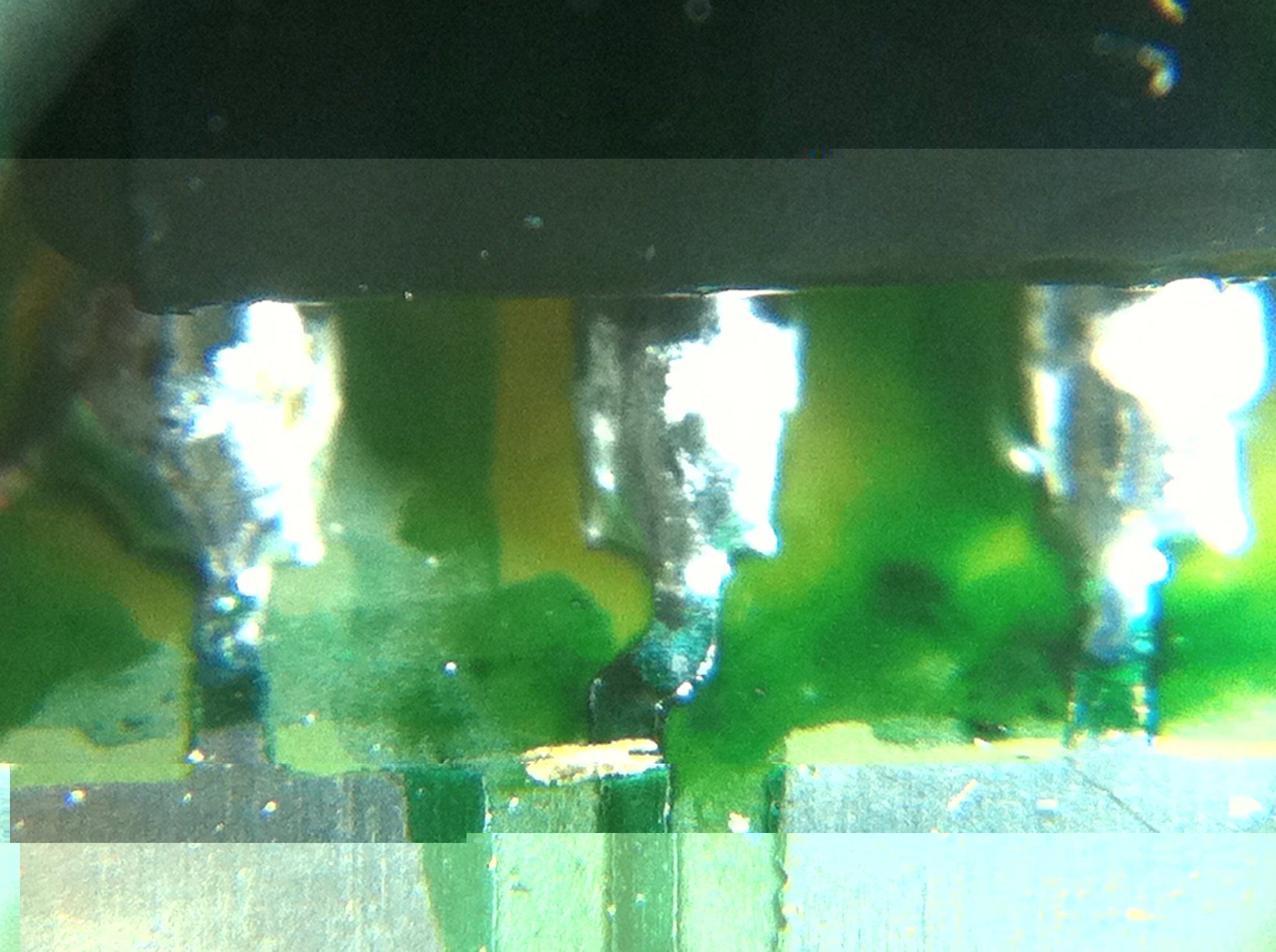

Hi Speedy,

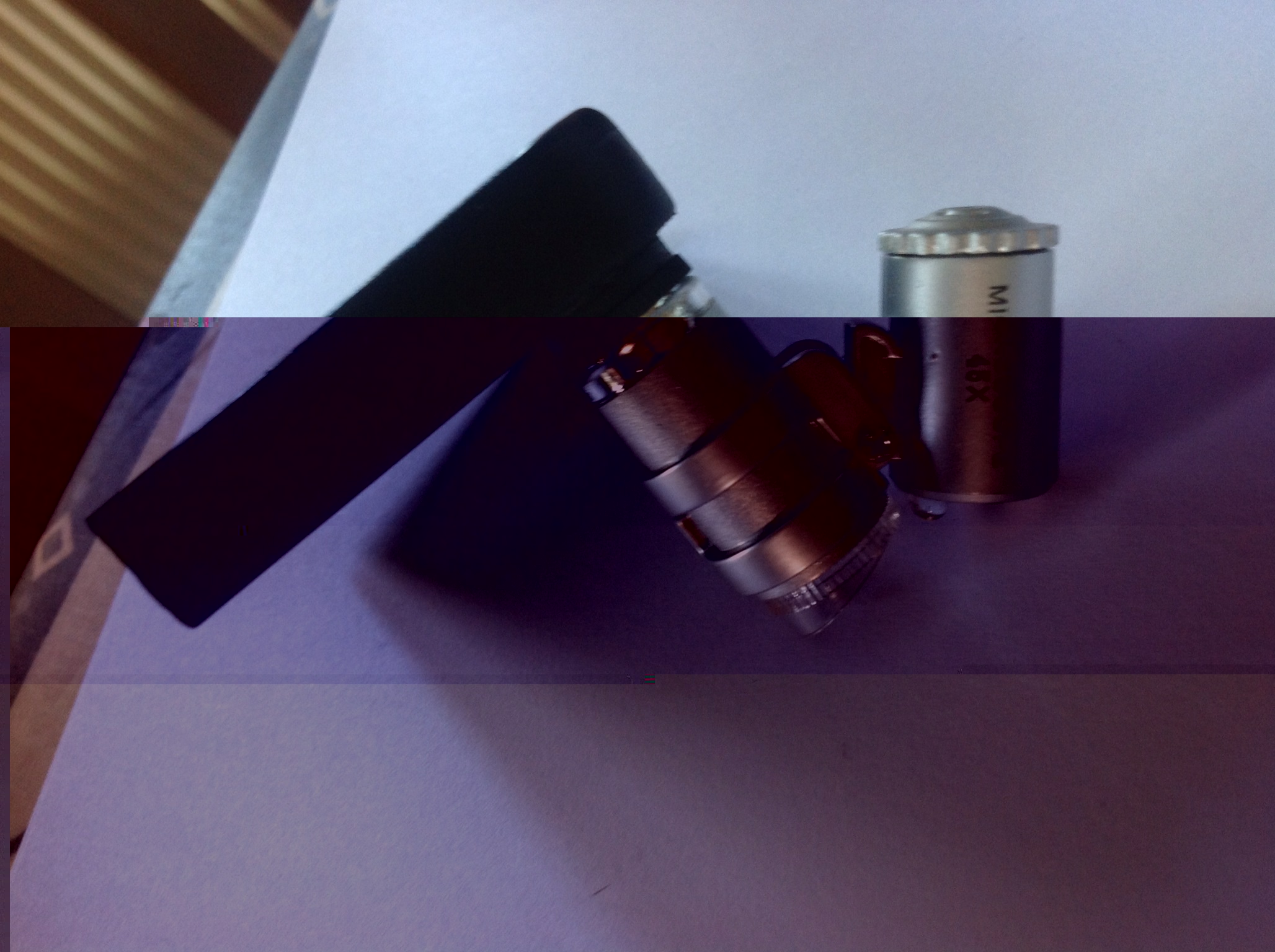

I made the picture with my smartphone (not the cheapest one I agree with) but with this cheapest microscope , I 've got the cheapest microscopic camera! :D
The microscope mounted on a smartphone case:
Microscope
An exemple picture made with it from a solder x45
Solder
That is funny isn't it ! ;)

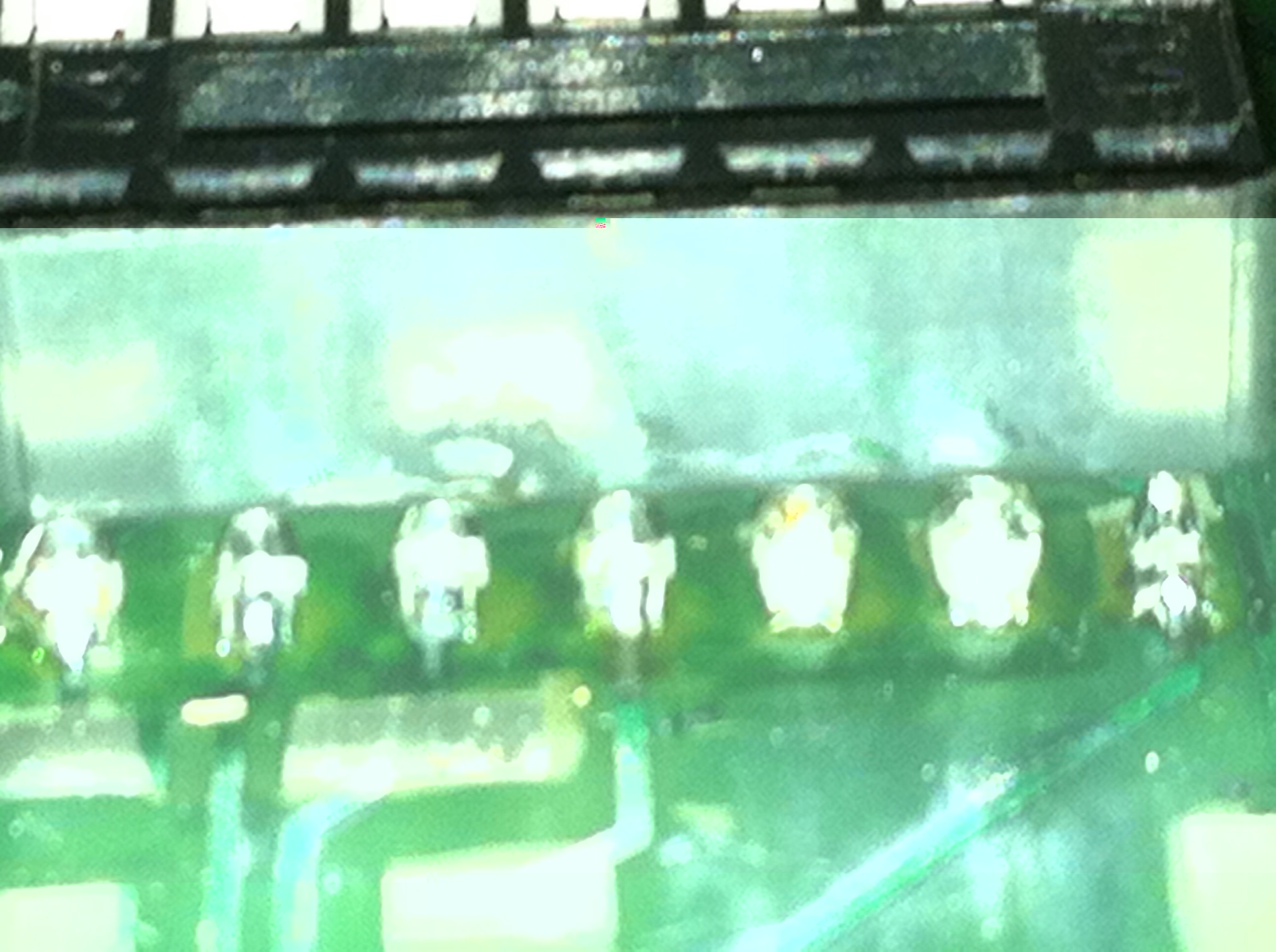

Re: DC motor_N-channel MOSFET's_H-bridge
Postby speedy » Sun 30. Sep 2012, 21:05
Wooow ... that''s a good peace of equipment ... Is it a smart phone accessory ? ... pls. tell me how to get something like this
I went back in the chair and let a cigaret to enjoy the picture of soldering in the full screen ... :lol: ... rare position for my back :lol:
And for sure it can give you this kind of images for small size SMD tracks inspection .

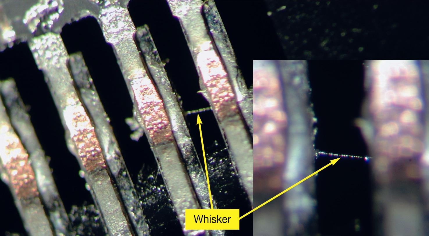

But,there in some viruses hiding behind the left leg :D ... and seriously advice there is an air gab in the mid one that may cause a future joint capacitance, use the grease my friend, use the grease ... Don't depend on the flux built in the soldering lead .

Hî Speedy,
You can watch this video :
I made this accessory by myself .I bought the microscope on ebay + a phone case and I glued the microscope on the case that I cutted on a half before(like the video is an half case )

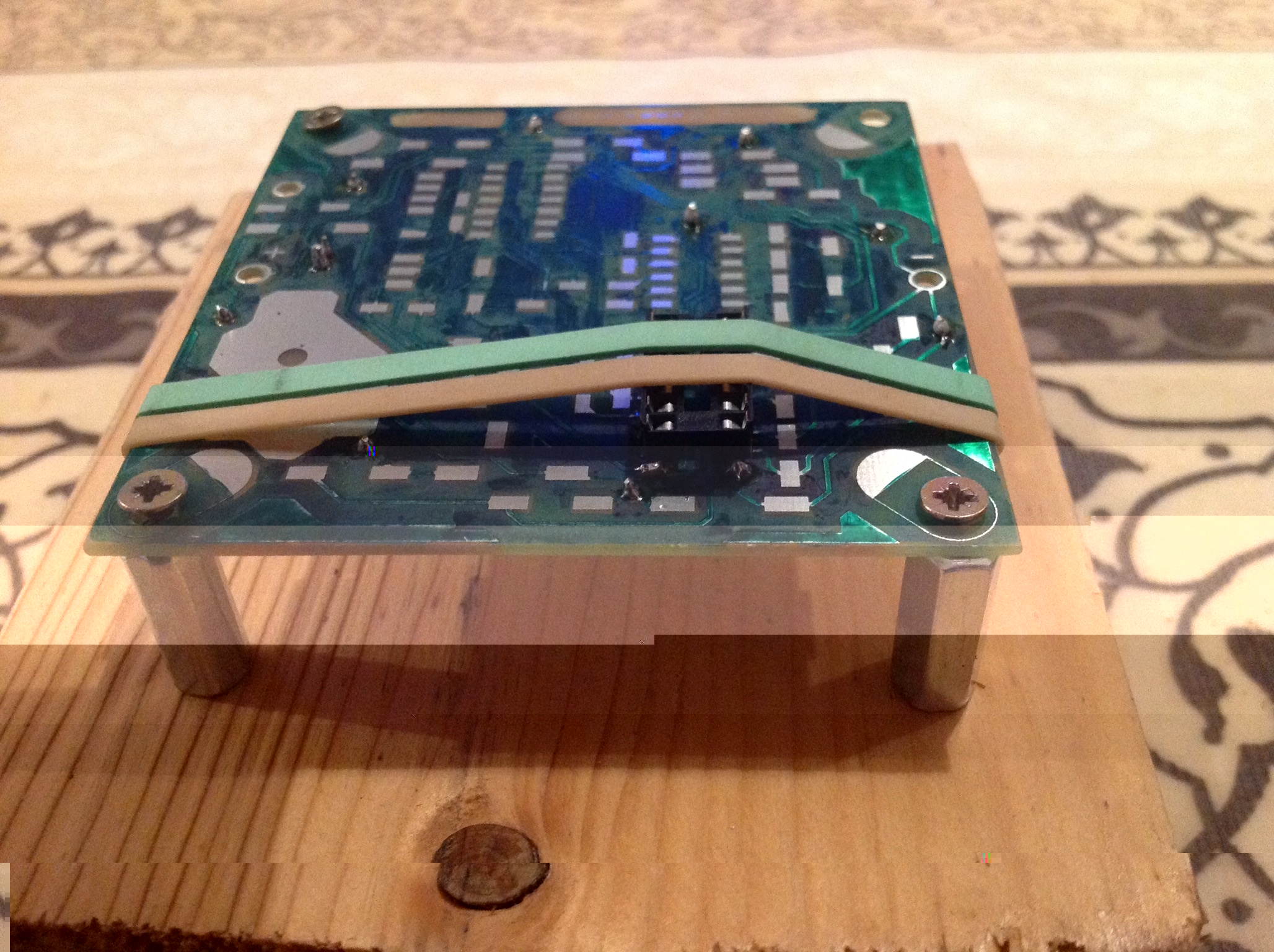

I soldered the first dip.Unfortunately I didn't use grease because I don't have it at home.
Below some pictures.
Solder
Before soldering I attached the pcb and the ic base as the picture.I used and it's a good idea 2 rubbers to maintain the ic base for the 2 first soldered legs and after I removed them to finish.I had enough space to solder properly without stress.
Montage
For the straps thank you to remember me them.

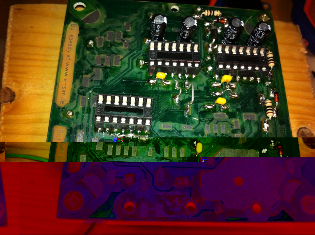

Postby vicpopo » Tue 2. Oct 2012, 08:07
Hi Speedy,
You can find attached a picture from where I am in the project right now!
One question about the regulator : the tined area near it has an utility?
Do I put the regulator on the pcb surface or fix it standing(but it crosses tracks).Could you make a little hand drawing showing the right position.
Otherwise it's really quiet to solder ,that takes more time but it's funny.
