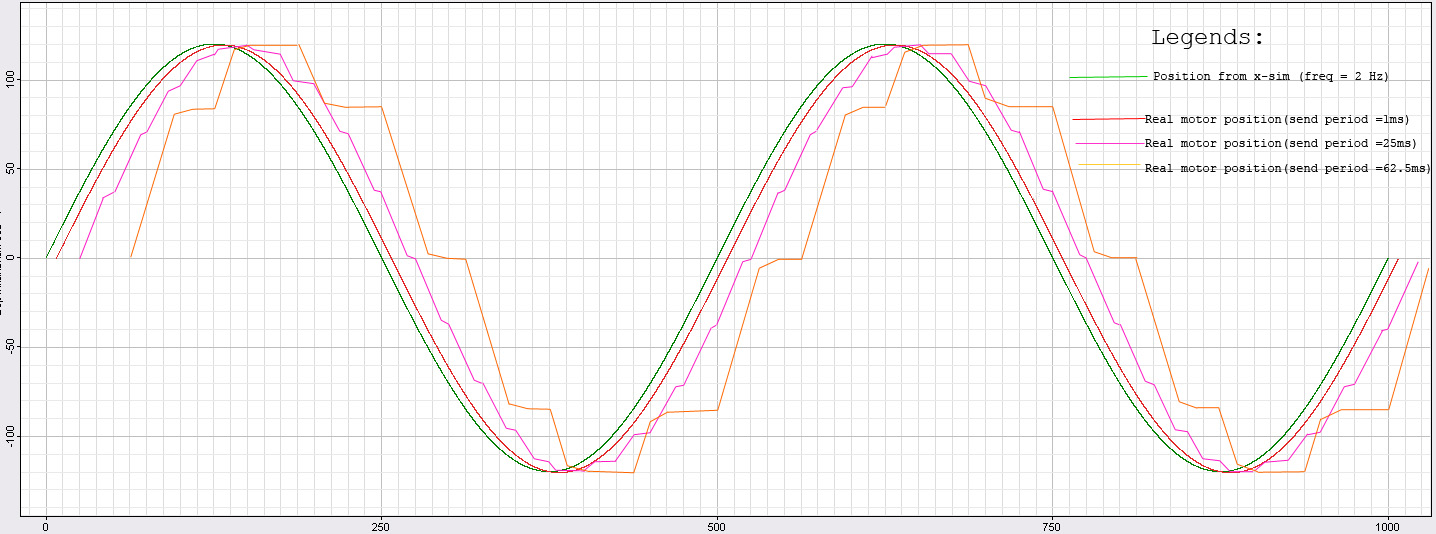

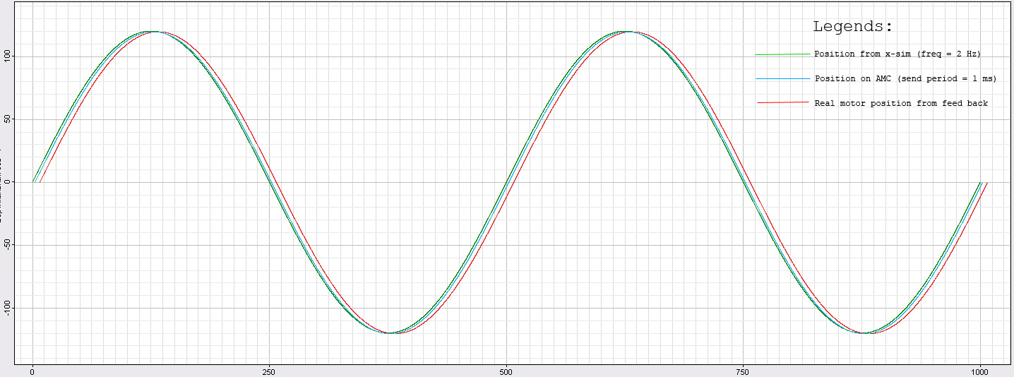

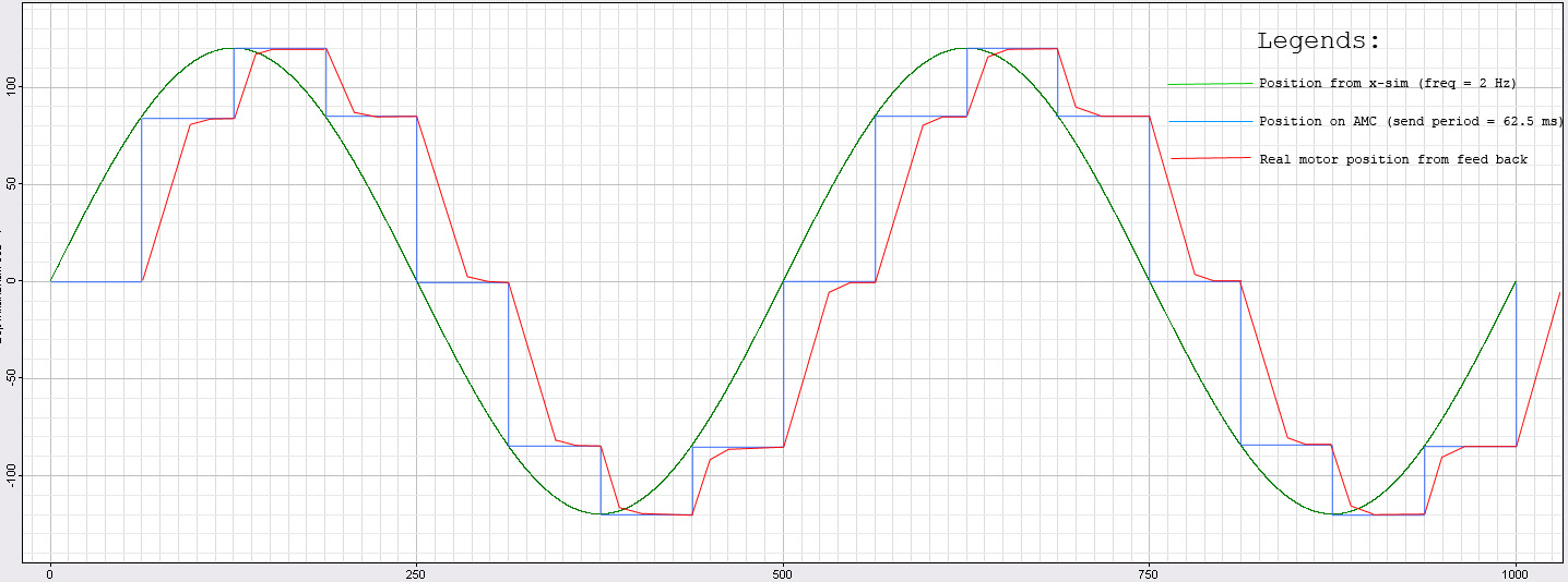

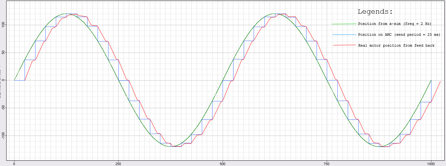

I'm sorry, Thanos. But I can not agree with you ;) . Why did you decide that the reaction of the motor exponentially??? From your calculations obtained some fantastic delay. I want to once again draw your attention to the your video.
http://www.youtube.com/watch?feature=pl ... NfZLTcgIQ#!
At the seconds 50th you are just sets the period on 100 ms. However, the huge delay = 1 sec not happening. There is only a distortion of the signal, its deviation from the desired sinusoidal form.
Below I have listed a series of illustrations to explain the reason for these distortions that arise when the period of data is greater than the time of processing the PID
period = 1ms
period = 25 ms
period = 62 ms
All comparison
This "theoretical" cases are very close to "real" ones (1 ms, 33 ms, and 100 ms) what you use at the video. There are not delays more then SUMM of "motor reaction" delay and "send period" delay.
