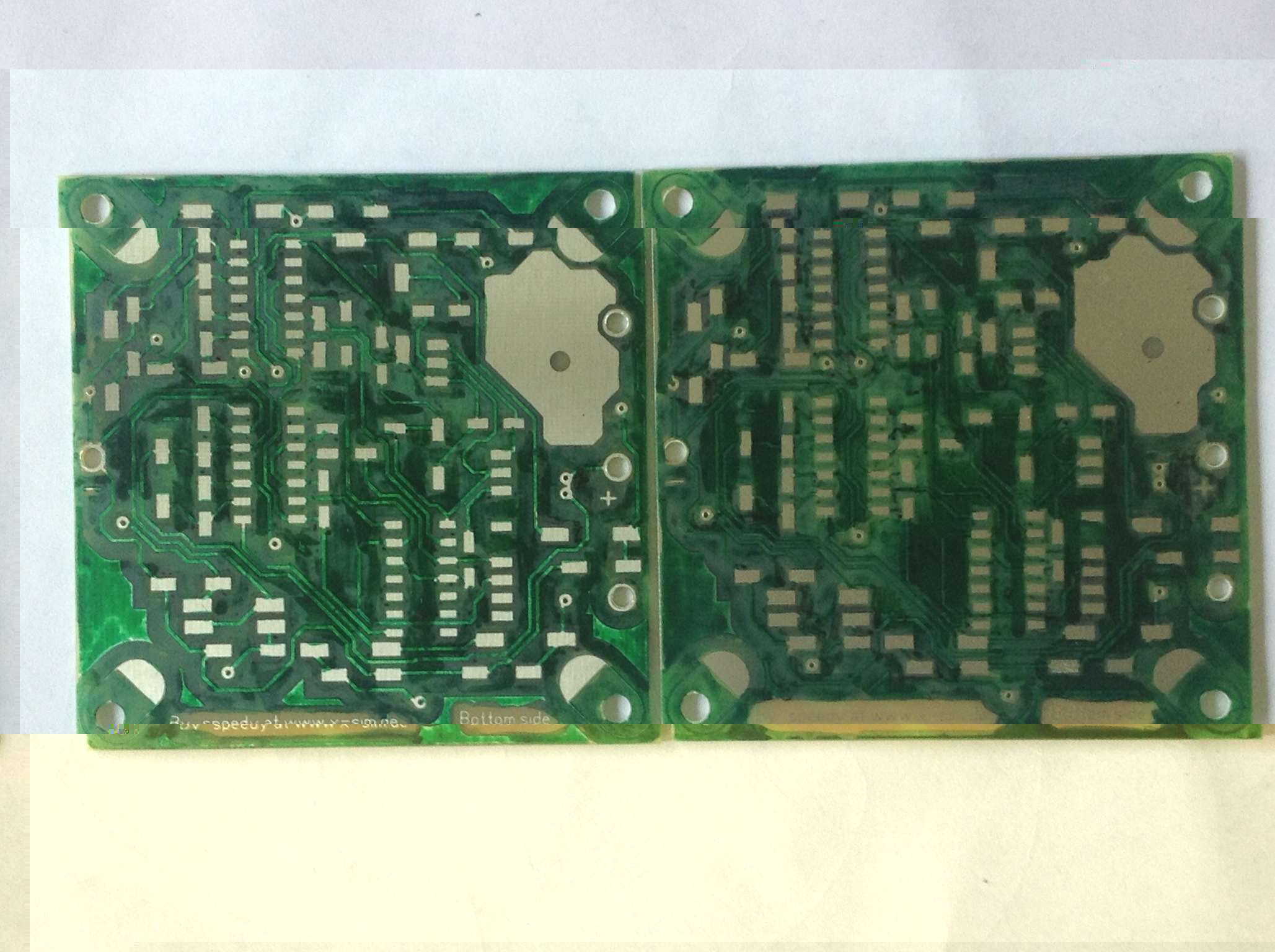

I received today the PCB !
Just have a look at them .
Pcb

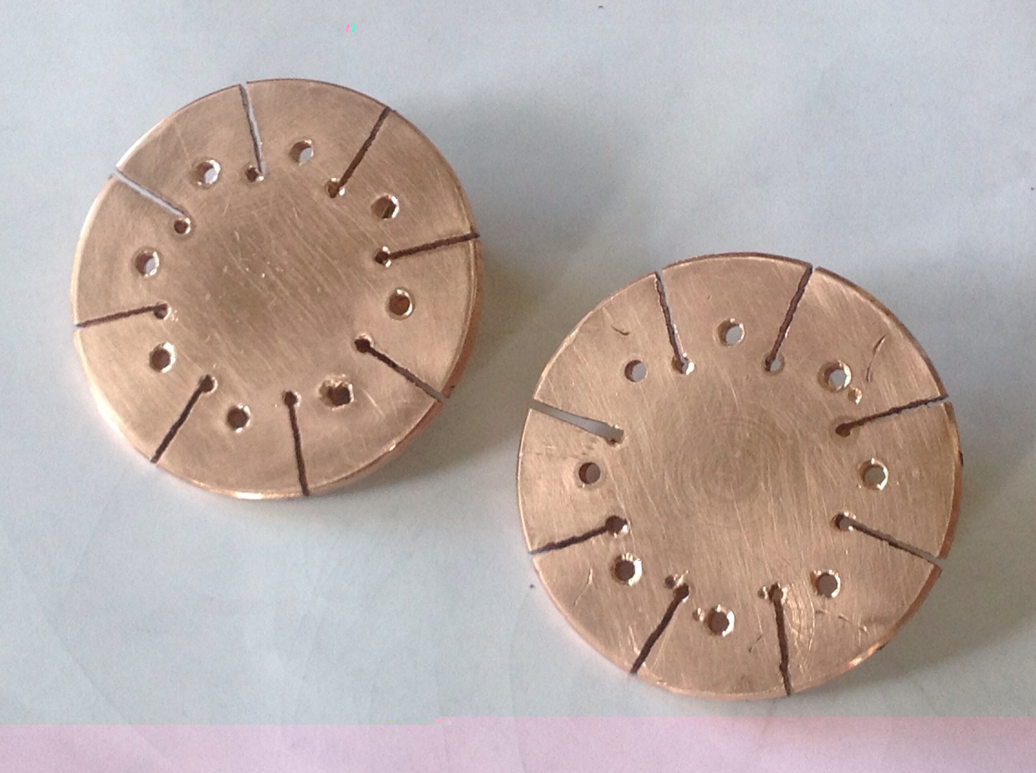

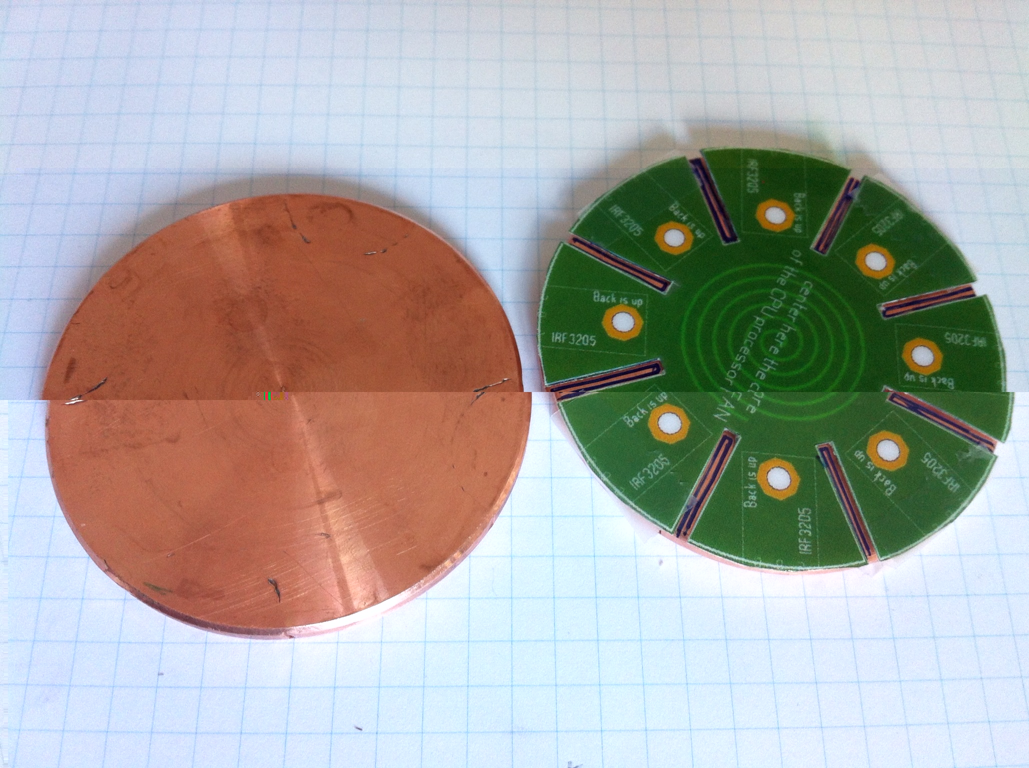

In the same time I prepared the copper disks :
Copper disks

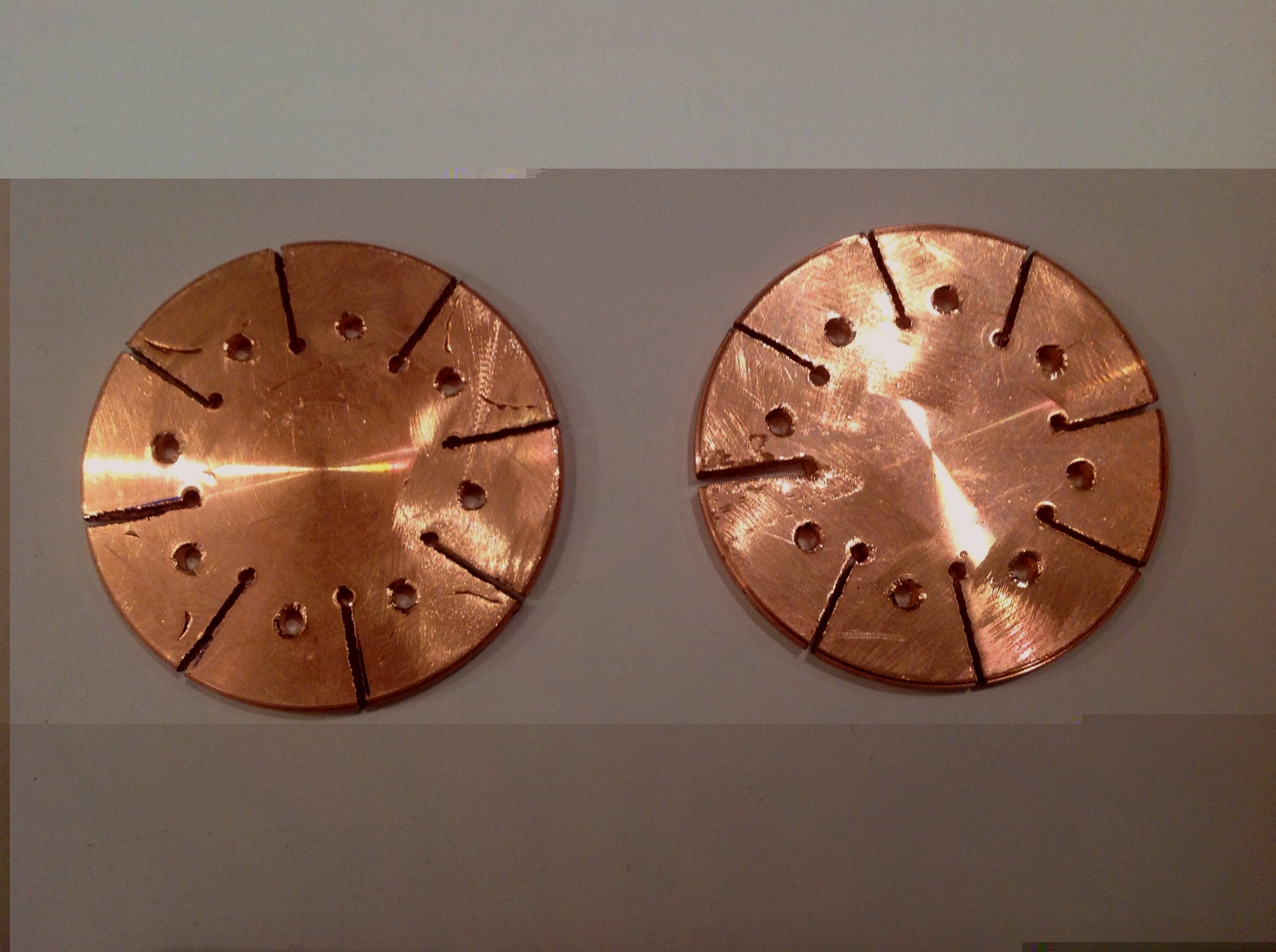

I just finished to drill and cut the copper disks :
Finished disks

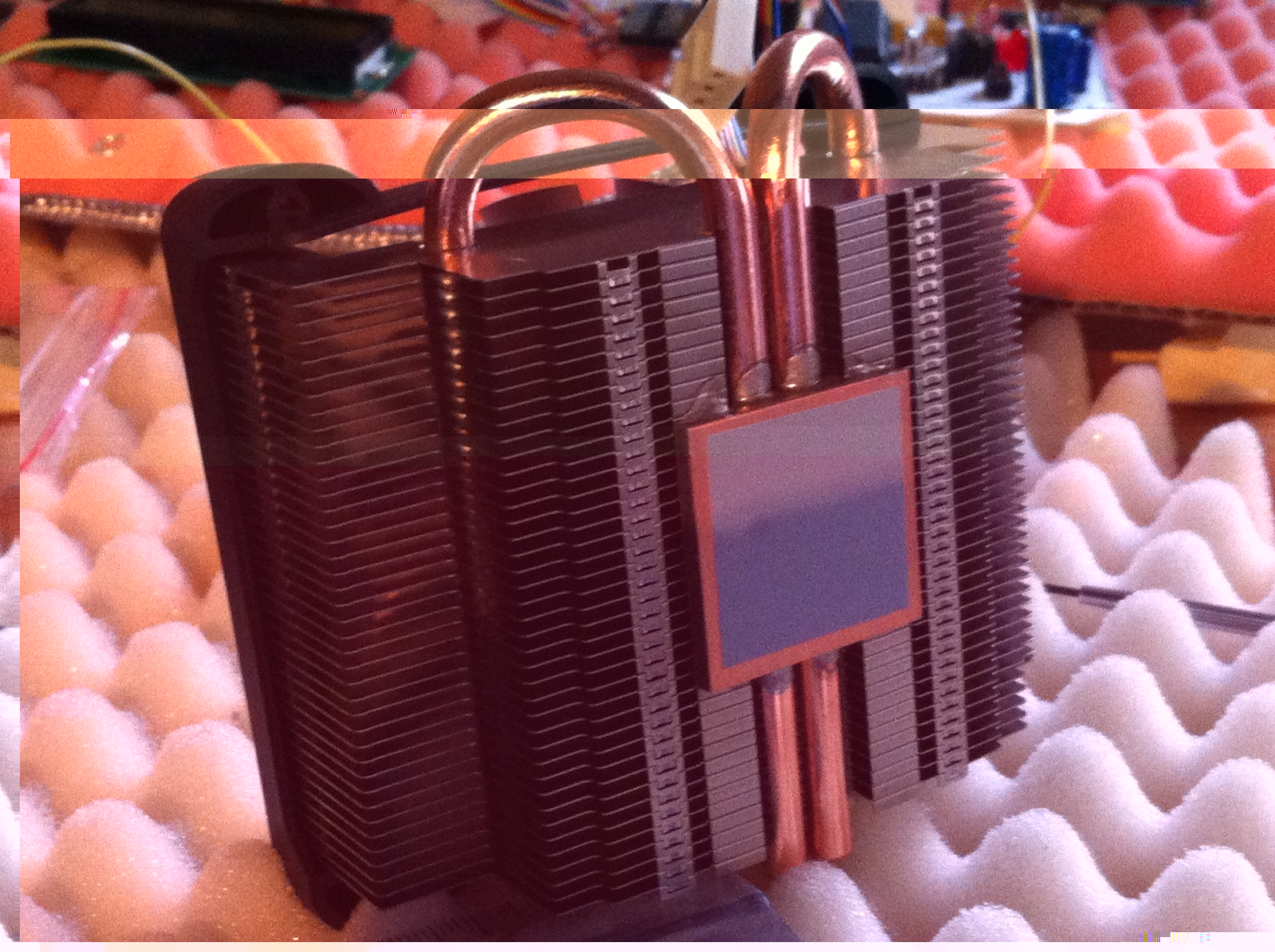

As I said to you before I bought the cpu fans.It costs to me 9€ each so 18€ both.
Cpu fan

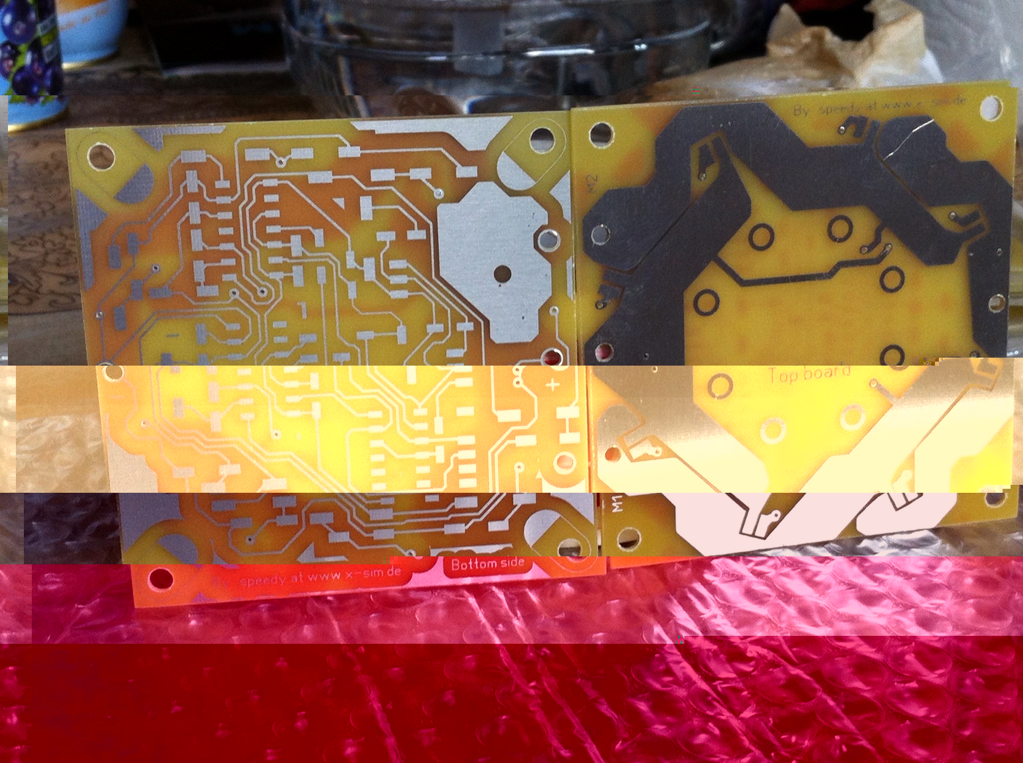

Update:
The pcbs painted ready to solder!
Pcb painted
Copper disks better polished yes my friend ;)
Copper disk polished
