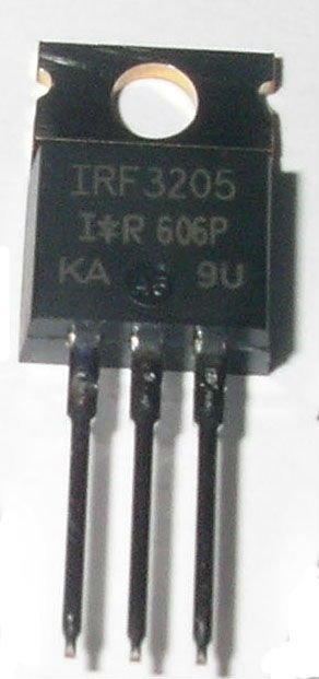

I have been searching an alternative to substitute the IRLZ44N and I found some.
IRL1104 http://www.irf.com/product-info/datashe ... rl1104.pdf
IRL3713 http://www.irf.com/product-info/datashe ... rl3713.pdf
Thanos, do you think that these guys will heat less than the IRLZ44N ?
I wanna do a test, with one of them, I think I will do with the IRL1104 cuz it's cheaper, but if it fry as IRLZ does I will do a air conditioning with a peltier module. If you don't know what I'm talking about, google it !!
What do you think guys !
I'm tired of changing burned mosfets !

kbssa wrote:I wanna do a test, with one of them, I think I will do with the IRL1104 cuz it's cheaper, but if it fry as IRLZ does I will do a air conditioning with a peltier module. If you don't know what I'm talking about, google it !!
I guess that IRL1104 is a great one "MOSFET, 40V 104A, 167W " with a VgsTH min = 1 volt ... or should I say a MONSTER .
BUT If you can find it cheaper than IRF3205 "V-MOS, 55V, 110A, 200W " with a VgsTH min =2 volt ... then you should use it directly ...
and one more thing ... I want you to calculate the wattage of your motor in the full load condition [starting / reversing ] that would help you know better about your heating problem ...
note : different factors are included into power calculation of a motor ... so don't take 200W per MOSFET as a reference of calculations .
regards ...

Postby kbssa » Thu 6. Sep 2012, 18:23
regards ...
Thanks for answering man !
The IRF3205 is a non logic level mosfet, will it works with 5v Vgs ?
If yes, I think I will use it cuz it's cheaper here.
My motors are 12V, 10A max ,120W, I think that works with IRL1104 or IRF3205 cuz it support almost double of current that IRLZ44N supports, so I guess my HB will heat much less, considering that my motor will drain only 10% of current that IRL1104 supports, and I won't need of big heatsinks as I have now on my HB and it is still heating a lot !

Postby speedy » Thu 6. Sep 2012, 19:20
Hi kbssa : ...
sure my friend the IRF3205 works very fine with 5v logical level ... as you can see my hole project is using it ...
BTW ... what kind of motor controller are you using ?
If you're using Tronic-h-bridge [P-channel /N-channel full H-bridge ]... then you'll find that after replacing the IRLz44n with IRF3205 ...
the heating up mosfets will be on the IRF4905 side ... :!:
and every heat generated should be dissipated by a heat sink ... try using some compact ones from the world of the computer boards .
don't kill your mosfets by heating them .
and just an advice ... buy the IR2110 mosfet driver and use only N-MOSFET's with it and save your time and money . :mrgreen:

Excuse me guys ... I'm sorry but to avoid mixing My H-Bridge with Thanos H-Bridge to the readers ... Further troubleshooting every h-bridge will be into it's own forum ...unless asking general questions ... this is really a confusing issue for all of us .
kbssa wrote:Ok, thanks for the tips.
I'm using wiper motors.
I'll try the IRF3205, só as you said it will works good enven without the IR2110 mosfet driver right ??
If not, I'll use the IRL1104, cuz it will fully operate with logic level.
Thank's !!
kbssa ...Wait, you've got my advice wrong. I meant to use this design instead of tronic board .Forgive me I have a feeling that your going to put the IR2110 driving IC instead of the 47HC08 IC on the tronic h-bridge :?:
Pls. don't do that ...
Thanos is the original designer of the tronic H-Bridge and confirmed plus others earlier for replacing those MOSFET's and of course IRF3205 will work better than IRLZ44N that's only what I'm saying ...
but without replacing any thing else on it's own circuit design .Pls. these are different layout and connections .simply they are not the same ... my friend . :lol: Pls. read numbers carefully cause you are mixing between MOSFET's numbers and IC's numbers they could be tricky.
And to help ... here is a short summery :
-MOSFET's N-channel that are compatible acceding from the weakest but working for this h-bridge ... IRLZ44N = IRFZ44N = IRL1104 = ...many numbers... = IRF3205 .
