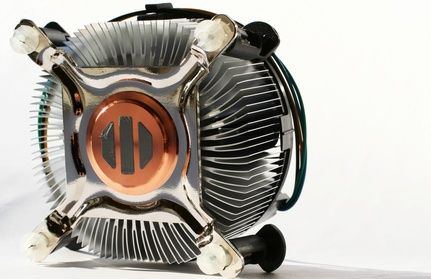

AND ... here is some tips for preparing the copper disk I would like to share :
- First , please don't use aluminum instead of copper [ someone asked me for that ] and I'm telling you heat moves fast through copper .
- After finishing the board and the drilling s don't solder any thing yet . :!:
- 8 MOSFET holes in the board should be drilled first ( use 3mm bits ).
- put the disk and the board together against strong light source and center the copper disk to the 8 holes .
- mark these holes onto the disk with a pencil .
- use the same size drilling bit 3mm and complete the 8 holes for the copper disk.
- use a pencil and mark a big circle of 3cm diameter at the center of the disk .
- using a metal saw to make slots into the disk starting from it's edge till the 3cm circle marked edge ... center these slots between the holes drilled before ... [ see picture ]... slots will help directing the heat generated from each mosfet separately to the center of the disk to the attached CPU cooler above it ... keeping other mosfets cooled as it is . :)
- then there you go ... continue install every thing else to the board ... when comes to mosfets just bend the legs forward to install there writings faced down to the board and the metal back is up ... and to attach them to the disk [ not the board ] you may wider the board holes to use the screw driver through them from the back side to fasten the bolts .
- use a thermal isolating sheet and some heat compound for each mosfet to ensure a good heat conducting .
- the easy part to attach the fan with the heat sink and centered on top above the disk [ use heat compound ] and attach fan wire to it's socket .
that i guess explains my idea for cooling the extra heat generated from mosfet when operating and keeping them within the operating temp .
guys in the computer hardware field would know how much is the cooling power of this CPU fan and it's heat sink .

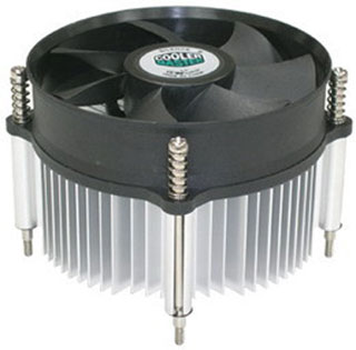

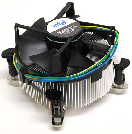

Here is some more photos of some regular CPU cooling fans which can be found around almost any where w.w .
more power and working hours needs more cooling capability and stability .

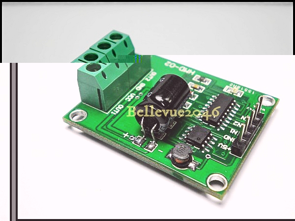

For comparison you can see how small they can make a similar h-bridge like yours using SMD parts (for single motor though):
High Current DC Motor Driver Module MOSFET control

BTW ... I can see that you still like eBay .
how about buying one of these and test it for us ? can you do that ? pleeeees . :D
_____________________________________________________________________
Don't do it ... :x I'm joking :mrgreen:
[edit : OMG ... you actually did it .. :shock: ]
I suspect it can handle [90A DC peak = car battery ] ... no way :twisted: look at the back small mosfets installed ... only four of them ... and current limits for this kind of SMD MOSFET's packaging proves it ... [they cleared the MOSFET's numbers ... but the MOSFET's itself still there ] :lol: :lol:
and due to the size of components I'm forced to use , then clearly I can't defeat SMD boards in size ...

Yes, as you seen here, I already got that motor driver and tested it. It was a little failure but I think it may been just the specific driver already damaged or material failure during its production. Nothing that can be seen with a simple power-on test that they perform.
Anyway, I'm testing now the other dual motor driver and passed all my tests with flying colors!!! I was just taking a break before I made a video about it. It has 4x BTS7970 chips on it and an 74LS244 for signal conditioning.
The mosfet's can provide the same power either in SMD or TO220 package. The actual transistor silicon die in them is pretty small! They just add more copper around the junction to allow more current or better heat distribution. On that cheap motor driver they scratched the mosfet's numbers so others can't copy their design, its a normal tactic for many circuit manufacturers to try to make it harder for industrial espionage reverse engineering.
