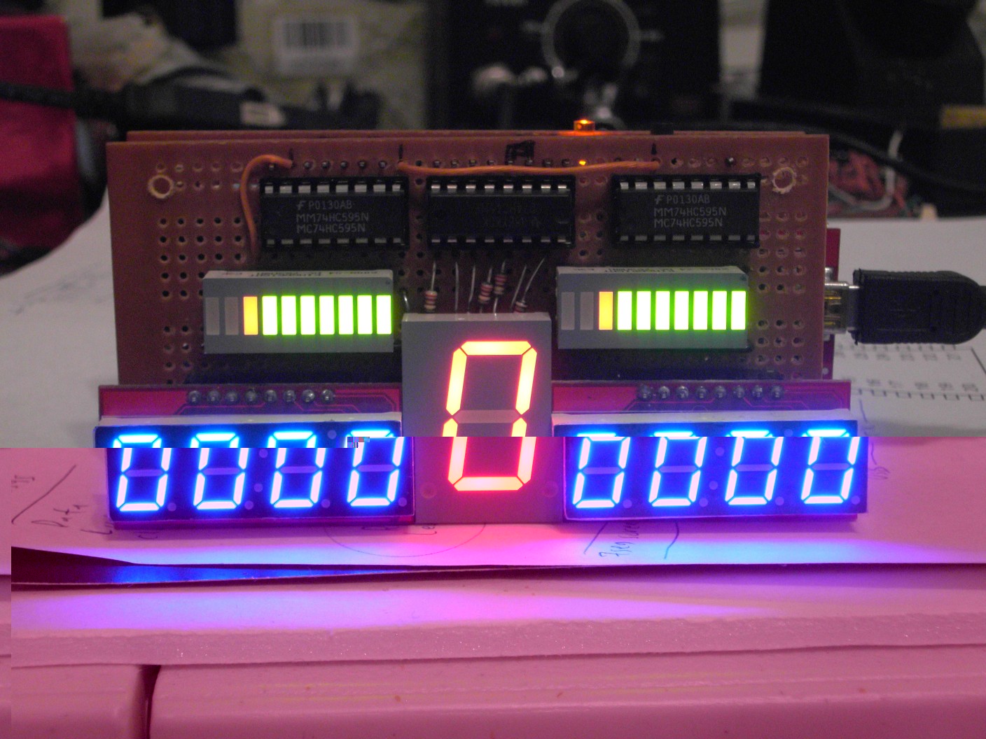

My attempt for f1 dashboard with atmega644 and custom built boards

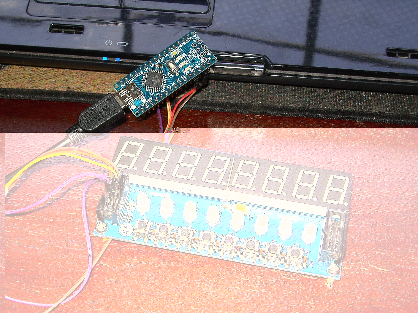

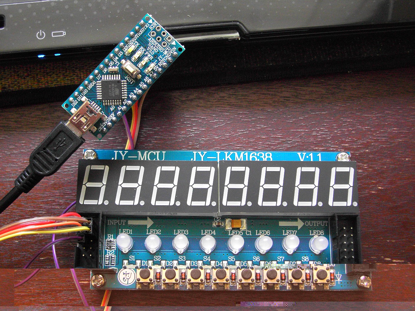

About a month ago I discovered those neat 7segment displays based on the TM1638 chip
that are incredibly cheap and its layout is very close to the one I wanted. You can see them
here: http://www.dealextreme.com/p/8x-digital-tube-8x-key-8x-double-color-led-module-81873
To drive the display and connect it to x-sim through USO interface I used a also cheap Arduino module
compatible with Arduino Nano. See it here: http://dx.com/p/nano-v3-0-avr-atmega328-p-20au-module-board-usb-cable-for-arduino-118037
So the total cost of this project is only $19.98 !! :D
See it in action here:
And here a new video different camera:
And here with two TM1638 displays, were the second displays the PRM as numerical.

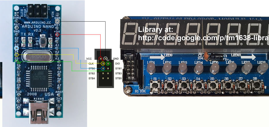

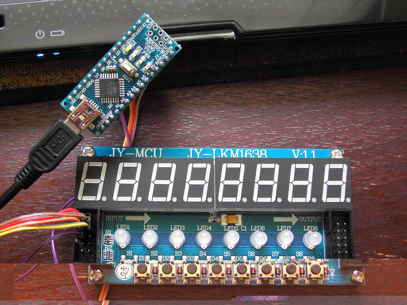

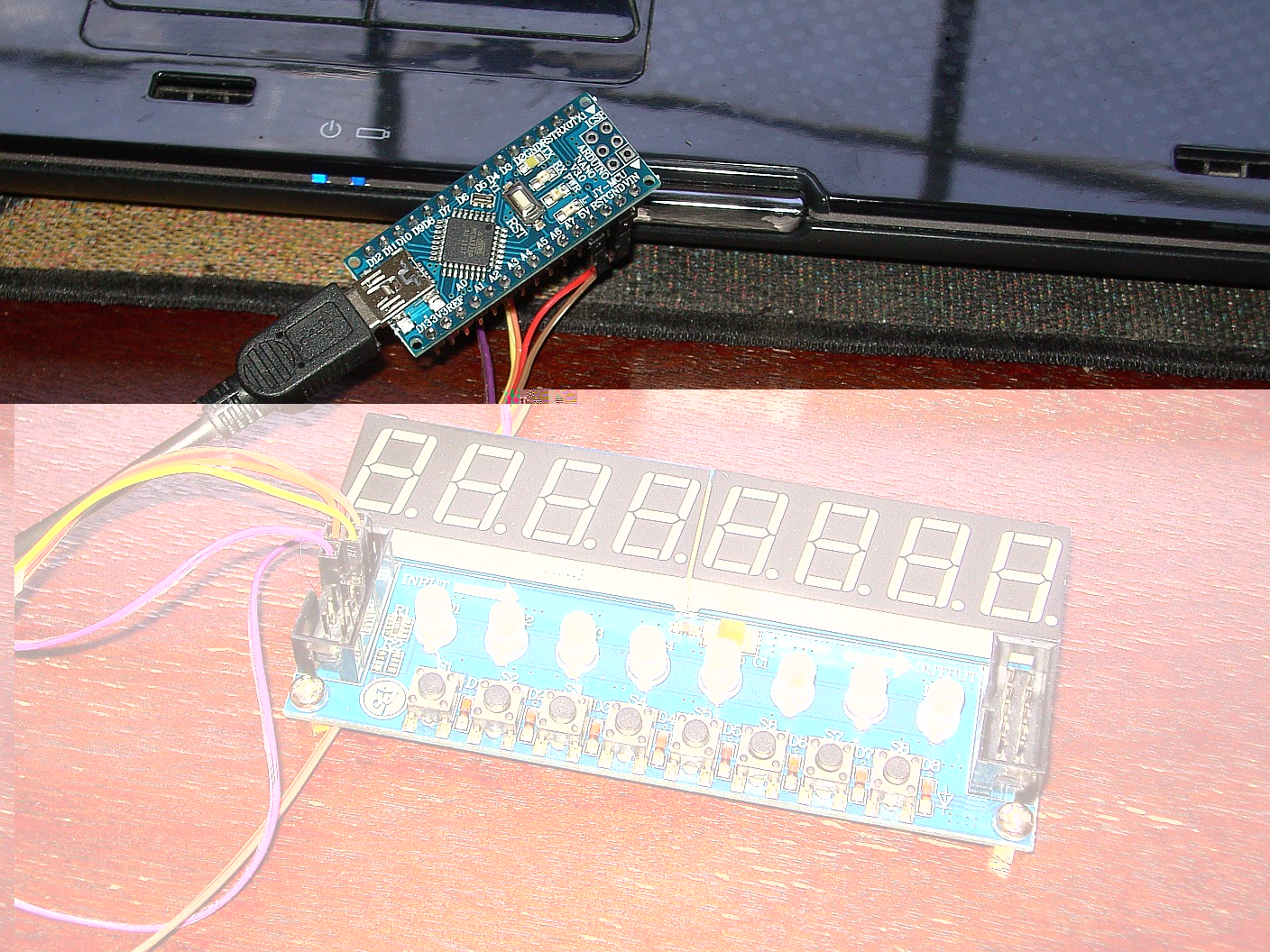

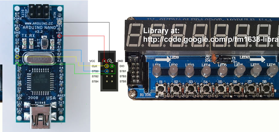

The wiring is very easy:
Prodigy's schematic (thanks Prodigy)

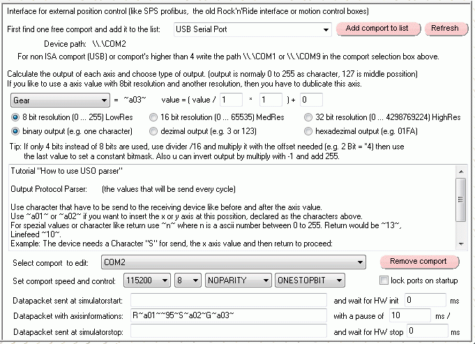

The serial parser can be for example: R~a01~~95~S~a02~G~a03~
Where:
~a01~ is 16bit value for rpm
~95~ is data value parameter for RPM_MAX divided by 100 to fit into a byte so actual value is 9500
~a02~ is 16bit value for speed
~a03~ is 8bit value for gear / neutral / reverse

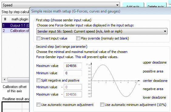

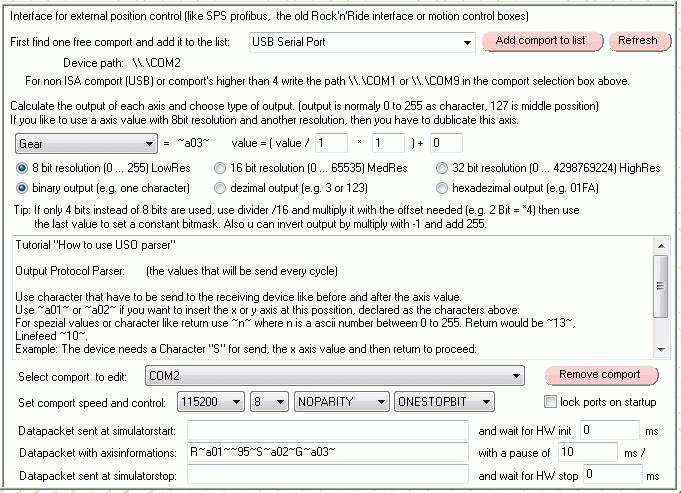

Here is the saved profile that contains the math and the axis definitions for the rpm/speed/gear along with some photos of the settings.
x-sim3dashboard_lfs.zip
(131.81 KiB) Downloaded 5034 times

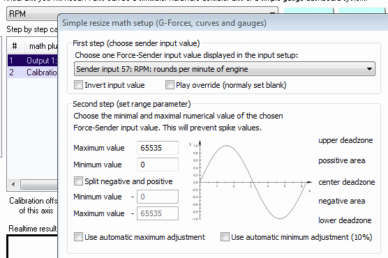

See here the 16bit setting for rpm (same for speed)
And here the 8-bit setting for the gear

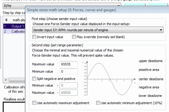

The max math value for rpm

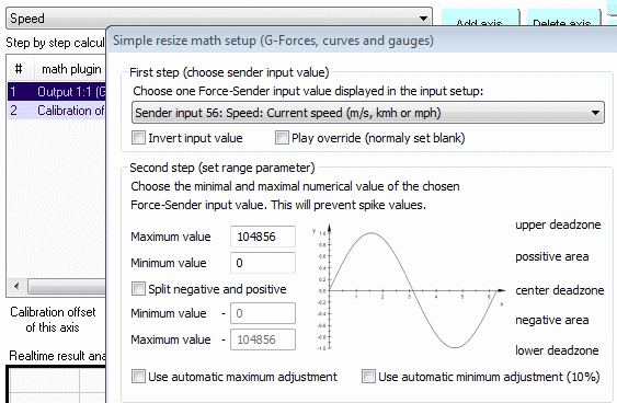

The max math value for speed
And the max math value for gear
The above video of a modification by vicpopo--> http://www.x-sim.de/forum/viewtopic.php?f=40&t=155&start=30#p5495

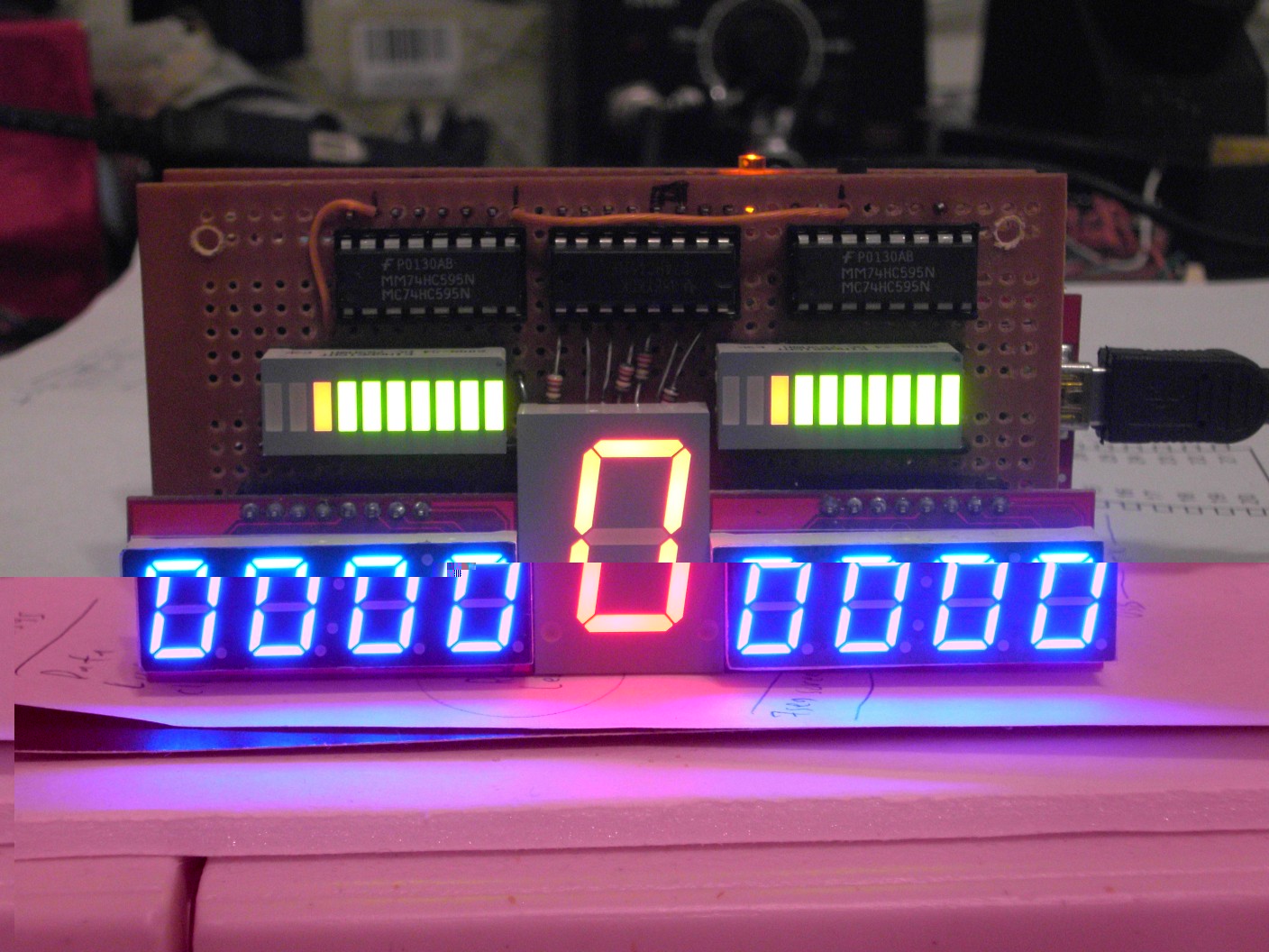

Newer version with bigger Gear Digit!
Re: Digital dashboard with TM1638 and Arduino Nano v3
Postby jessemoraes » Tue 17. Jul 2012, 14:14
Hi thanos
sorry for the noob question but,
could you explain how to wire up the arduino with the display?
and , can i use the arduino uno for this?
cars
jessemoraes
Joined: Tue 17. Jul 2012, 13:21
Location: dublin
Postby tronicgr » Tue 17. Jul 2012, 15:32
The wire connections are in the code. Any arduino is compatible!

If you have some time I'm interested in realy understand how did parameterise xsim for displaying the right values on the display , for exemple the value for the calibration offset in Math setup for the Speed - 2147483648 !!??).I just noticed that if you change this the speed displayed is wrong !! :o
For the europeen driver which would like the speed in km/h and not in mph just change the maximum value in the extractor input from 104856 to 65154 .You didn't give this information Thanos I believe.
65154=104856/1,6 with 1,6 the rate between mph and km/h.
