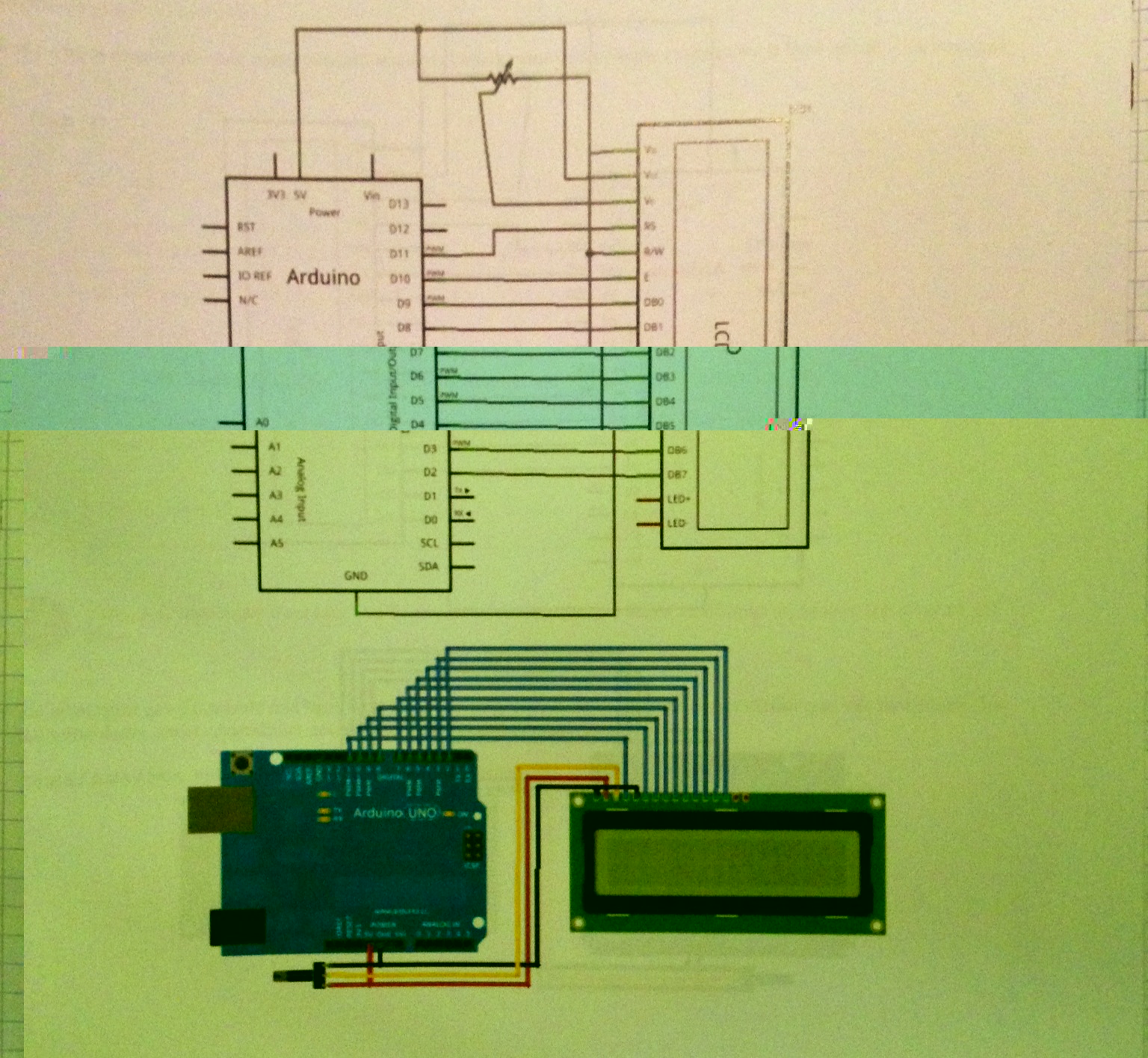

This is the arduino and lcd wiring schematic ( just mising the pin13 to check the data ON with the led and I connected the lcd backlight GND and 5 volts to the 2 left pin available on lcd 16x2)
Wiring diagram

ELM standard is 9600, the extractor can setup higher rates. There is no technical delay and the values are read as they are in the game.
OBD2 serial speed is auto handled by the ELM, after the ELM (our connection) we have standard RS232.
Is a LCD liquid slower?
Will add now the new values to OBD2 ...
Re: New!!OBD2 Com with Xsim3 and Arduino-New!!
Postby vicpopo » Sat 13. Jul 2013, 10:54
sirnoname wrote:ELM standard is 9600, the extractor can setup higher rates. There is no technical delay and the values are read as they are in the game.
Yes ,lcd a little bit slower,thanks for new values! ;)
