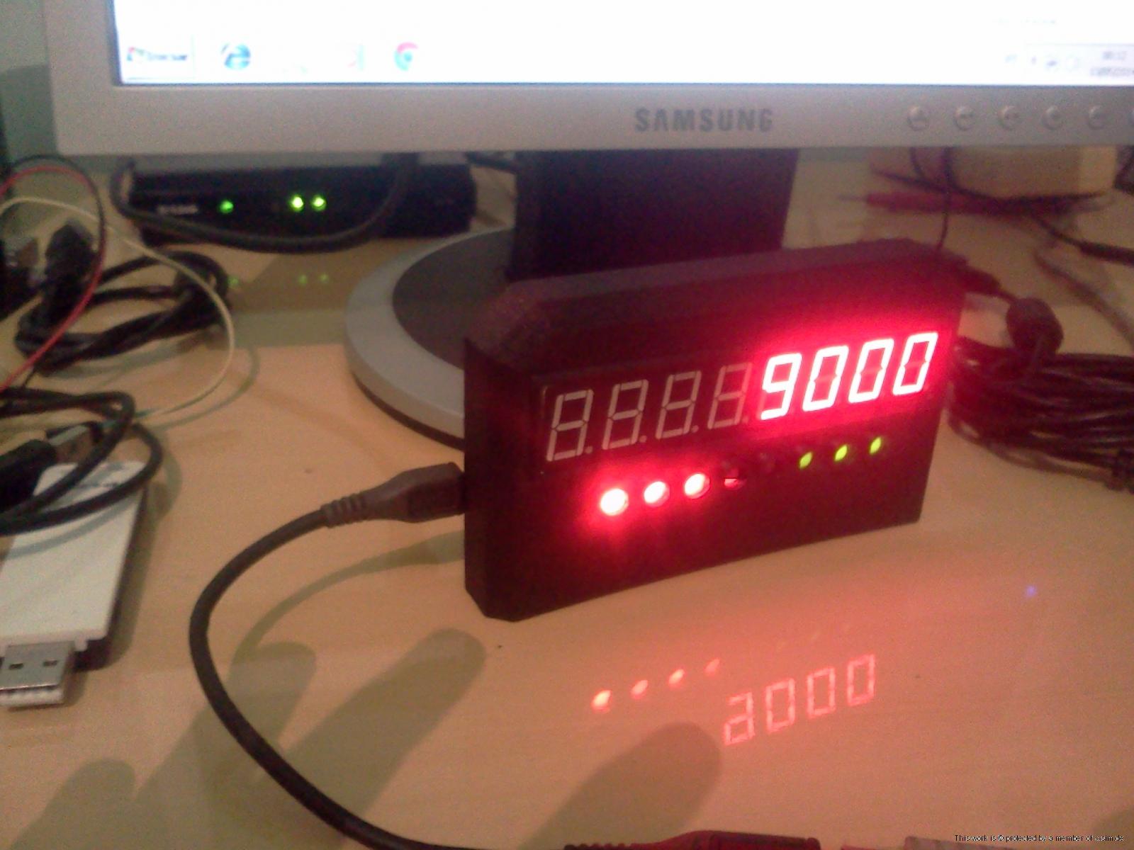

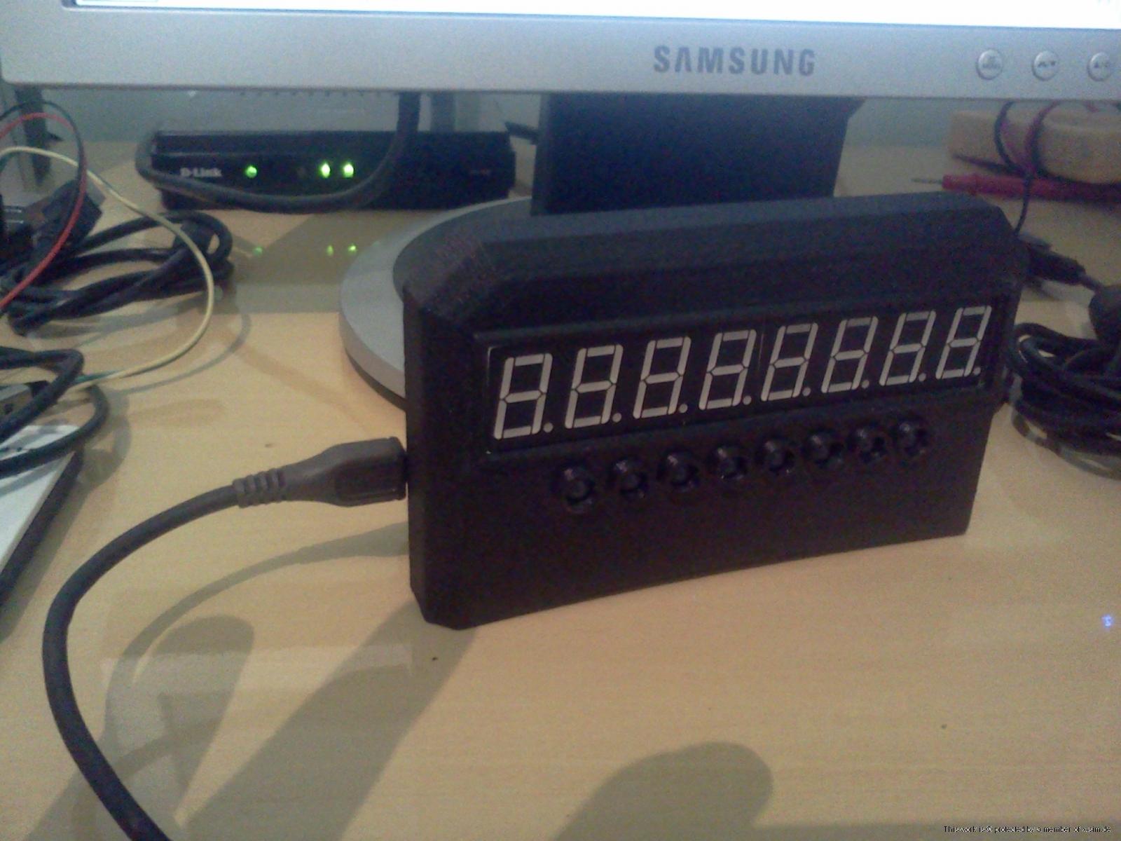

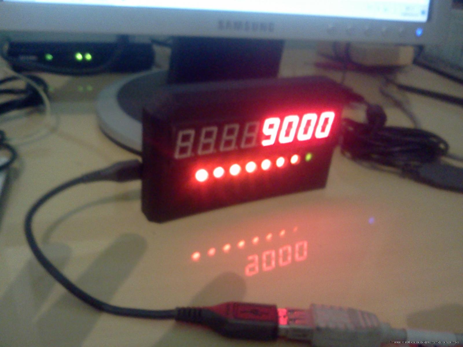

Also added some pictures of the finished result. Shiftlight is a red superflux LED from car braking light with a led prisma from ebay. Pot is to adjust at which rpm shiftlight turns on and ofcourse button for max rpm.
Again thanks to everyone who helped me and worked on this project.

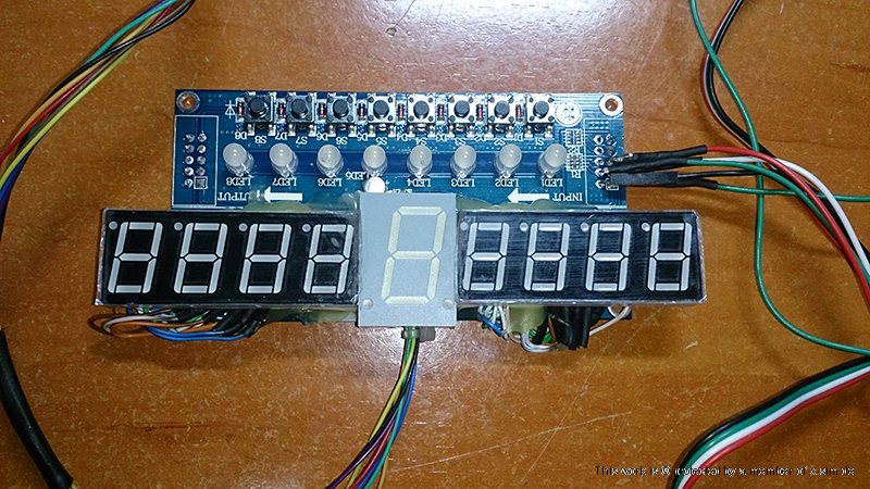

Hello friends!
I want to share my display. I remove the two 4x7 segments (with a heat gun) and insert at the middle the big 7 segments display. Then, i weld four wires to each 4digits displays and paste again to the plate with glue (heat glue). In the back of the palte i put the arduino and the circuit to drive the big display. For the buttons, i only weld two wires to each button from the back of the TM1638 plate.
At level programming, i change the code and use the invertedTM1638 module (include invertedTM1638.h and define the module as invertedTM1638) to show the digits inverted. All works really good!!!!!!!!!!!
Display
2558

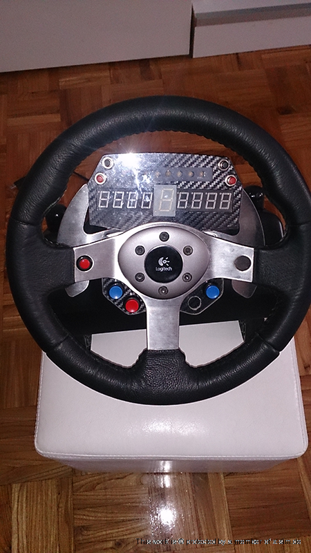

And integrated in the wheel
2559
Thanks to all members!!!

Postby vicpopo » Thu 13. Feb 2014, 20:02
Really good job and good looking.You made your own SLI display and cheaper.
Could you share your code for all other membes ?
Thx ! ;)
Re: New!!OBD2 Com with Xsim3 and Arduino-New!!
Postby profetadelmus » Thu 13. Feb 2014, 22:20
My code is basically a mix of various codes published here. The only different part is in the includes and the declaration of the inverted module.
In fact, at this moment, i only use the buttons for changing the rpms. I have study last post to acquire position and other obd2 info

Postby kbssa » Tue 13. May 2014, 05:36
Hi all,
I came to show you the dashboard that I am developing.
2845
2846
2847
This dashboard fits like a glove on the G27 and I will use double-sided tape to stick on the wheel. (more pics in few days)
For testing I am using vicpopo's code, but I will make my own and add all functions that the obd2 can provide.
To be easier to change functions,joystick buttons will be used.
When I get it working I come back to show you the results and post the code !!
Thank you to Vicopoco and Sirnoname that pointed me to right direction !
Sorry for my bad english.
Bruno
