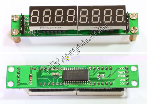

Hi Everybody,
Can I use this module (MAX7219) to replace TM1638 module ? because I can't buy TM1638 in my country !
thank you very much .

Postby vicpopo » Tue 10. Mar 2015, 13:47
Hi ,
For me no problem to use max7219 instead tm1638.Just keep the code to get the value you need from obd2 protocol ( speed , rpm , gear ) and adapt the code to display the values choosen on your display.
Just look after the library for the max7219 and adapt the code according number digit format.

Postby cubizme » Tue 10. Mar 2015, 14:46
vicpopo wrote:Hi ,
Big thanks to vicpopo,
I do not know anything about electronics and programming, so can I use this code for this module MAX7291 ? and how the wiring to MAX7291 module ?
Sorry for my bad English .
Thank you !

Postby vicpopo » Tue 10. Mar 2015, 22:24
Hi ,
To use the display with max7291 you have to learn a little bit programing or ask around you someone who knows arduino programing.
Sorry but can't take time to do it for you .
The thing I can say is that isn't too difficult to program with big motivation. :)
Sirnoname made for me the most difficult part of work making the code fir the comunication to get all desired values like speed rpm or gear.
