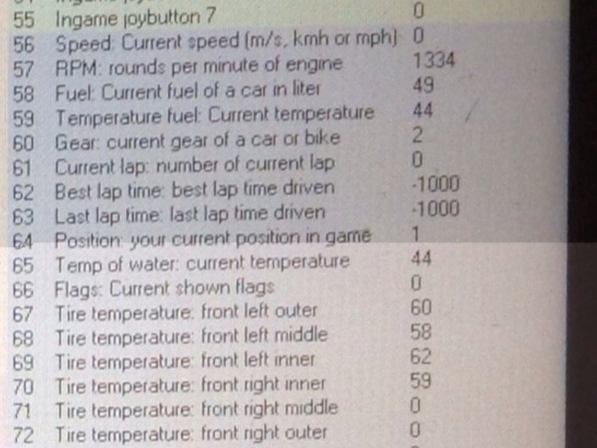

I not tested yet the laptime with the arduino code.The only thing I noticed when checking in input values menu on converter is that during the first lap just the value -1000 sent.After one lap drived the value laptime began to be counted (game gtr2) .

The value of laptime can be seen in "input setup",so I think it is supported.

I didn't yet tested but below my proposition to proceed :
1- As I wrote in a previous post you have tu drive one complete lap before showing current lap time counted .The first thing is to check in input menu that the current lap time will change form -1000 to numerical value . I didn't remember which data format but in thousands (32 547?) .Write both values the one in input value and the one in game display .After you can calculate the data format.
Sirnoname wrote that the 2 word 4* ** 00 00 the last two words represents ms .The thing I not checked is if this value is the difference or the total current time lap.
Exemple : you finished a lap and your time is 1min 42 s 23 43 ,
that means that the value in ms is 102 234 ms or 01 8F 5A in Hex .There are 3 words not 2 as the pid give.
That the point I 'm with ths current time lap.
