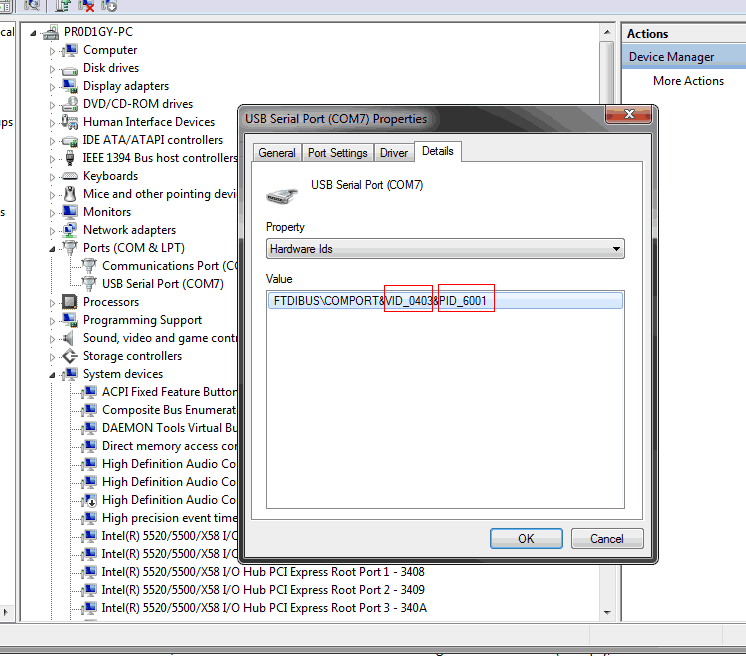

prodigy wrote:After a lot of messing around with that Nano, restarting computer 100 times, reinstalling drivers, X-Sim, soldering pins, I even put a capacitor and successfully disabled auto-reset but that didn't help with comport error in X-Sim. Then I went to my brother's place and tried the dashboard on his computer and of course, everything worked just fine there and then I went crazy :D

Prodigy, I'm having the same issue as you. A question: Can you tell me how to identify both vendor's ID & product ID?
Edit.
Already done the whole procces with no success. Nano works fine until tm1638 is plugged in it. Just then, com5 port disappears and device manager shows an "unknown device".

A few days ago friend of mine had same problem after reinstalling windows, even my procedure didn't work at first until I've downloaded and installed older drivers. On this page http://www.ftdichip.com/Drivers/VCP.htm those are drivers at bottom, version 2.08.24.
Then try following my procedure, remove drivers with tool, usually the tool automatically founds vendorID nad productID, and then you need to press ADD and Remove Devices. But if you want to know your VendorID go to Device Manager, find USB Serial Port and double click it, see this
Also try plugin it in back side USB slots of your PC, or try another USB cable, sometimes the cable can be problem.

Hi Prodigy. I've done like you said and installed 2.08.24 driver version.tm1638 is now working fine. Tnx so much.
