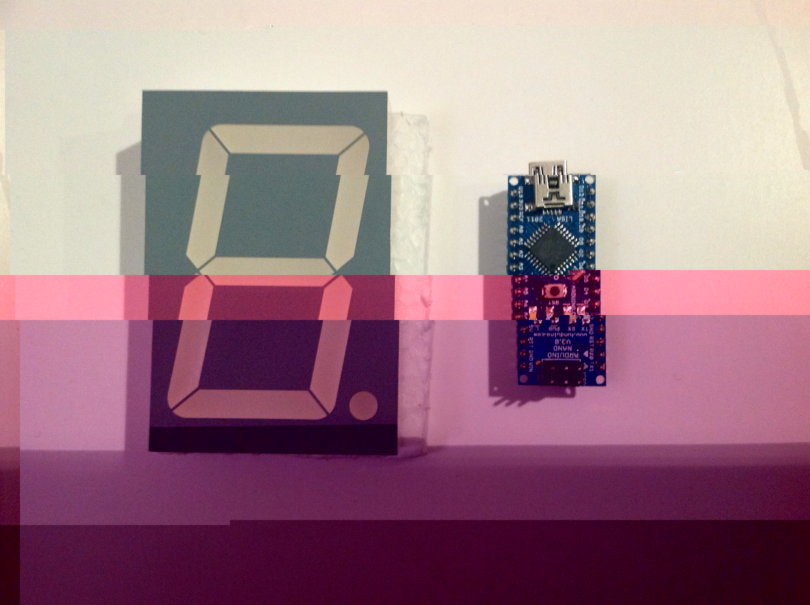

You can find attached a video showing the tronicgr dashboard.Tronicgr helped me to change the code (I worked on the code a little bit also ;) ) ,because i would like a big 7 segments display for displaying the gear.In this video you will see a little one because it's for testing .
The gear display has a big size , see the photo from it near the arduino nano!! :lol:
The last point ,but not the least, is that I would like to display on the tm1638 the speed near the rpm.
After a several tries I achevied a good result with Thanos help.
I will poste the code after removing all things unnecessary .I will post the shematic also because I used a decoder MC14543B for the 7 segments display(only 4 digit for displaying from 0 to 9).One thing is missing is the neutral "n" and reverse "r" that I still can't display ,but I 've got an idee.Just for,information the code works with 125000 bauds and 1 ms in uso parser.
Size 57 mm high

Yes I did.As the decoder BCD could just display figures from 0 to 9 I use 2 another arduino pin that I drive for displaying the Character "-" for neutral and "r" for rear . I needed also 2 more digits , I put one in high level for neutral - (segment g) and I put both to high level for reverse ( segments e and g)

Below you will find a zip file .Inside I recorded the arduino program in txt ,the wiring schematic and the datasheet for the display.
I want to say a few things:
- the big 7 segments display needs 8 volts , I supply it with 9 volts.
- I took a litlle PSU from a device 12Volts that I didn't use anymore ( that was a phone charger or something else I didn't remember or a psu from,a toy from my children)
- the arduino nano V3 can be supplied with this voltage without problem when using the Vin input.It has its own voltage regulator.
- I made a little pcb to solder all the components
- resistors are 220 Ohms ( R= U/I = 8 - 1,5(forward voltage) / 0,020 A) and I pluged 2 capacitors in and out from the regulator 100 micro Farad)
- I don't know if diodes are usefull but it works with them so I left them (I didn't test without).
Beware: I made peharps a mistake , check twice if you use it and contact me.
