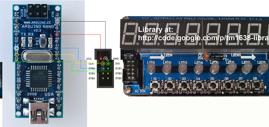

I've ordered the two component for dashboard and while I'm waiting I just want to check if this is the proper wiring for Tronic's code.
Code: Select all
// define a module on data pin 5, clock pin 4 and strobe pin 3
And how do I include the TM1638.h file? Donwload it and put it in same folder where *.ino file with Tronic's source code is?
It's impressive how Leo Bodnar's SLI-PRO dashboard cost's 160 $ and this version cost less than 20 $ doing almost the same thing, except for button connections.. Nice find Tronic! 8-)

Hi Prodigy ,
For wiring I think you are right . Just test after compiling the programm.When you download the library on the internet page it given where to put it.It's into library arduino program I believe.
It's quiet easy !!
I just had problem when compiling the program because I didn't choose the right arduino module in the list that the program was proposing.After this littl mistake everthing had perfectly worked.
