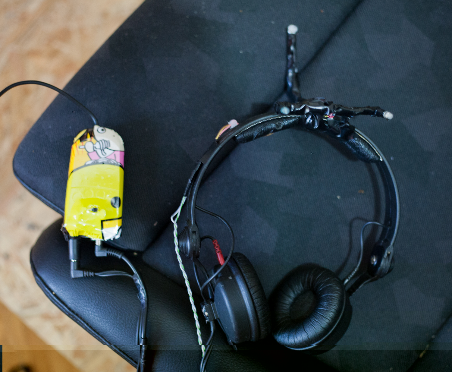

Postby Tombo » Thu 1. Aug 2013, 13:54
i think you misunderstood something. In the Free track programm at camera settings i can zoom with the webcam. So the video frame will only around my head not the whole room. But when you zoom to much minimal head movements will detectet. But you can figure this out in the options.

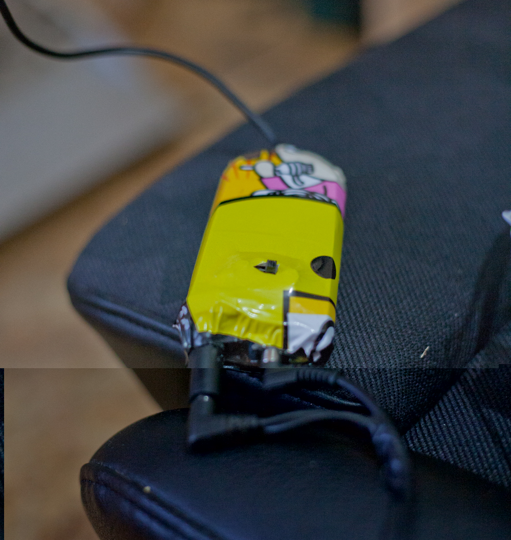

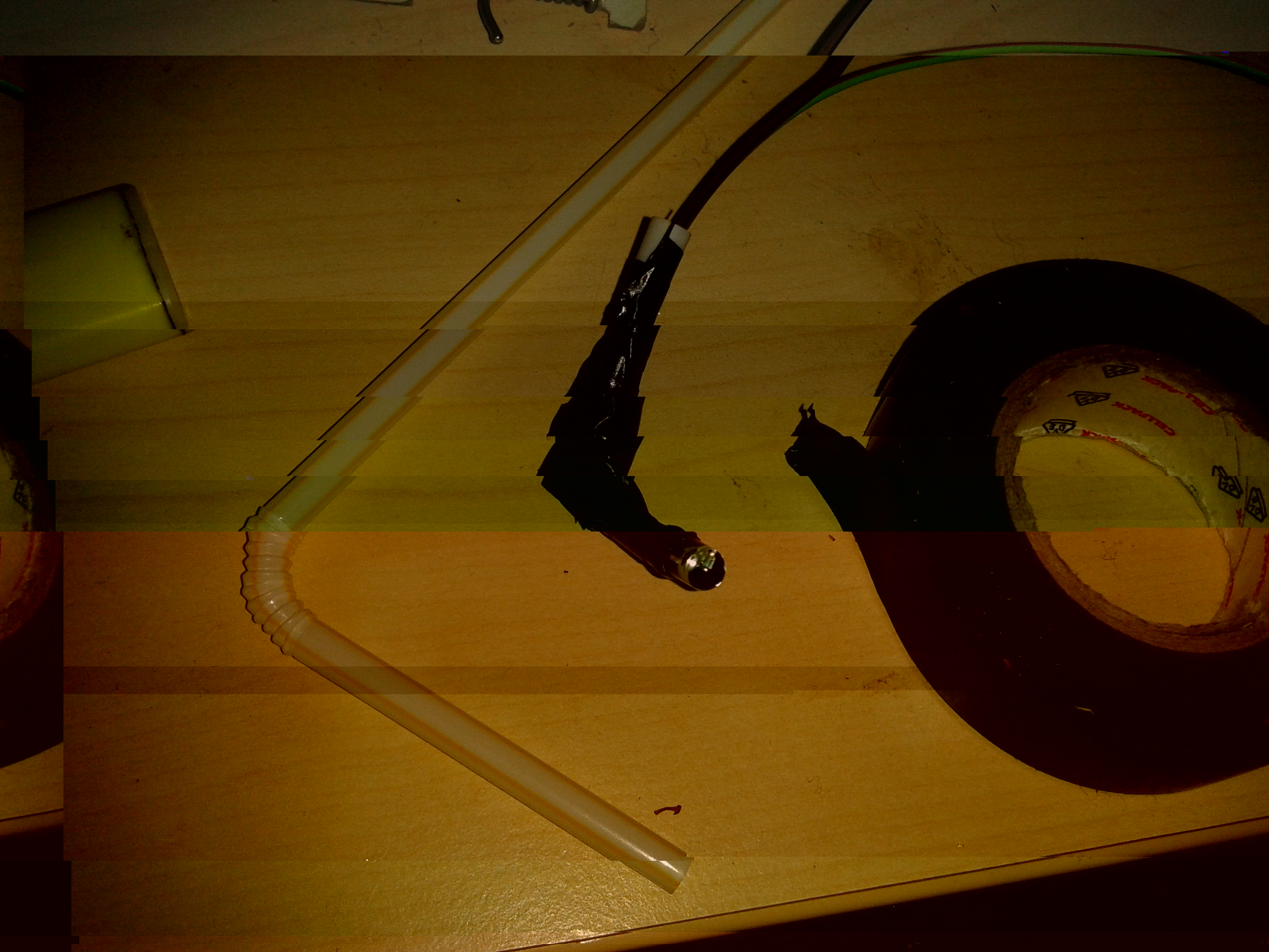

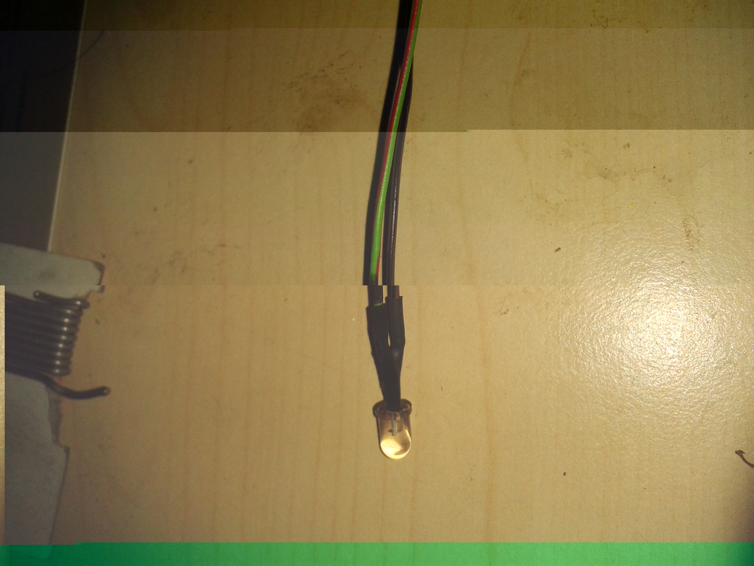

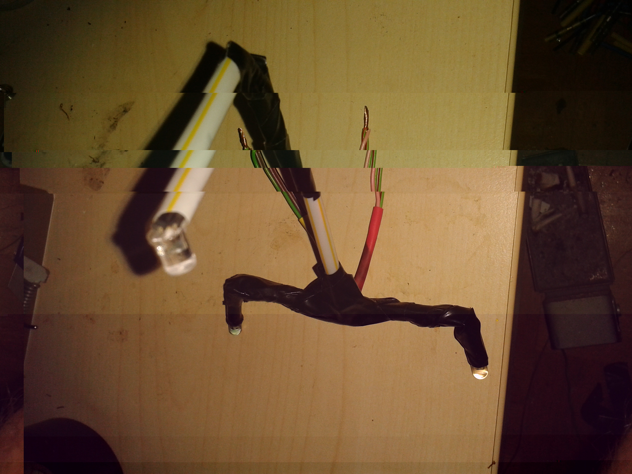

Now i had some time and the materials to build the 3 led Model. It is very low budget just 3 old remote controls some wires a switch and drinking tubes. This works much better then the 1 led Setup.
Edit:

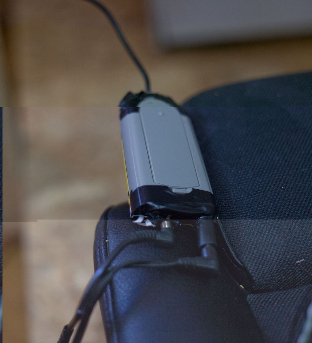

Today i updated it a little bit. I just cut the half of an remote control to have the holder for the batteries, included my 3,5 mm soundwire and solderd a 3,5mm plug after a switch to the batteries. I put a little bit of foil on top because it looks a little bit better than the holes from the buttons from the remote control. Maybe next steps are to put a volume control and power led in the box.
Kevin just read you can't getting it to work with Dirt 3 just search in google for "Trackir Fixer". This program must to be run to get it work with Dirt 3. For Rbr there is another Programm.
Edit again:
Had some time to write a tutorial hope it helps you.
Free Track.pdf
Free Track Tutorial
(3.87 MiB) Downloaded 1799 times
