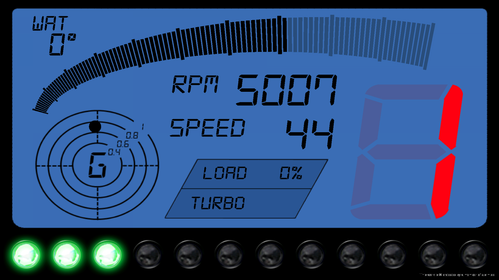

I was confused seeing the image of OBD2 hardware and I thought that you had to connect to the pc .... anyway I tried setting the com 7 and I do not work and perhaps a driver problem of my card .... redo the blutooth process all over again

Postby kevin123 » Sun 14. Jul 2013, 21:44
It works great! then with Racing Torque Meter plugin for pro and a show ;)
1812
Sirnoname thank you very much
