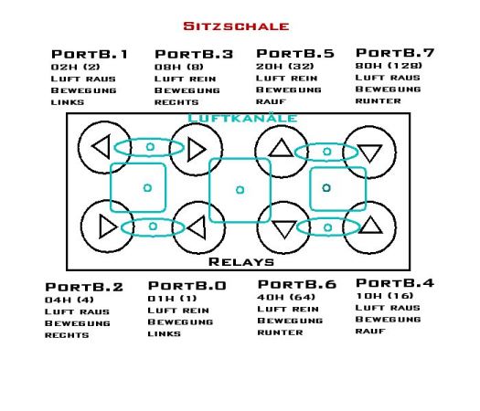

A little bit old but a nice project to increase the movement of the Rock'n'Ride chair. This is a special designed USB interface to control all eight valves of a 2DOF pneumatic valve isle. The difference to the standard rock'n'ride interface is a speed controlled movement with short pulsed air throughput. With a special designed open and close sequence it is possible to move the pneumatic cylinder slowly without breaks and micro stops. This will increase the positioning of the old interface from 7 positions per axis to more positions and a smoother movement. Compared to a electrical solution it is of course not good enough.
What you get:
- 2DOF control of a 8 pneumatic valve isle (based and similar to the Rock'n'Ride chair)
- pulse mode valve control for speed control without a analogue pneumatic valve
- plugin support for X-Sim with automatic detection

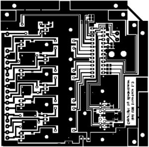

- knowlege about how to edge this board
- knowlege for soldering, especially the SMD parts

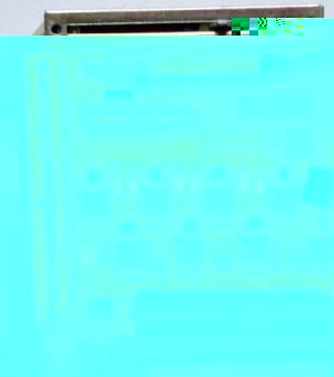

The valve isle of the Rock'n'Ride:

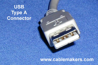

USB cable:
On the 3-5m usb cable you have to cut and remove the B-side and you have to directly solder the cable to the board.
The left over connector is therefore:
The connection to the board is as follows: (see the layout picture above because it is mirrored):
Top = Black (GND)
Middle = white
bottom = green
Some cables do switch green and white if they are not USB certified, simple switch the if the programmed chip is not detected.
And here is a 1:1 layout to edge, the part list and the firmware hex file.
