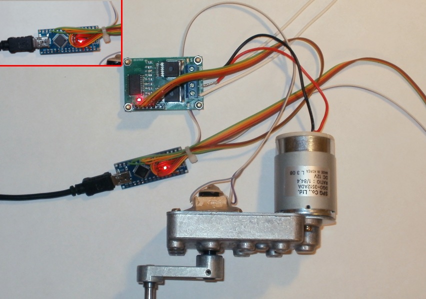

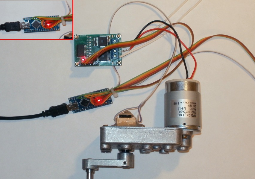

A setup with a arduino uno (top) and a nano (bottom)
For the test setup I decided to use a smaller motor.

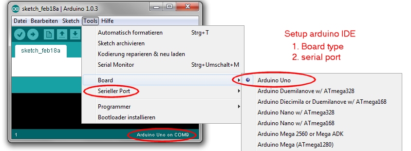

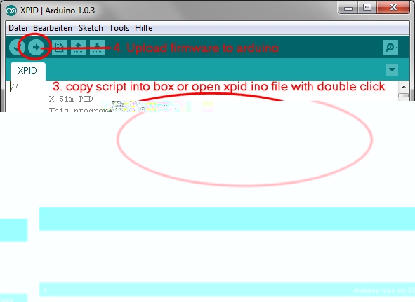

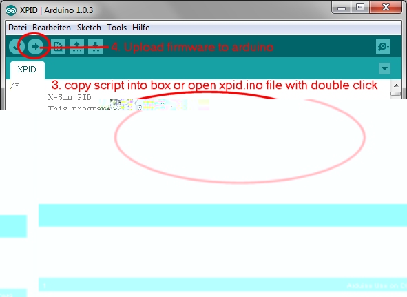

5. Open the Arduino IDE and open the x-pid.ino file

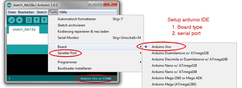

6. Setup the your connected Arduino in the IDE. Input the comport. You may try the LED blink example.
7. Upload the firmware to the arduino

Long texted: Upload of the Arduino X-PID firmware
You will need to download and install the arduino software package in order to do anything with arduino. Please go to the arduino homepage and follow the basic steps for the download and driver installation of the arduino board. After you have installed the software you need to connect the arduino and tell the windows device manager where the driver is. You will get installed a new comport in the device manager which you have to write down. After you have started the arduino software you must enter this comport number into the software and try the "blink" example out of the example menu. If the upload works and the LED is blinking you can continue here, else read the arduino homepage how to solve your problems.
Next to that you need to download the current available firmware for the arduino. This is a simple txt file but has a file extension name with .ino which is loadable into the arduino software. Simple double click this file or copy the content into the arduino text box. Now you only need to compile and upload this firmware and it will start after your upload. After it has started the motor should go to the middle position. Check if the motor is moving into the wrong direction and change the motor cables +/- to correct the motor direction. At this point the pot stop pin could get dammaged if you did not removed it like explained below.

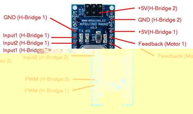

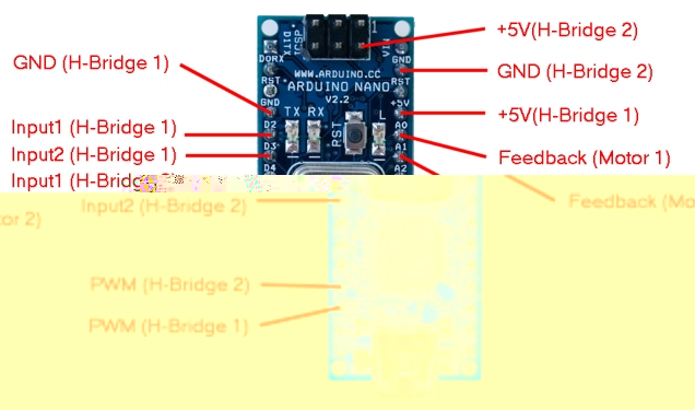

Hardware wiring:
You need to have a look into the x-pid.ino file. There you find which pin is connected to which pin of the H-Bridge, the pot and the motor. The above pictures do only give you a small imopression how the cables need to be placed but the ino file will tell you the exact position. If the motor is moving in the wrong direction or it seems to work wrong, you can simple switch the motor cables and it should work. This means you can connect the GND and 5volts of pot as you want and correct the motor connections if it was the wrong direction. If the motor control is working but in the wrong direction you can switch motor cables and pot cables or you invert the output in the X-Sim math section.

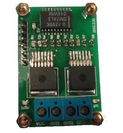

H-Bridge reqirements:
A H-Bridge is a MOSFET or transistor power amplifier for the motor. It has two pins for the direction and one pin for a enable pin. The enable pin is also often noticed as PWM input. Dual H-Bridges have of course the doubled count of this pins, for each H-Bridge the same pins. The direction pins are normally noticed as inp1 and inp2 which means input1 and 2. Pins for the error response of a H-Bridge are not used in this project. Professional developers do have to make use of them in their own setup. Do not trust the ampere number on the datasheets. The board developer of a H-Bridge use parts that are save for i.e. 45 ampers but do only solder connectors which can handle 2 ampers. For example the above H-Bridge has that most common blue screw connectors which can reach only 2 ampers. Same with the board layout and the width of copper on the board. You may need to solder the power cable directly to the board.
Arduino motor shields will only work if you change the code to the used pins, each motor shield has another pinout. Maybe some of you offer a changed motor shield code to be uploaded to the open source repository.

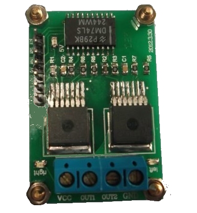

ebay 43A single bridge for one motor from china, 17$ with shipping
http://stores.ebay.de/kuyaya520?_trksid=p4340.l2563
http://stores.ebay.de/1984yht888?_trksid=p4340.l2563
