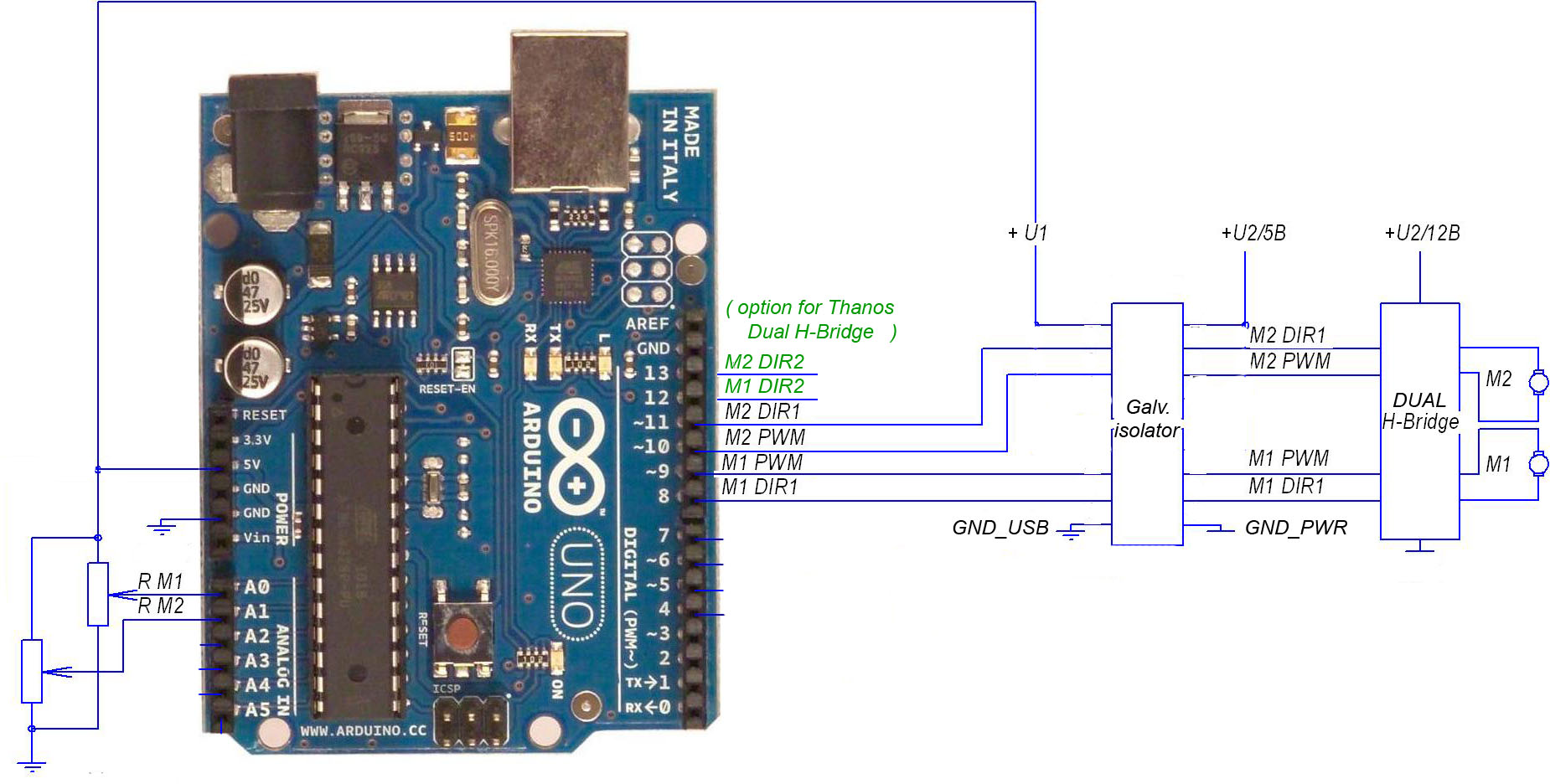

Connecting diagram

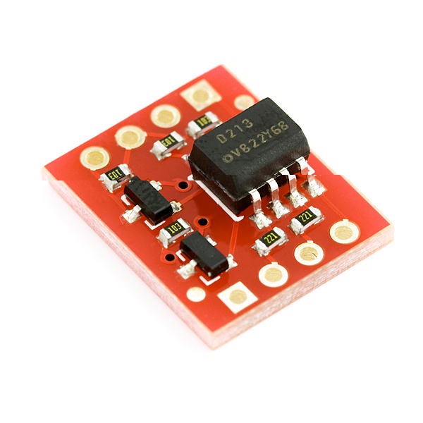

Have a good news. I found Sparkfun Opto-isolator Breakout.
https://www.sparkfun.com/products/9118
Two channel opto-isolator
Best regards,
Ale.

Postby vicpopo » Thu 10. Jan 2013, 10:13
Hi Ale,
Could you explain the point for that you named '' galvanic isolation''
It's a component ?
Thanos developed a opto isolator board , it's the same princip with same components?
Regards
Re: Arduino UNO 2dof firmware
Postby prilad » Thu 10. Jan 2013, 10:42
vicpopo wrote:Could you explain the point for that you named '' galvanic isolation''
It's a component ?
Regards
Yes. This is a board with galvanic isolations ( http://en.wikipedia.org/wiki/Galvanic_isolation ) for each control lines. It may be based on opto-isolators as 6N137 (and you can use Thanos opto isolators board). And it may be based on "transformer" isolators, like ADuM1400 (http://www.platan.ru/pdf/datasheets/analogdevices/ADuM1400_1401_1402.pdf)

BobBuilt wrote:so that i may change the pin out to suit this shield, plus having a shield that just clips on over the ard will make it alot easier for new commers to play with plus the shield is already isolated and protected, no boards inbetween.
I can to create the new version, pin-to-pin compatible to Monster Moto Shield. But you must to know that PWM1 and PWM2 on pins used by this Shield has only 8-bit resolution (instead the 10-bit on pins in current firmware). And why do you say, what this shield is "isolated" ? It's not true (as I understand from schematics).

And I say, that this board has not any isolation, only protection. But this is not the same things. The POWER GROUND on this board connected to USB GROUND. I do not like this situation.
BobBuilt wrote:Didnt realize the diff in pwm pin outs, so even if hook this up with patching wires it wont work.
Please advise I can do a test.
Now connection diagram for my firmware used another Arduino pins. And you should make RIGHT connection to your Monster Shield by wire. And then you can test it.
BobBuilt wrote:Im eager been playing with a uno for a while now, just got lost in pid control. And suppose it wont be good to derate your firmware so we can use a bought shield.
By using Arduino IDE and sketches difficult to build a high performance "real time" firmware for x-sim. (IMHO) I wrote programm on C and assembler. It is not "arduino scetch"
Thanks Ale,
I appreciate so much all your efforts to explain simply and with a lot of pedagogy all we ask you!!
Best Regards
Gilles
