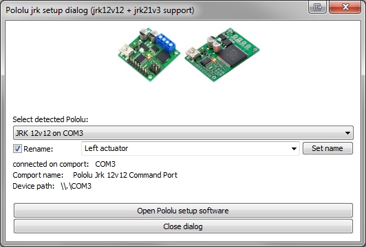

After you have extracted the plugin into the x-sim sub-directory "/Interfacesplugins" you have to remove your old pololu USO setup and have a look into the interface section.
If you double click the pololujrk Entry on the right side you will get the rename dialog.
With this dialog you can rename your difficult "JRK on Comport name" to a actuator name. To make it easy for other members you should choose the names out of the drop down box. To enable the rename function you have to set the checkbox, enter or select with the dropdown a name and press the set button. With the pololu button you open the original pololu tool which can run at the same time as x-sim do. But remember: the polling of the tool will slowdown your jrk while the pololu plugin is open.

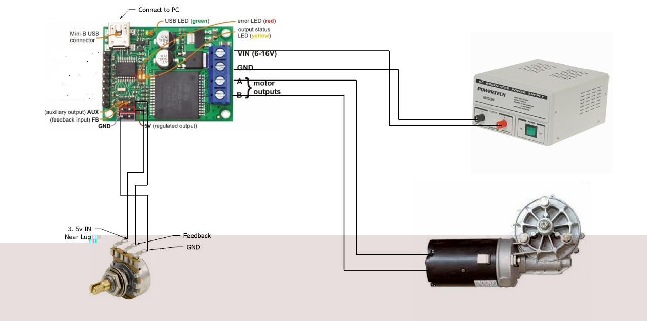

The type of PnP setup is like for the SCN5 actuators. If your feedback pot does jitter you will also have a problem to reach the new high resolution. You can watch the pot feedback jitter in the pololu tool, it must be nearly static. To reach this you need to have short pot cables and for the best solution the pololu directly near the pot. Then the 5V of USB must be jitterfree. To reach this you have to insure the mass contact of your motor is not the same as for the GND line of USB and a HUB with a additional powersupply will avoid 5V spikes with his own power supply.
