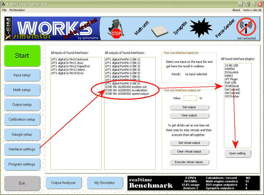

The plugin is ready usable installed in X-Sim3, you will find it if you start the X-Sim converter application and press the interface setup button. In the best case the SCN5 is completely autodetected if you have connected it to the serial port or the serial converter. The SCN will autocenter if you open the converter and will then be displayed in the interface setup. If it is not displayed you did something wrong and you have to read this thread carefully.

After you have started the X-Sim converter application there should be a SCN5 listed in the interface setup -> output table.
If not: check your hardware, visit the hardware thread, ask there your questions!
Now select in the plugin table the SCN5Serial entry and press the "Open setting" button.

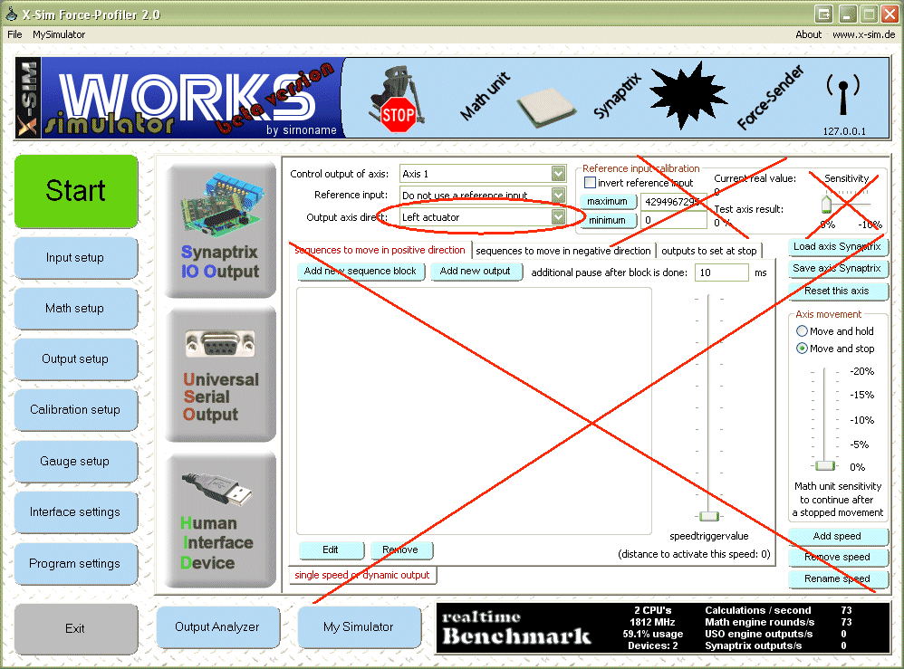

8. go to ouput setup and to Synaptrix IO
7. choose axis and a SCN5 as direct output
9. press the start button

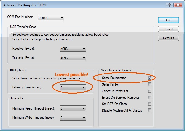

Download the latest drivers for that chip from the internet that is used in your adapter. This might be a FTDI chip or a profilic chip. Both need the latest drivers, FTDI have to change the standard response speed to "1" and the printer support must be enabled in the advanced driver setup (device manager->comport xy->advanced).
Go to the hardware thread and compare the five point compare list, if your adapter fullfill the needs and the setup would be correct to reduce the possible combinations of errors you could have with the plugin.

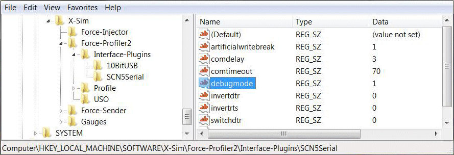

Open registry editor and go to
HotkeyLocalMachine/Software/X-Sim/Force-Profiler2/Interface-Plugins/SCN5Serial
(64bit Windows: HKLM/SOFTWARE/Wow6432Node/X-Sim/Force-Profiler2/Interface-Plugins/SCN5Serial)
and make a Reg_SZ value with value 1. (0 to disable it again)
After this you will be noticed step by step about every comport detection with a message box.

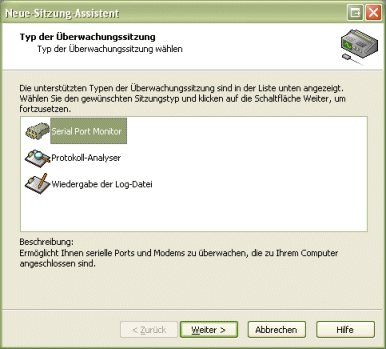

You can also compare the serial connection with the "free serial monitor".
http://www.serial-port-monitor.com/
If here comes no response you have to got to the hardware thread!
You can see highlighted the response of a SCN5 actuator. If the receiving area is blank, you do not get any response. If there are the same lines as in the sending box, your RS485 converter produce echos which are not aczeptable for this plugin (timing). A echo you can see if there are some lines equal to the sended lines, this is not possible. (compare full line)
Make screenshots or copy paste the box in a text file to post it here.

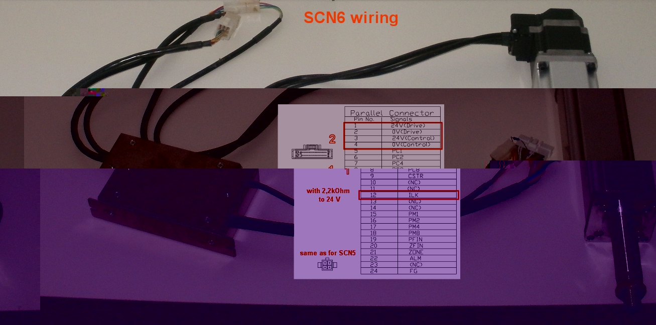

Added SCN6 wiring informations.
Do work great with that new SCN6 devices :)

enable the debug mode and tell me which are the last messages ...

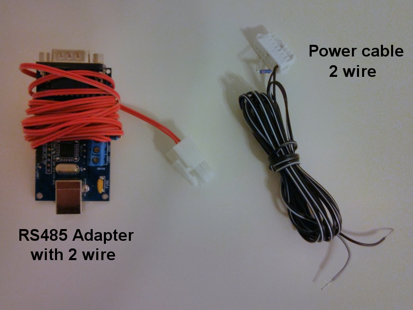

how to reach the debug mode and i read on this thread that i should wire only two cables unstead of three in the actuator is that ok ?

For debug mode: read the first post, with pictures!
For wiring: yes, if the adapter need 5V and GND from SCN5 it is 4 wire
