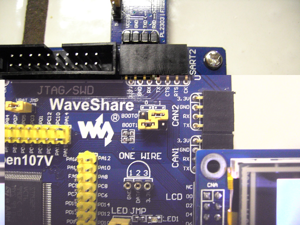

First you have to connect the USB-Serial module that comes with the board, to the USART2 Port. This is the communication port that the bootloader is using.
Then you have to place the BOOT0 jumper in position 1

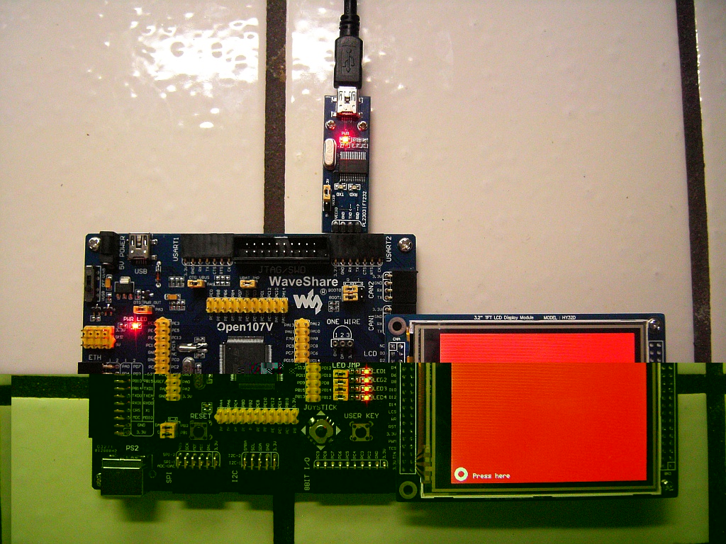

Then unplug the USB cable and plug it back again. The LCD screen should be white *

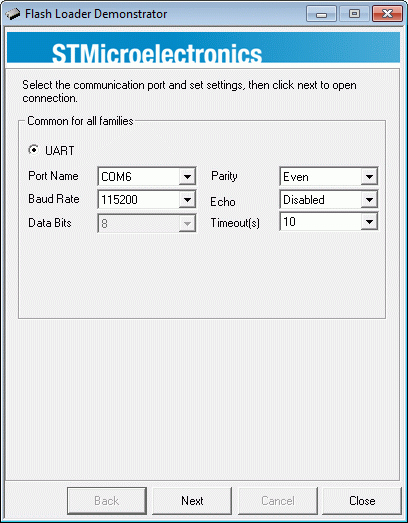

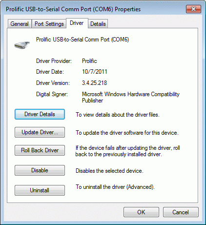

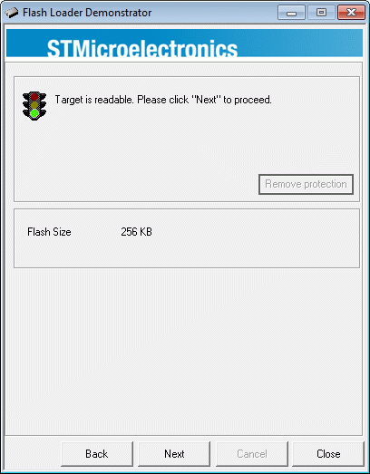

Then follow the next steps, with the first step being to make sure you have the correct USB-serial driver up to date.

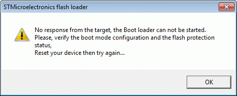

If you get the following message, press the reset button on the open107v and try again.

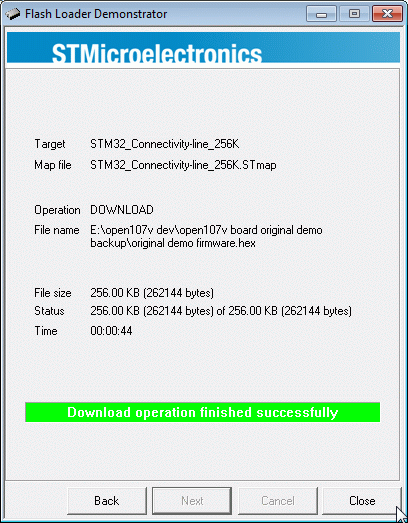

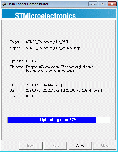

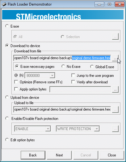

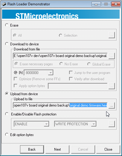

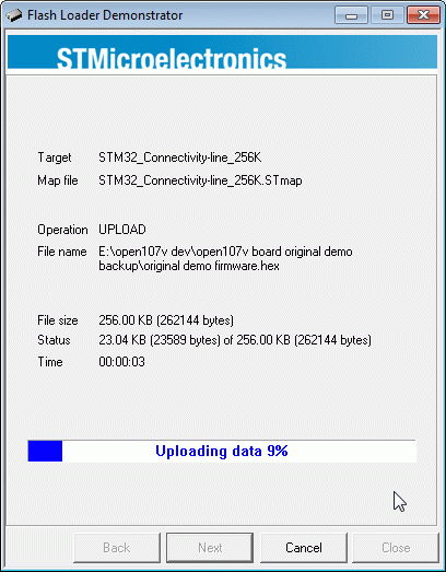

Choose "upload from device" and select a name for the existing firmware backup.
If the above steps where successful then you can try downloading back to device the firmware you just created for backup. The same procedure will be used for uploading new firmwares for motion control.

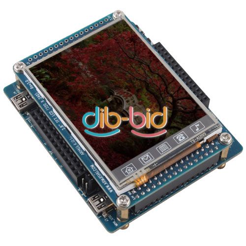

Then, once you've got your code released, we'll be able to choose from a variety of cheaper STM32 boards containing only the functionality your code requires. Here's one I ordered a while ago for only $25 shipped!
http://www.ebay.com/itm/STM32F103RBT6-Development-Board-W-2-8-TFT-Module-True-Color-Touch-Screen-Panel-/170782669105?ssPageName=ADME:L:OC:CA:3160
I'm not suggesting we all go out and buy a STM32 (no, no...don't do that yet :) I did only because I've got my own stuff going on here.
