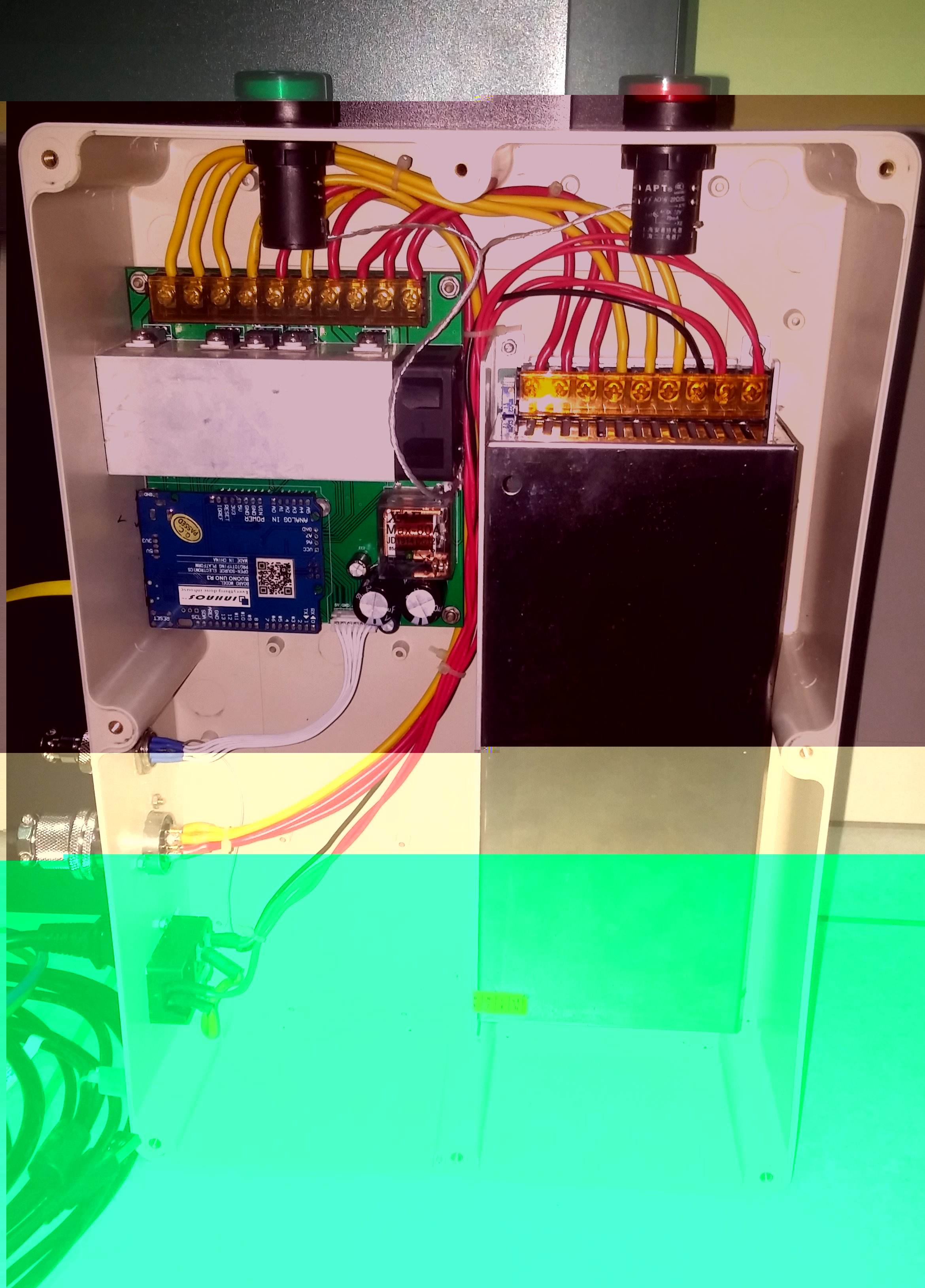

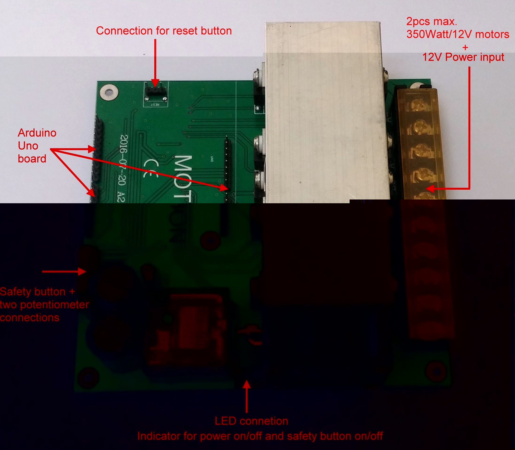

I would like to show you my new finished project of an Motor driver for my 2dof.
Specifications:
Supports two motors max. 350Watt/12V.
Connection to Arduino UNO board.
Connection for two Indicator LED`s.
Connection for two potentiometers.
Connetion for safety button.
Reset Switch connection.
Including a cooler fan and a big heatsink
The Motor driver have build in safety power off if the temperature goes over then 65°C.
After my tests with two 160Watt/12V motors the temperature is not higher then 46°C.
The cooler fan goes on when the temperature reach about 40°C.
If you are interested in it so just let me *
Check the pictures.

Postby Greg1976 » Sat 17. Sep 2016, 08:53
Just can use with 12V. The Price for this board is 74,-Euro Net. But sorry guys I got the information from Administrator it is prohibited on this website to offer spare parts for your projects.
