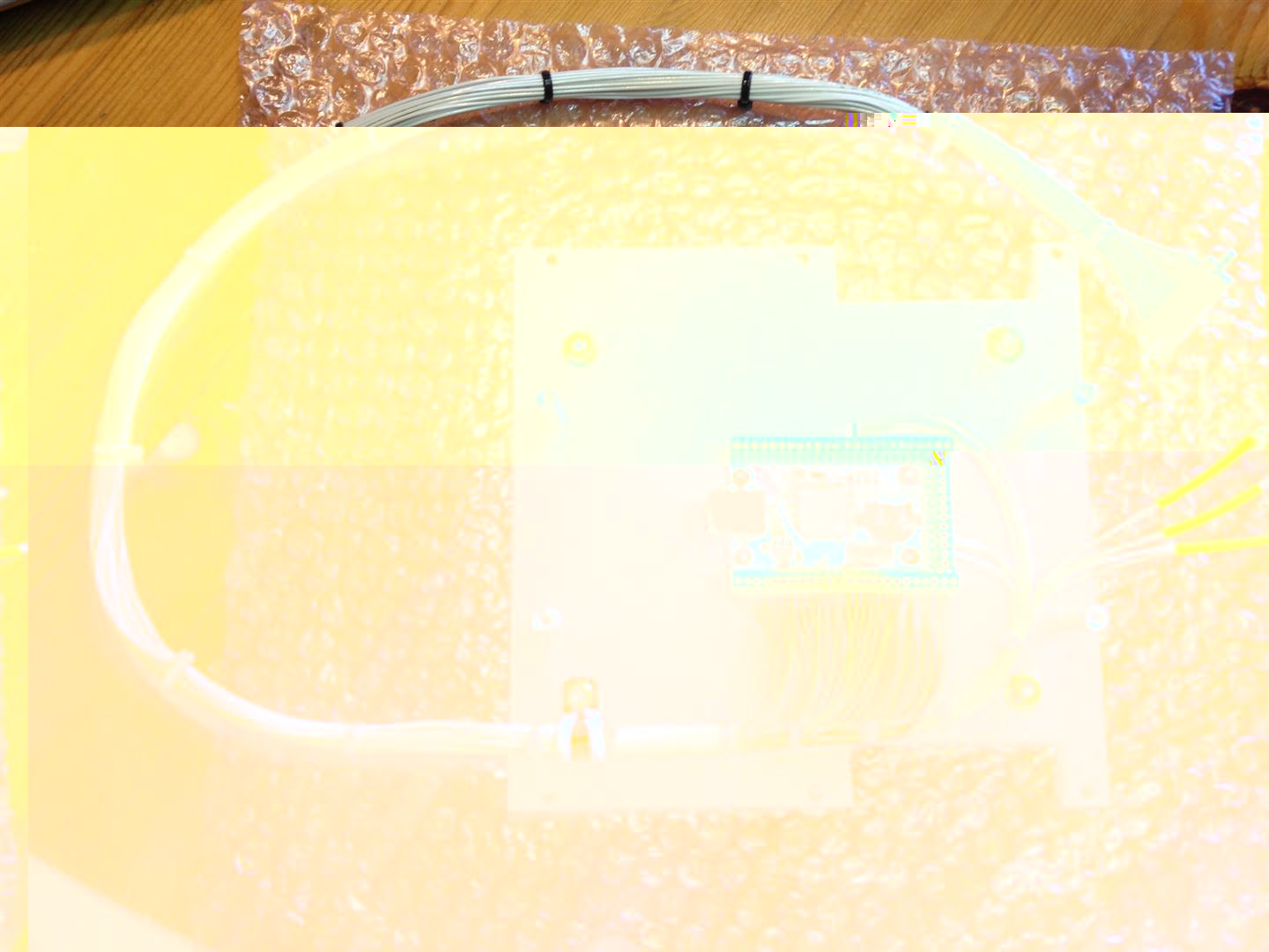

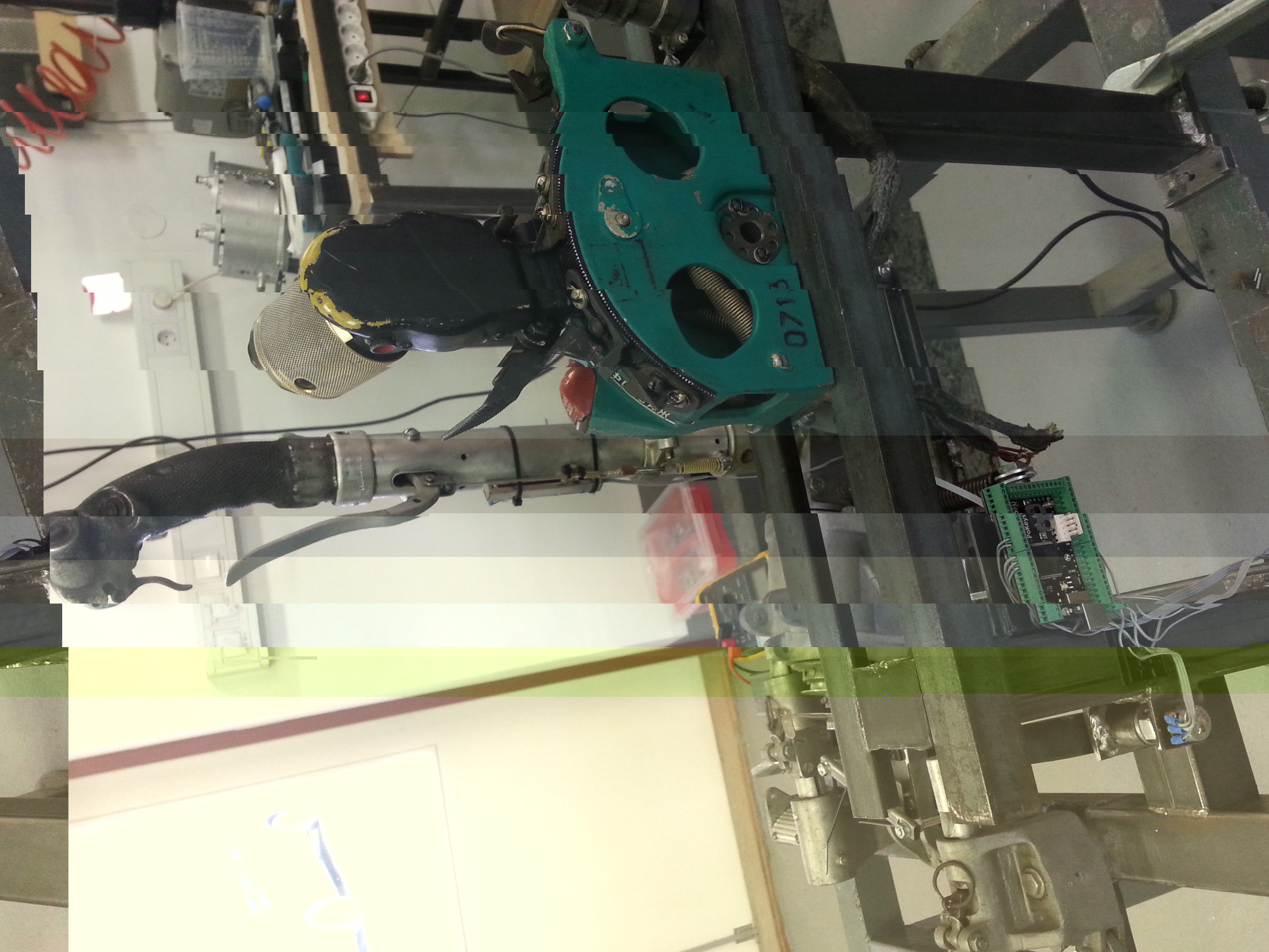

I attached some images. There are rudder pedals where you can see two pots. One is for rudder amd the oter is roll. Both are connected directly to PoKeys.
Next one is throttle and below you can see pokeys with all connections. This simulator is still work in progress and it will be available for public in september. Then I will be able to post better images and videos to show you the full picture of what we made.

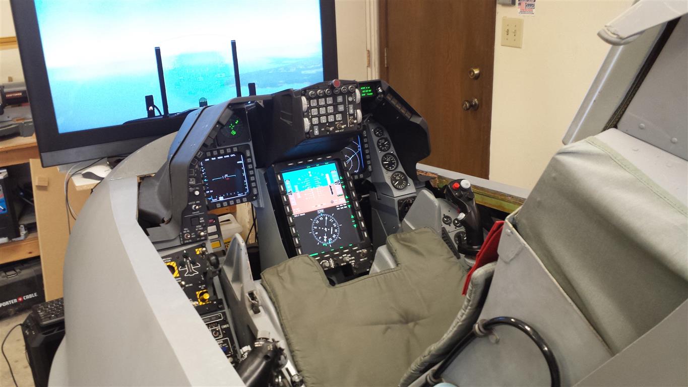

hi there awesome looking cockpit well done i will be looking for a hi end card to move my full size ka 50 helicopter cockpit i built a year ago ,lots of cards out there so i got lots of reading to do so not to make the wrong choice
Thanks Tony
