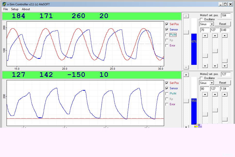

The main window is shown in Fig.
xSimCTRL main screen
In fact the appointment of government is clear from their names. In the menu "Settings" to configure the COM port settings - 115200, 8, 1, no parity.
Managing a graphical representation
When pressed RMB (right mouse button) is a graphic image shift. When pressed LMB - scaling. At the same time to zoom down the need for coatings to hold the mouse left to right.
The data, trapped in ZoomBox «thrown open" to all of the window. If you hold down LMB to hold the cursor right to left, then the graph returns to its original scale.
In addition to scaling the image, you can use the mouse wheel.
