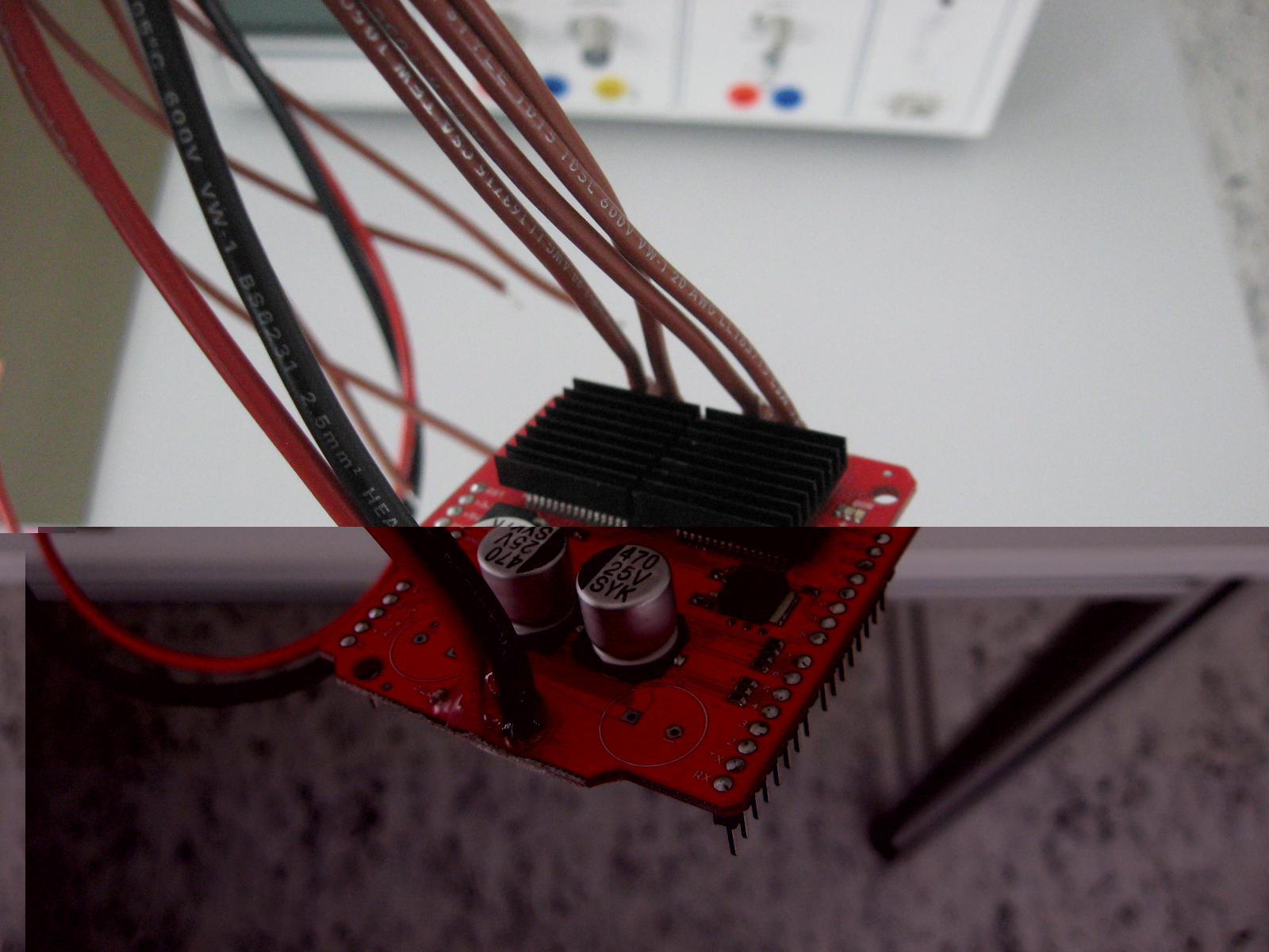

The Moto Monster is a SMD chip based controller board, controlling two DC motors (wiper motors), for the arduino UNO board of any revision. However some arduino boards have more pins than the moto monster have. Be carefull by connecting the board to such boards and have a look to the names of the pins on the arduino and the moto monster. The moto monster comes with the mounted board and some header pins. You have to solder yourself the header pins to the board. Because of some mechanical problems you should read the below hints to avoid electrical shorts. The cables are also not connected to the board. Insure you use thick cables because of the big power (30 Amperes). If you use small cables (that have not the diametre of the moto monster board holes, you get warm cables and the power to the motor can be limited or reduced. The cables MUST be as short as possible from battery to the moto monster shield, and from the moto monster to the engines. Do not combine USB cables and the power cables, they should be positioned away from each other. For higher power you should search for an optical/galvanic board to avoid power over the mass.
Only 14 Amperes are not much and the limit for DC wiper engines. A wiper engine takes about 2 Amperes only for moving without load. So the maximum power can be 12 Amperes at 12 Volts = 144 Watts. Around 150 Watts are recommended as minimum for a 2DOF wiper simulator where only the racing chair is moving. You must use a multimeter and check your DC motor connected to a battery before you connect it to the Moto Monster shield. Check the maximum amperes that can be reached with equal motor load. More amperes than two needs a bigger heatsink connected to the chips of the moto monster. The following heatsink are requiried for a test without load and a maximum of 2 amperes.

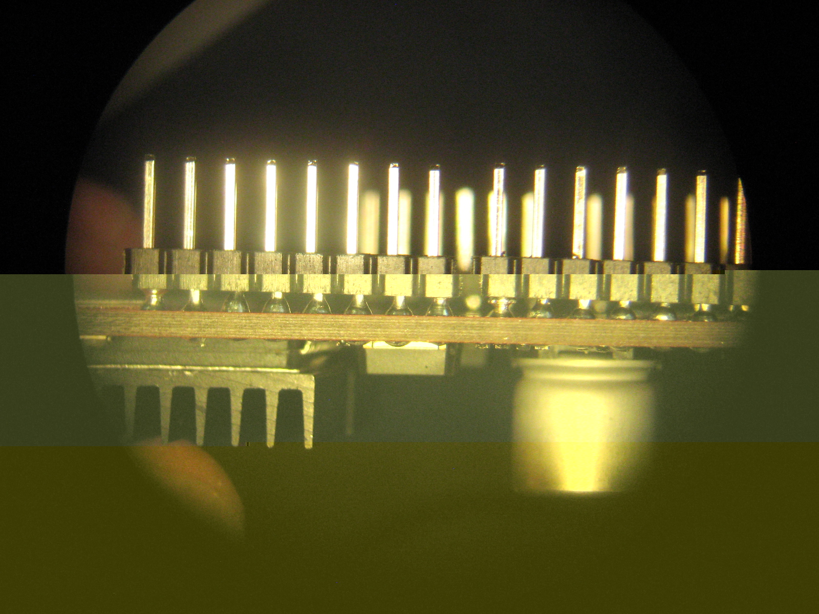

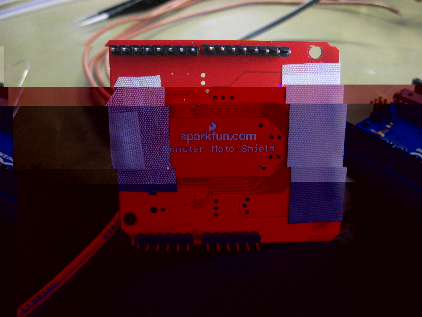

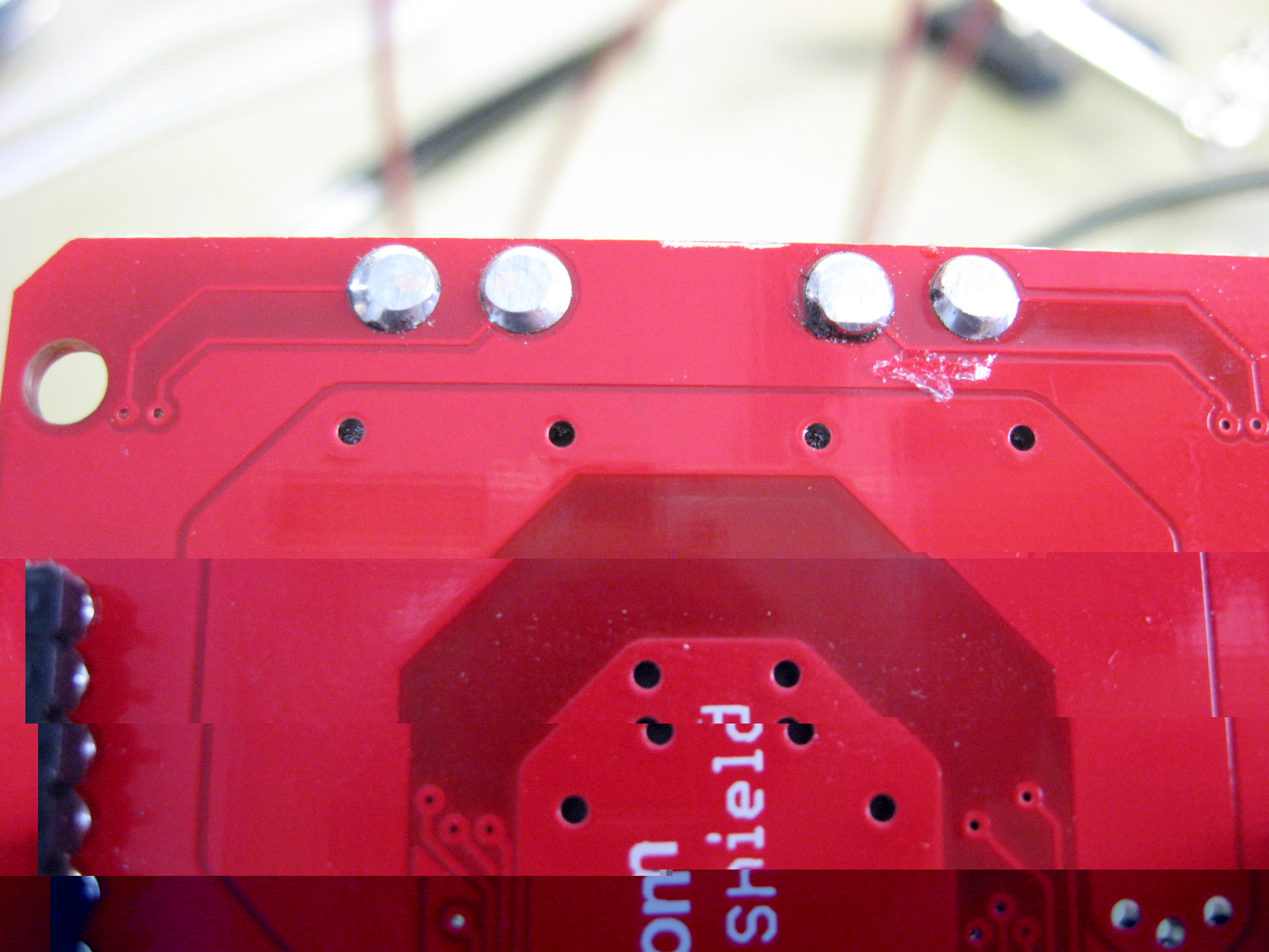

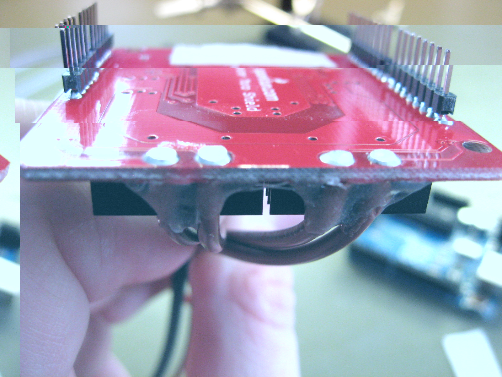

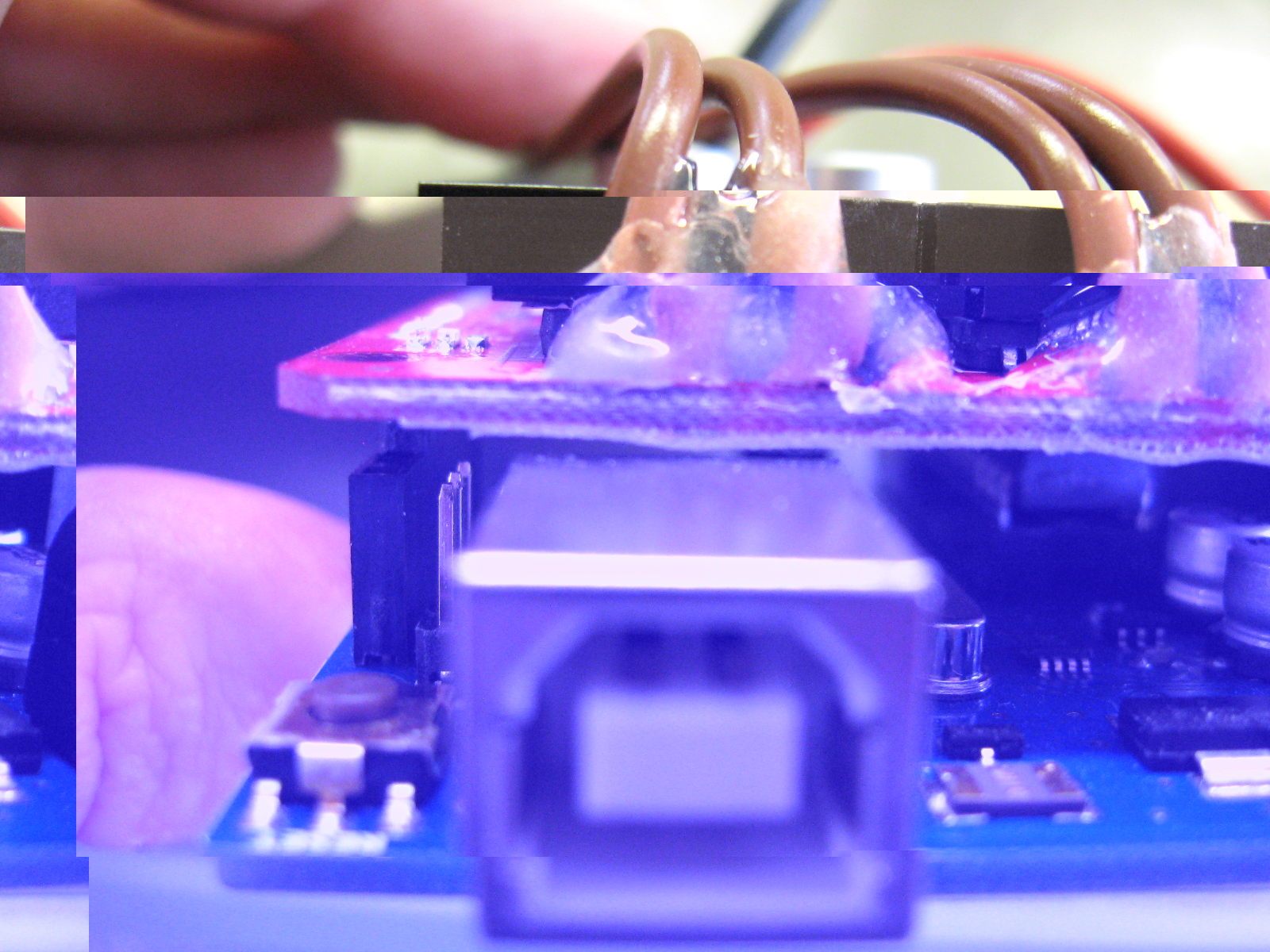

Soldering:
The following hint will increase the distance to the critical mechanical positions.
Moto Monster soldering
This is a preperation for a machanical short:
Be carefull with using this bridge. Because it has limited power you must assemble it without load, check the heatsink. Then assemble the DC motor to the simulator and check the heatsink again. After this you can try some minutes a ride but then check the heatsink again. Use a fan if it is getting hotter than 50°C, this means you cannot touch the heatsink anymore.

   Use a heatsink on the VNH2SP30 chips on the motor monster shield. Maybe a fan is additionally attached.
