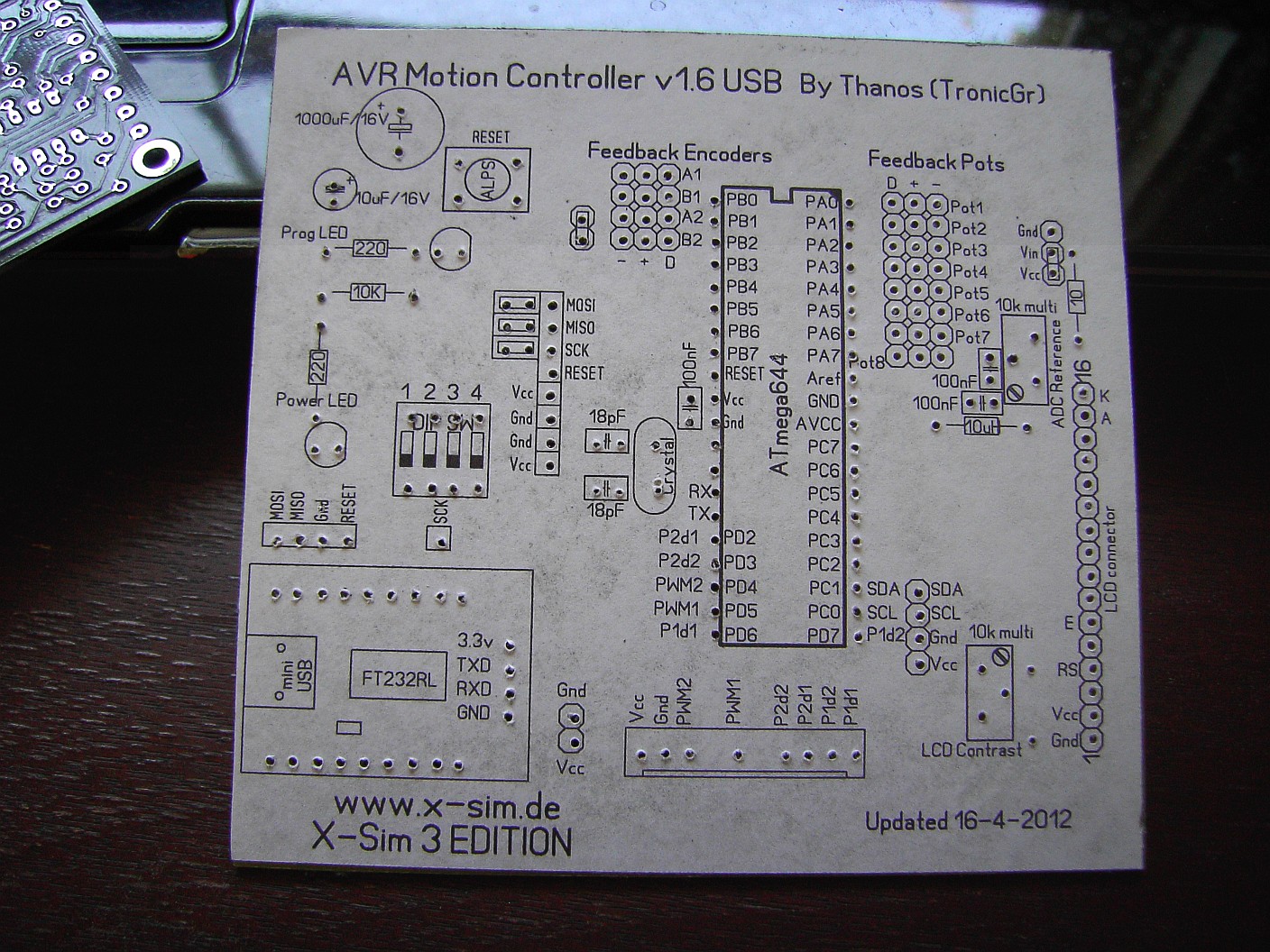

Note: For my private development AMC1280USB 6DOF controller contact me at my email: tronickod@yahoo.com

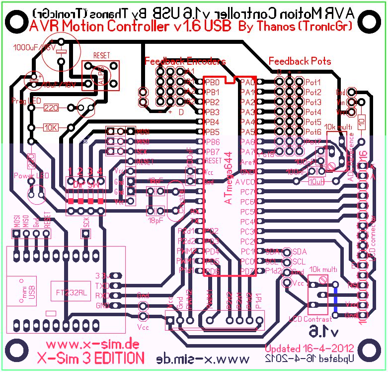

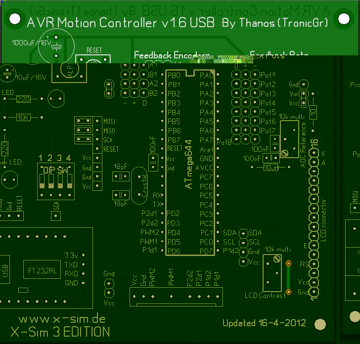

AMC1.6 2DOF DC motor controller:
This is the next generation of my AMC motion controller. It was long time ago that I published my first version, that went through lots of revisions and fixes all this time. This new version is all easy to make and use.
I decided to go USB all the way that means that except from using usb for communications I also use it in this board for providing power and self-programming. No need for power supplies and power regulators anymore. No need for external programming circuits, no need for Ponyprog or anything. A few jumper cables and a few clicks and you are ready to go in seconds.
Here is a short list of the new features (to be expanded):
1. I'm using Atmega644 MCU running at 18.432Mhz. Older chips are going obsolete so why bother with them?
2. a. Sparkfun FTDI USB module for serial communications @ 115kbps.
    b. +5V power over the USB module. No more external power supplies.
    c. FTISP (FTDI In System Programmer) provided by the USB module. This solves the chicken and egg problem :)
3. The LCD is attached on the main board directly. Added trim potentiometer for LCD Contrast.
4. Except of using just potentiometers for feedback, quadrature encoders will be available in firmware update really soon.

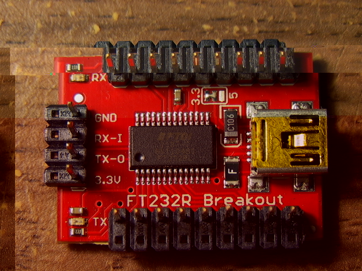

The USB board I used is from Sparkfun:
Breakout Board for FT232RL USB to Serial
But I lately noticed cheap knock-offs on ebay:
FT232RL USB to Serial Module USB to TTL level for Arduino 2560 UNO R3 ARM A033
The USB interface is based on a FT232R chip from FTDI (http://www.ftdichip.com). This chip's primary function is to act as a USB->Serial converter, allowing the user to get serial data without requiring a standard RS-232 serial port. The USB interface can also be used to reprogram the firmware in the AVR processor using a special utility, ftisp. No USB programming knowledge is necessary to use the USB port.
The USB programmer works on the bit-banging principle. It uses some of the ports of the FT232RL chip to send the proper SPI programming commands. The firmware that is carrying the x-sim3 logo is included in the following files:

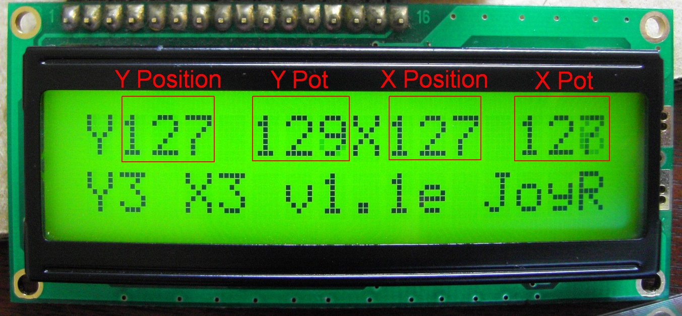

What are the numbers on screen mean?

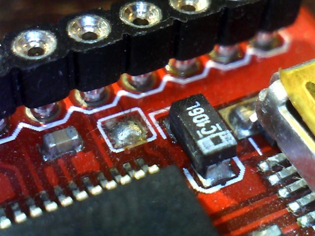

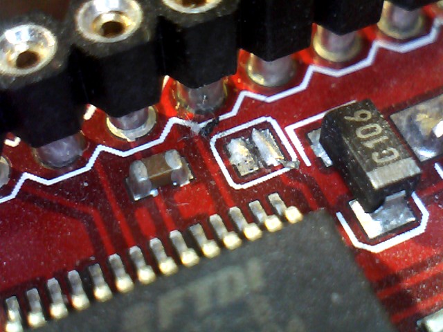

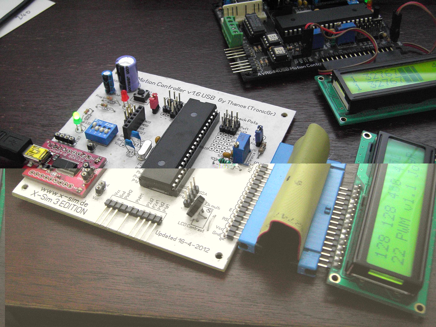

In these photos you can see how I attached the USB module on the old board (AMC1.5) to test it.
And here is a example video of the USB programming procedure:
Also one more thing you have to take care is to the remove the little short jumper on the sparkfun board that ties the VCCIO voltage to 3.3v. This is needed as on the AMC1.6 board I tie the VCCIO voltage to 5V !!! Its really important to do that!! Here is some photos where is it:
OR if you have the most recent version of sparkfun's board just unsolder the pad that is named "3.3" and solder the "5" one!

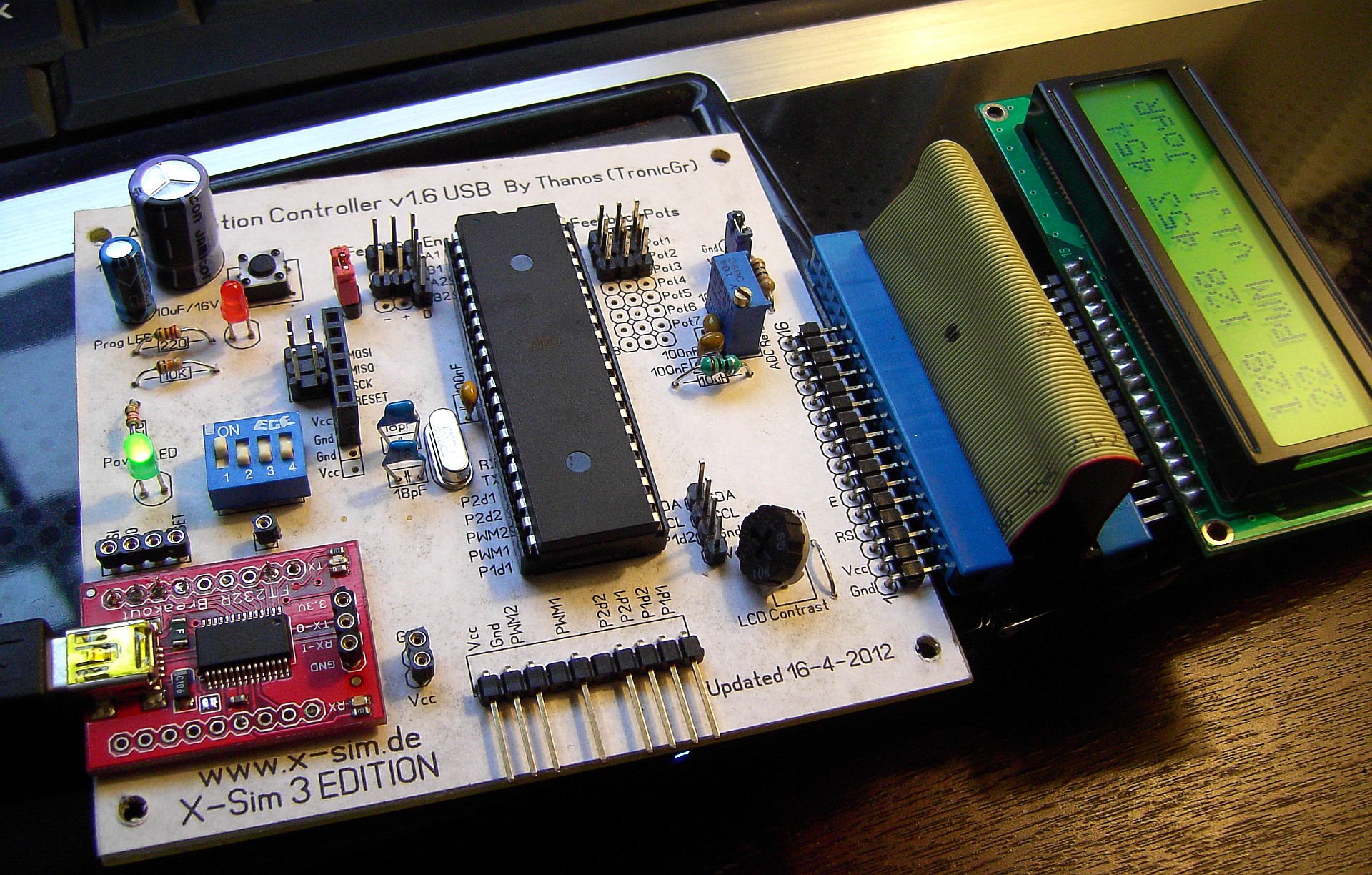

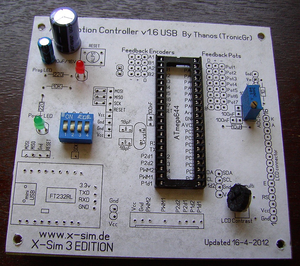

Assembly of an actual AMC1.6 board:

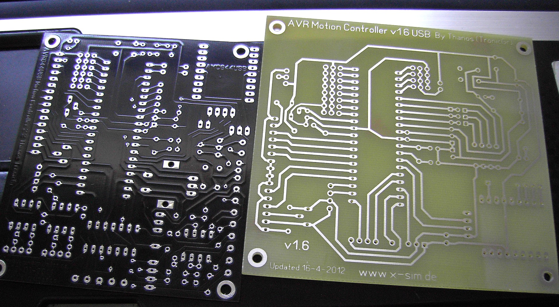

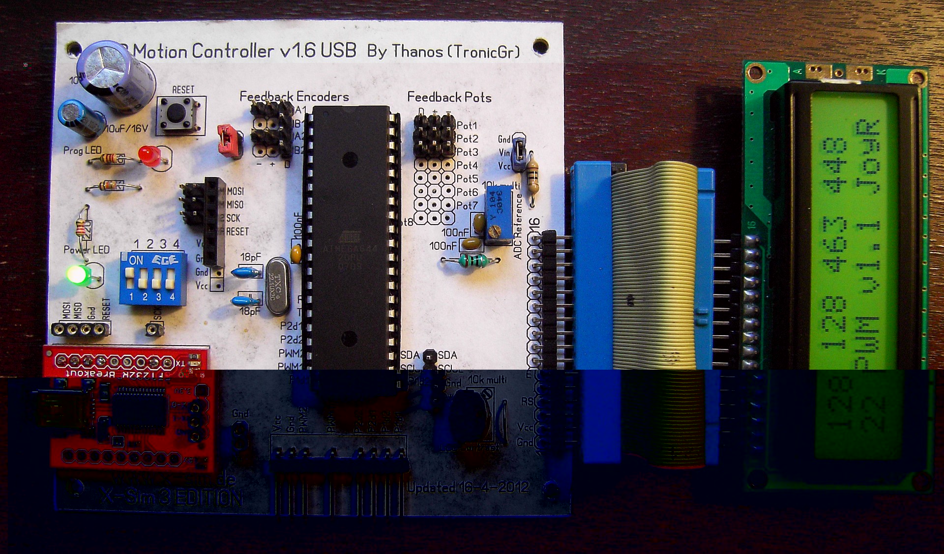

I finally received a PCB for this AMC1.6 project which was donated by Gilles (France) which I would like to thank very much!
The quality of the PCB is not the best around but it works, I guess I got too much spoiled by the excellent quality of my AMC644USB pcb's last year.
There is no silkscreen on the top of the board and it looks kinda empty with the long distances between the parts, so I decided to mount a silkscreen on the board using a printout on normal paper and glue it on the board using rubber cement. Worked just fine!! No wrinkles or mess as anyone would think!
So in less that 2 hours I had this assembled and programmed. All is working as expected!
So this is my "WHITE" version I guess, after choosing to make my other board AMC644USB all "BLACK" :lol:

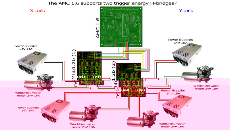

I have good news, it is with great joy that I announce that I will build an AMC 1.6. :-D :-D :-D :-D
I have a doubt, I can fit 2 h bridges on my AMC 1.6 project under this scheme:

@ Tonquites
Yes. It just splits the signals to the two pairs of h-bridges. I don't see why its not going to work.
