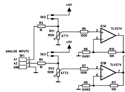

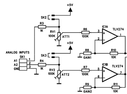

Postby sirnoname » Fri 16. Aug 2013, 12:38
As written it is mounted twice to all velleman boards without the second pot.
Here is the schematics
Re: How to: connect pot and HALL effect pots
Postby eldeejay » Fri 16. Aug 2013, 14:46
I finished the test and I will present my results. First I apologize for my doubts prior to this publication, (sorry and thanks Martin ;) ).
However, the scheme published by Sirnoname works perfectly, but it is important to know that the resulting output of this configuration is INVERTED. The configuration of this opamp is "inverter amplier" therefore Vo = ~Vin (inverted Vin).
If you already have your operating platform and install this circuit should consider this:
To insert this circuit, the motor will rotate on the oposite direction, the solution is to reverse the motor wires.
I recommend using this solution, authored by sirnoname
_____________________________________________________________________________________________________________________________________
Velleman scheme uses a opamp in configuration "noninverting amplifier". When setting the offset pot scheme would remain so:
1987
This configuration is not suitable for the needs of the project as opamp output it never becomes 0v because will always exist minimum input voltage, for example, I use a magnetic sensor whose output ranges from 0.5 to 4.5 volt, so in the minimum position will always exist at least 0.5 volts; and 0.5 volts Vout will always be minimal opamp Vout.
Do not use this setup.
