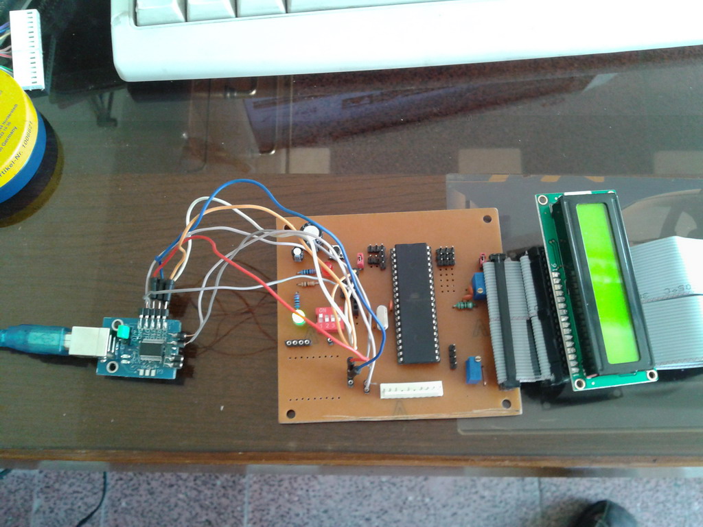

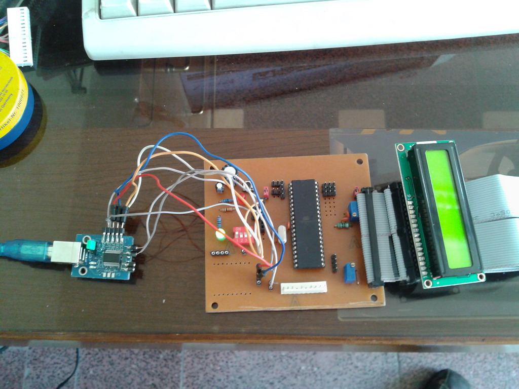

Postby hooshang » Mon 13. Aug 2012, 15:43
hi Thanos and freinds
here is my "Thanos AMC1.6" board
as you see cause i couldnt find exactly the same break out board localy
i am using the same product but i just try to connect every each
connection as you did,finally when i connect the USB, LCD is on but i still dont have those nice black aquares
so where is my problem or mistake.
sorry for english
thank you
Hooshang
