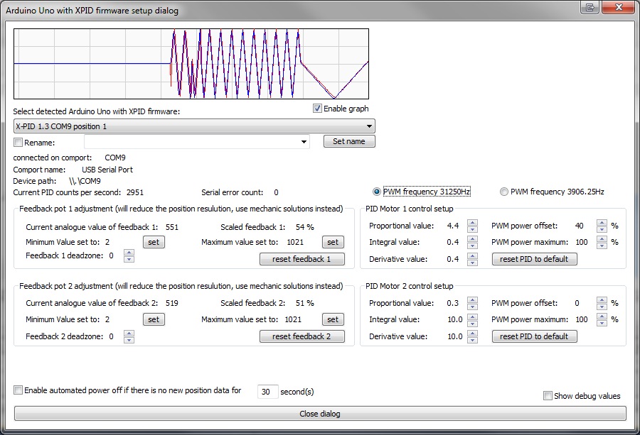

Postby sirnoname » Sat 23. Feb 2013, 01:44
Update: added pwm offset (the voltage where the motors are beginning to work) and pwm maximum (to reduce power of motor id one is faster than the second one).
Also included a selectable PWM frequency.
The result is awsome. Small changes will now be moving the motor and the input glued to the result. The quality is good now and the design very sensitiv to changes. The pwm frequency seemed to be wrong implemented before and do now more noise.
