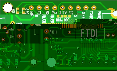

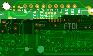

files for the FTDI232RL serial UART converter for DIY here
C1, C2, silkscreen layers pdf files here
FT232RL.rar
(92.45 KiB) Downloaded 1030 times

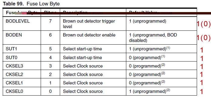

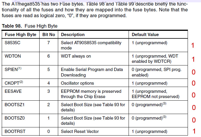

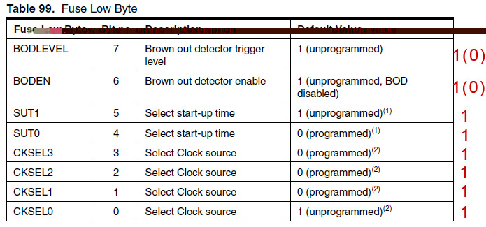

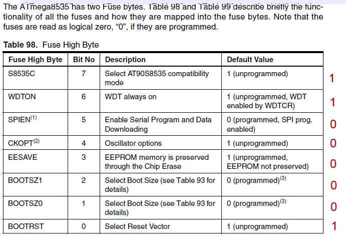

There is the table from atmega8535 datasheet with High byte of fuse. In the right of the table I draw my fuse setting. In binary this is = 1100 0001, and in Hex = 0xC1
atmega8535 fuses - high byte
There is the table from atmega8535 datasheet with Low byte of fuse. In the right of the table I draw my fuse setting. In binary this is = 1111 1111, and in Hex = 0xFF.
But I recommend to program two additional bits - BODEN and BODLEVEL. In this case in binary this is = 0011 1111, and in Hex = 0x3F.
atmega8535 fuses - low byte
It's information for the people, who write programm to atmega using PonyProg and Hex files. I draw your attention that for fuses '0' mean 'Programming' and '1' mean 'Unprogramming'
regards,
