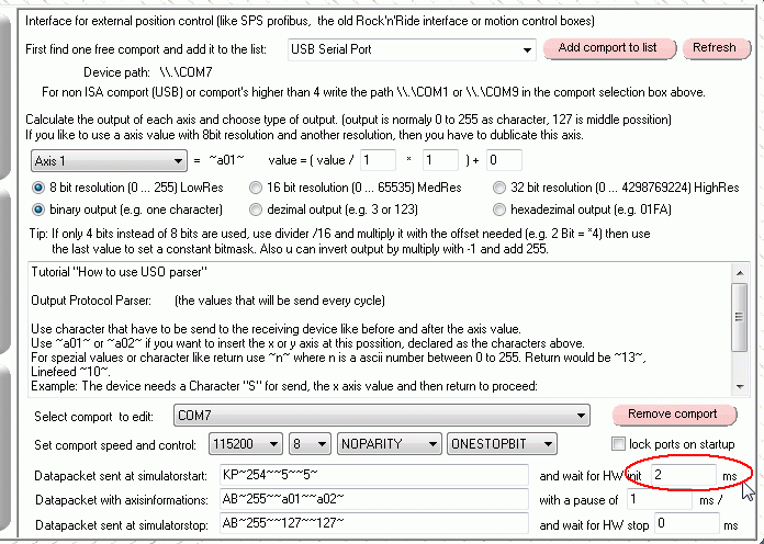

I just checked it and it does saves it into memory. The minimum value for KP is 3 and the maximum is 60.
One thing you have to make sure is that you have the correct delays in the USO screen!!! LOOK the red circled value !!! Did you use it?
When you are using hall-effect sensors (ecpecialy the SS495) you have to watch out not to physically exceed the angle limits of +180 degrees, If you do the output signal inverts to -180 degrees ...!!! So you see the motor is doing a full rotation trying to get again close to +180 degrees!! Use less driving range to avoid that. I think I demonstrated that in my hall-effect calibration video: http://motionsim.blogspot.com/2012/06/ss490-ratiometric-hall-effect-sensors.html. Watch the video at minute 6:00 and after... ;)
