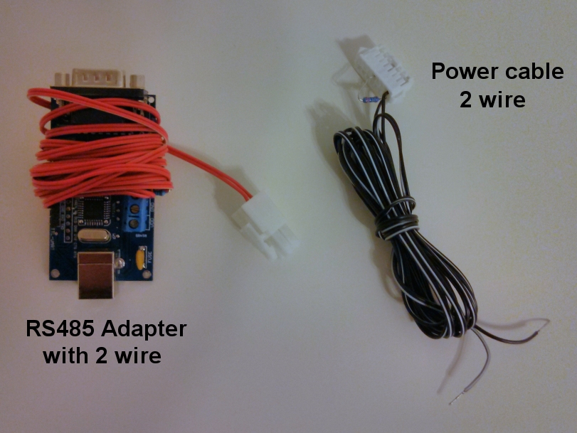

If you like I can send you two of the community cables with adapter for a test?
Or you simple buy at ebey the blue adapter ones that are in that cable set.

Wich blue one link please

Postby sirnoname » Sun 3. Nov 2013, 20:32
viewtopic.php?f=7&t=1075
viewtopic.php?p=255#p255
And of course: first post of this thread ...
