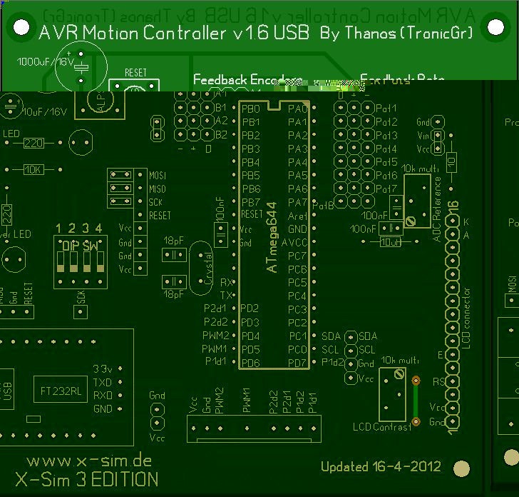

My board is like this with 22.118MHZ quartz and ATMEAG8535 and a DIY FTDI232RL [only made the board layout and attached the blank IC to it with the output pins] I can send you the layout of it if you like ... other components exactly like this photo .
yes it has a DIP-Switchs that connects PB4,5,6,7 to the ground,
