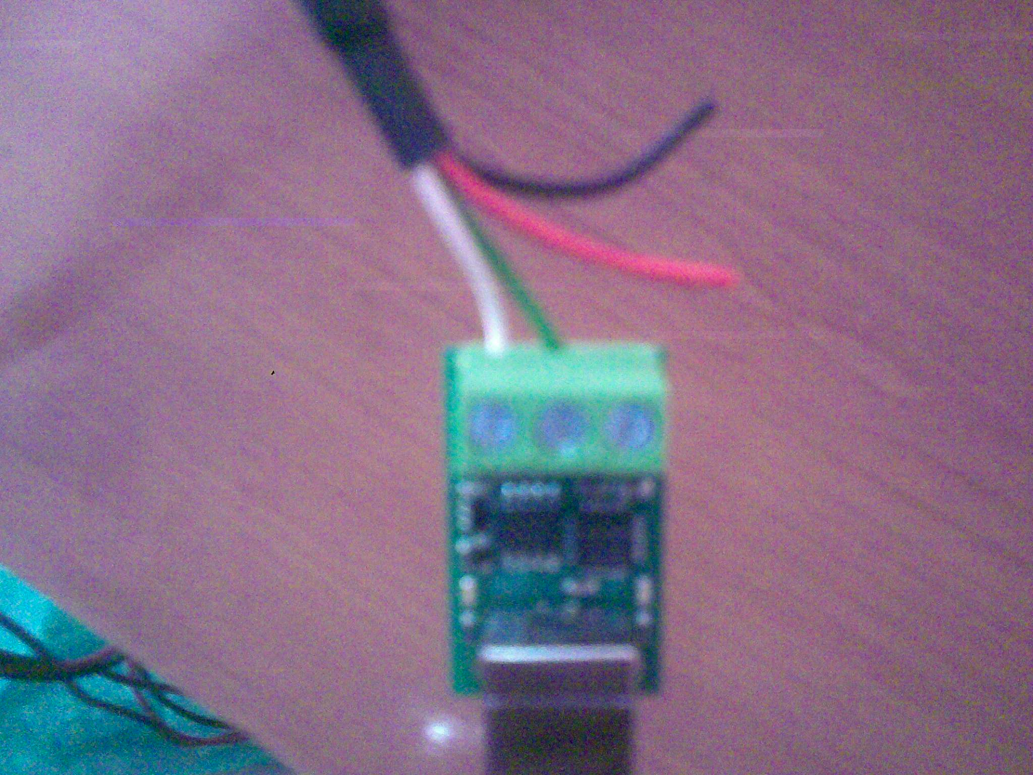

Postby mino74 » Sun 3. Nov 2013, 16:07
hi
where should i connect the 120ohm resistor ?
on the electrical wiring or usb -rs485 , ?

Re: SCN5 / SCN6 Software Thread
Postby sirnoname » Sun 3. Nov 2013, 16:27
do i have to write something here befor searching snc5 ?
No
Your adapters are idiot save, Mirai do deliver normally in standard setup.
The resistor comes in RS485 wires from green to white, but you cable is short, you do not need this.
Try now this dialog:
download/file.php?id=112&mode=view/electorinterfacesetting.gif
and set switching time to 10,receive delay 5 and switching timeout to 100.

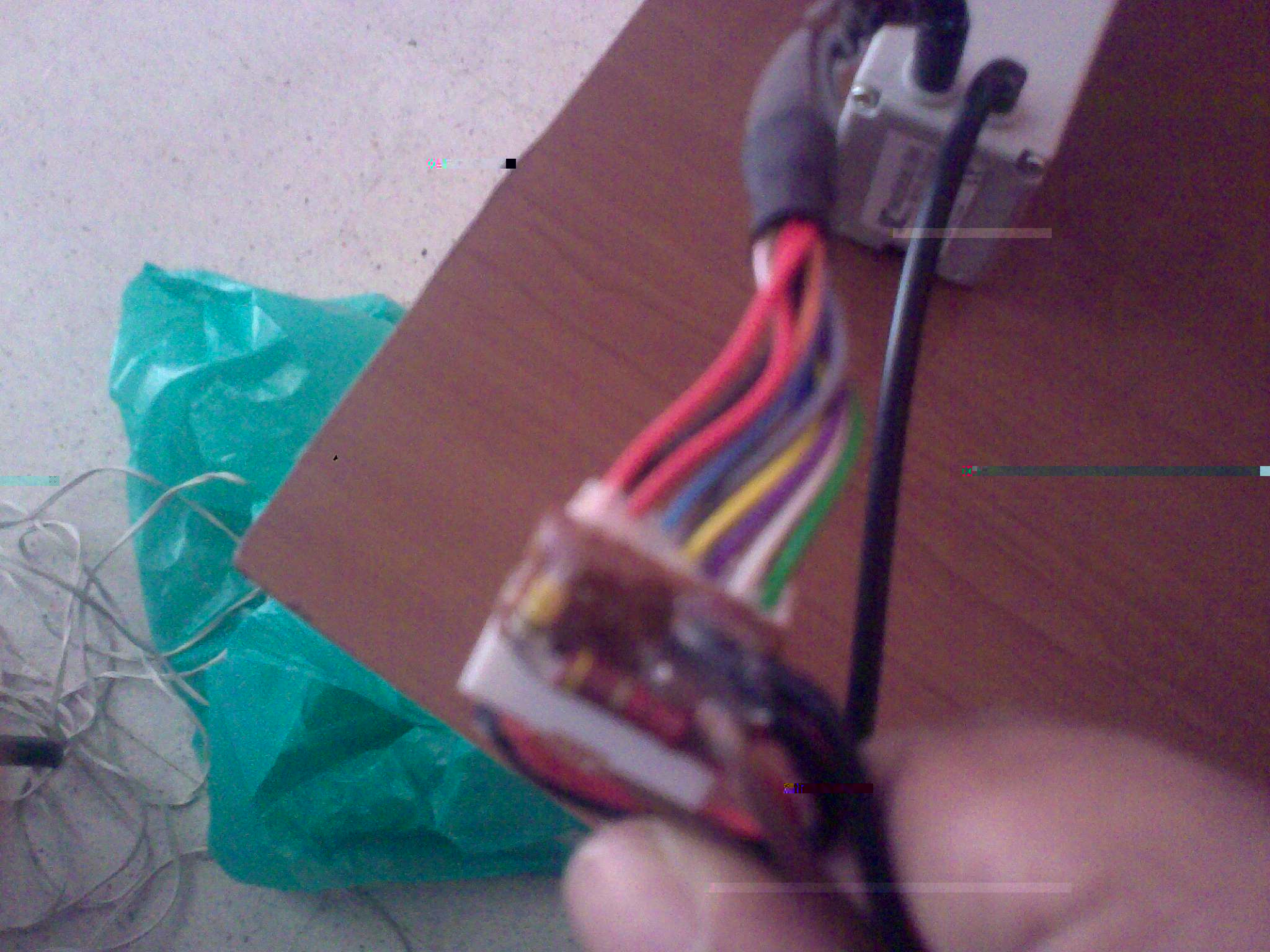

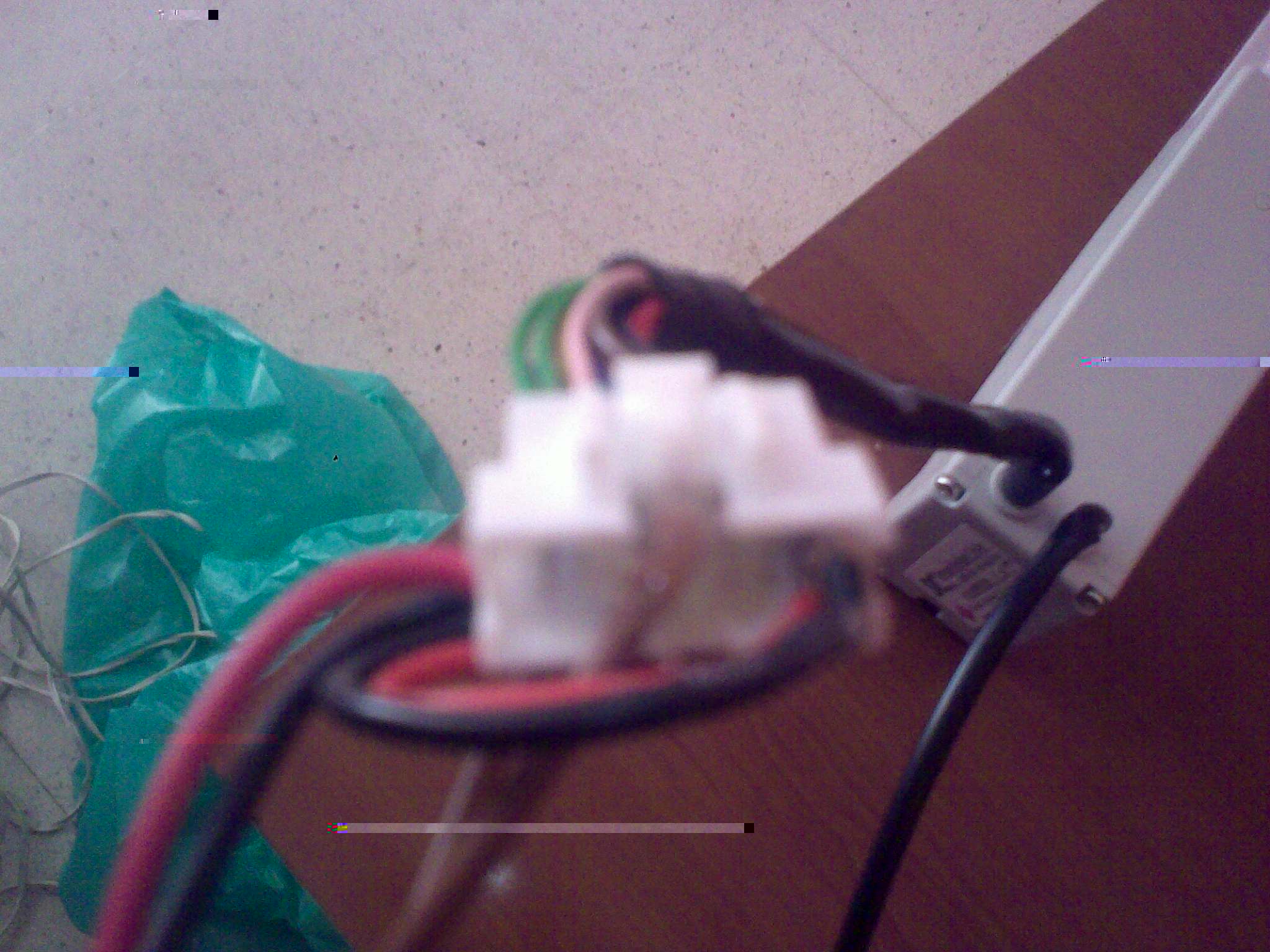

Postby mino74 » Sun 3. Nov 2013, 17:40
Doc16.docx
(573.34 KiB) Downloaded 1920 times
HI is that ok ? see the picture
